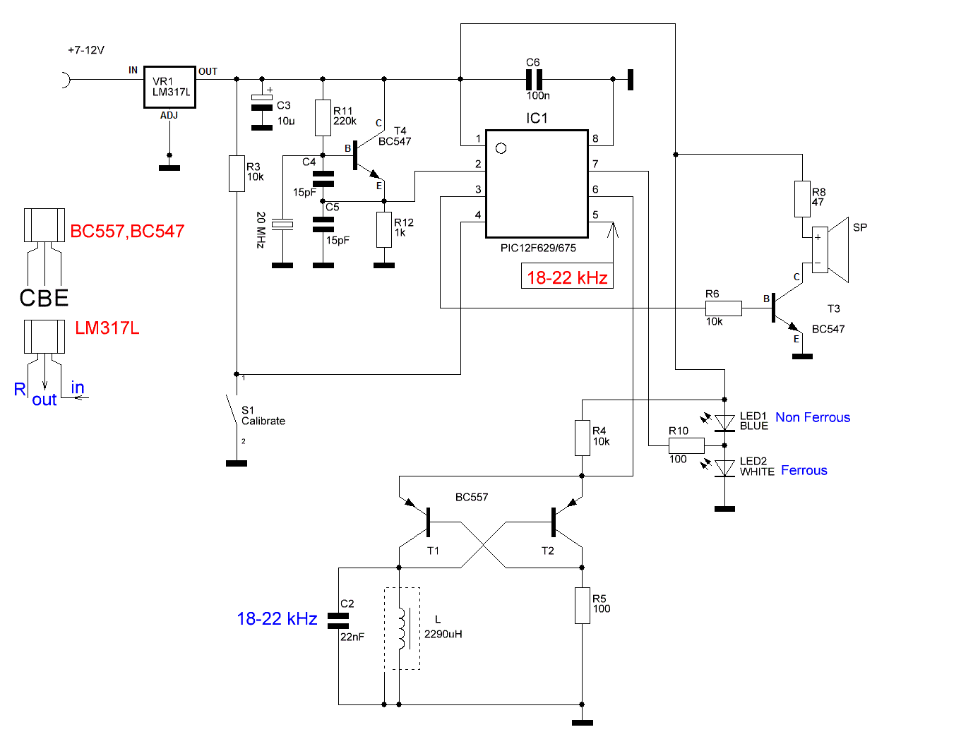

    THIS Schematic wORKING oR nOT

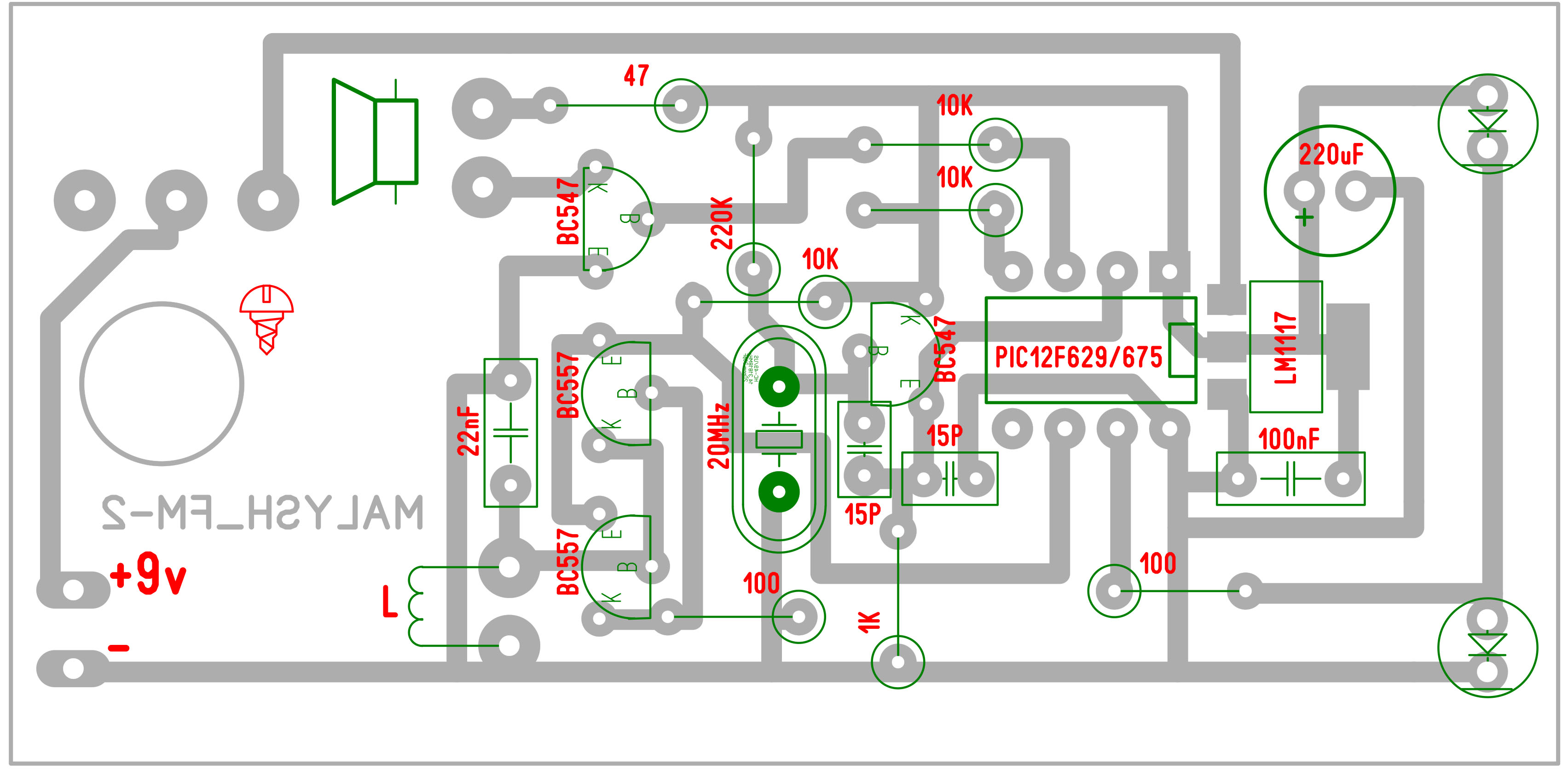

    Any one can help make the PCB Layout
    Is there a hex file for it ?
      Yes With HEx File
        Look original:
        first version - http://smartelectronix.biz/publ/samy...m_quot/1-1-0-1
        second version - http://smartelectronix.biz/publ/sleg...2_quot/1-1-0-3
                  i just See the SMT Layout
                  is that have Dip Layout version

                    malyifm2-1.zip
                    Not my designe, but people say it work well.

                      ok Eddy i will etching that board now and test
                      is that the hex file is working or not
                        First version, not very sensitive but not bad.
                        IMHO a continuos tone instead of the beeps would have been better. Asked the author about but didn't receive any reply.
                          HOW ABOUT THE COIL I WANT USE THAT FOR PINPOINTER
                            It's wound on a plastic support. At first I tried to wind it on a piece of ferrite hoping to get more sensitivity but I found out it was too much unstable.
                            I recall it seemed to react to changes in orientation.
                              I built one of these as a pinpointer. Worked so so. Sometimes worked fine other times need turning on and of a few time for it to work correctly. Might dig it out and wind a new coil for it.
