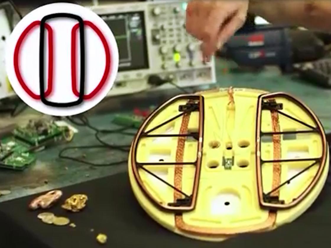

    Hi all, im really interested in this new technology, GPZ7000 by Minelab. may be we can start on this new thread. also ive got a pic of the new coil used.
    The coil construction is very interesting to look at. What is clear, is the labeling, for start/end of wind, on each individual coil.
    Also interesting is the rectangular cross-section of the bundle comprising the TX. The wire used in the tx, reminds me a little of the braided solder wick you can buy. Obviously, in this case, the individual strands are coated with insulation. And it might not be braided, it could simply be twisted. The colour variation, that can be clearly seen in your image, could give hints to twist/braid rate.

          Very nice design of the SuperD coil! Note also there's no shield for any of the coils. Tx probably made of Litz wire. Rx coils placed a bit closer to the ground.
              the shield will be graphite either painted on the shell or on a paper disk, its only missing for bench testing.
                And what's the purpose of the small PCB in the center?
                  Implementing H bridge to metal detector??
                  how they manage to receive the signal from the target if tx always on??
