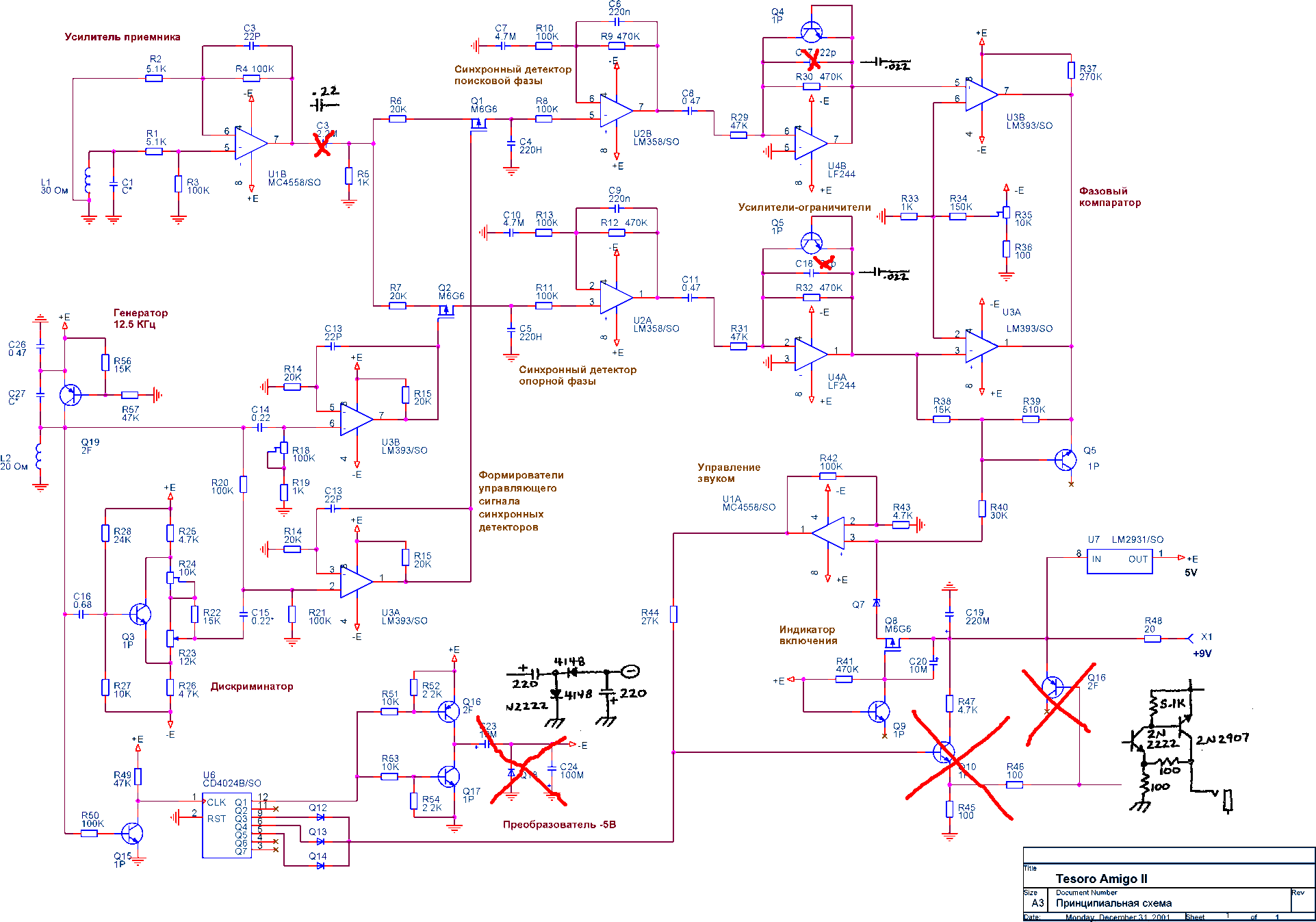

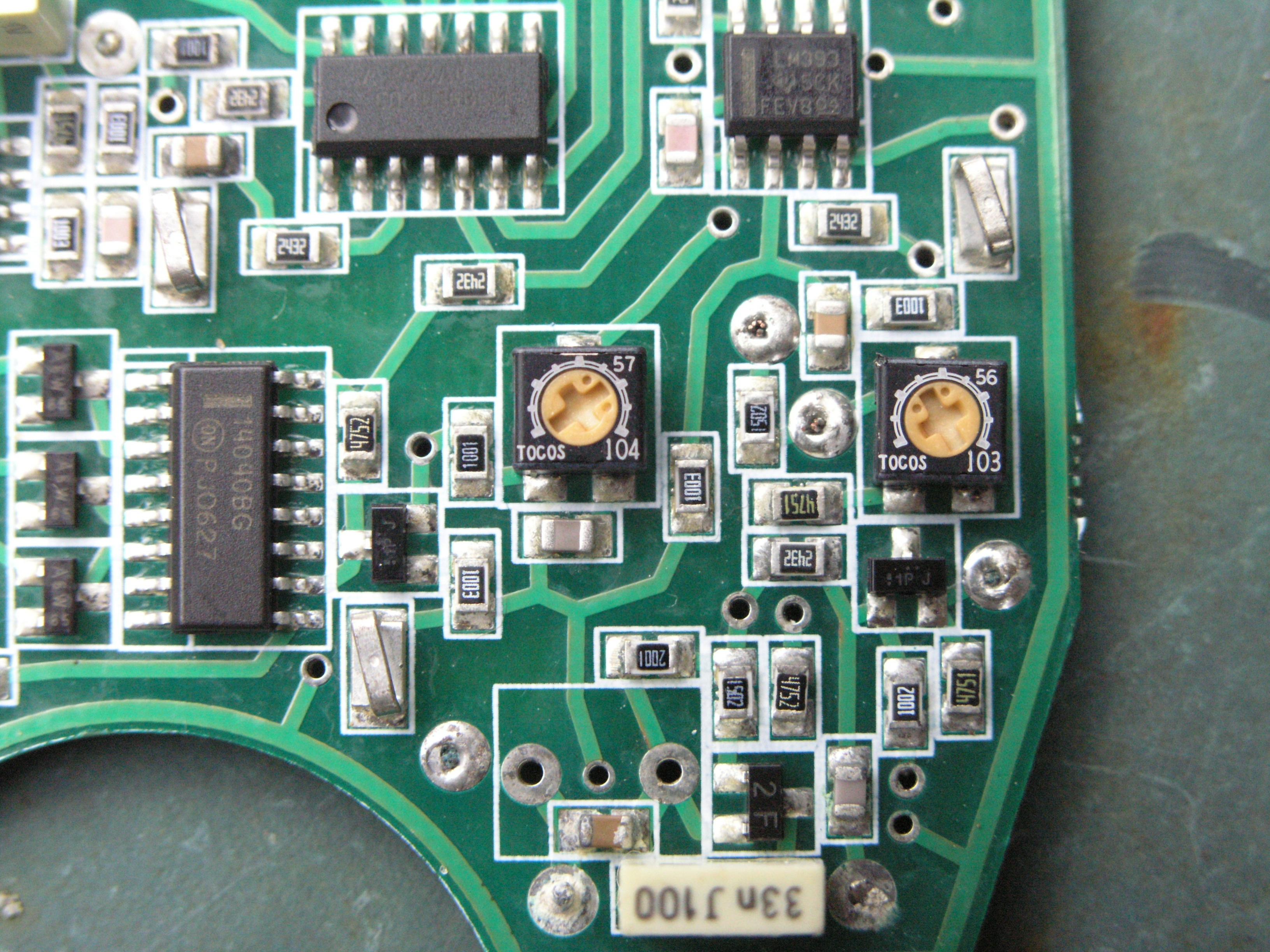

    Hello,
    electronic débutant
    aimerais, réalisée compadre tesoro circuit , schemas ci-joint ,
    question
    I would like a list of these transistors,
    capacitors C4 220H value (H) ??
    C24 100M value (M) ??
    LF244 component?
    cordialement.

      in fact I would like to achieve tesoro compadre,
      I am beginner in électronic, and the diagram I attached here,
      I would like to know what are the transistors, which are about schemas, what is the value, capacitors,
      C4 220H H?
      C24 100M M?
      LF244?
      to the wiring diagram in the air, possible?
      sorry for my english.
        you take the schema done by Ivan Kostin. I fixed it later because seen some apparent mistakes.
        hmmm... you ask me in Private Message given MY schematic TO ME. what it is?
        why? I am NOT the cheif enginer of Tesoro company. Lithuania I am living is BALTIC micro state in EU
        so tiny you WILL NOT find out it at the map -! this country so small that if you mark a map by your pen this point will be SMALLER.
        the world is full of egoistic people (((
          value of C4 ??
          C5 ?? ,
          220 NANO farad. H is N(ano) IN RUSSIAN. 220 NANOFARAD is 0,220 MICROFARAD. 0,220uF. or 220N. or 220n. or 220nf.

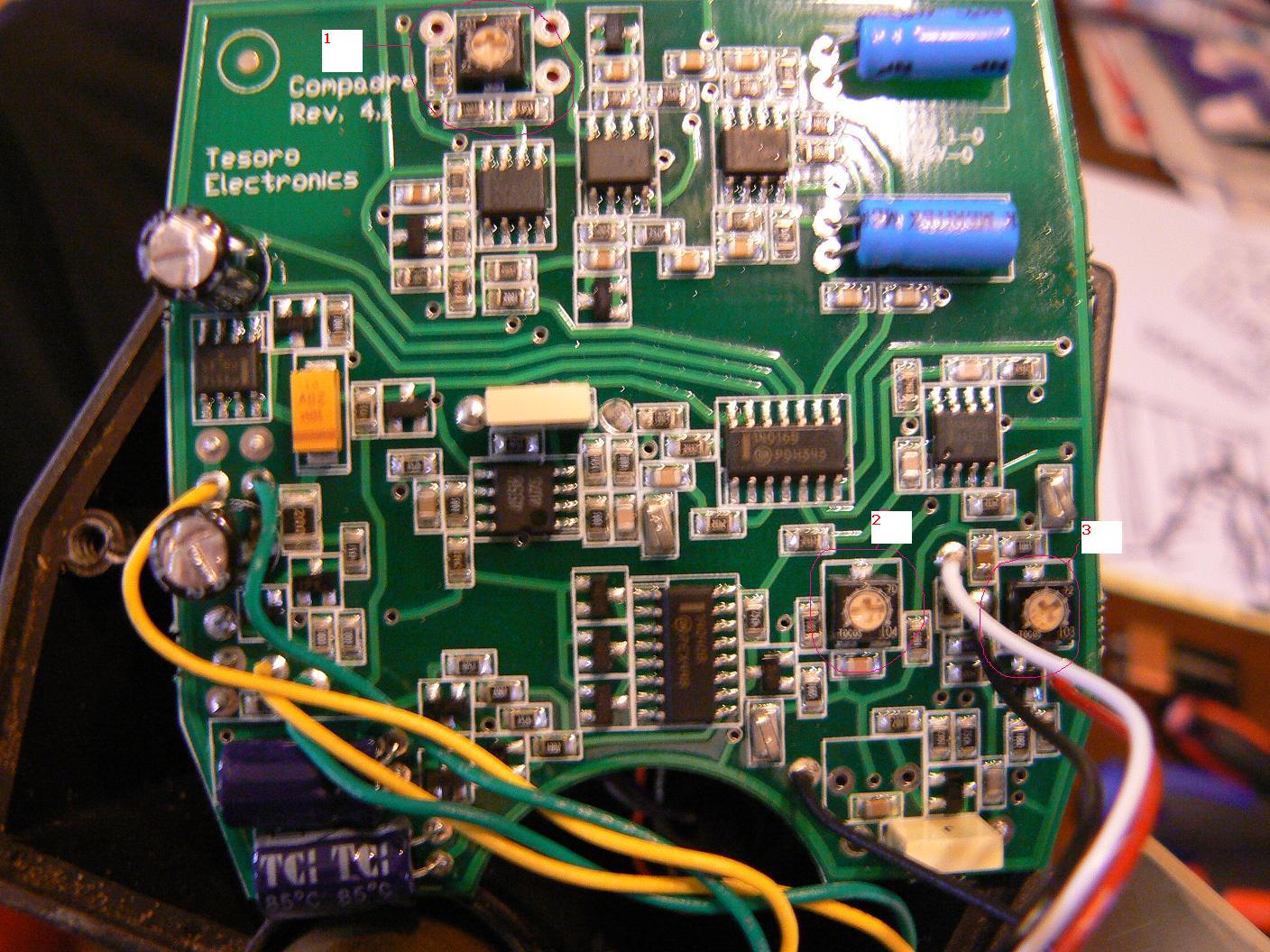

            I have was given a Tesoro Compadre board that was water damaged ages ago.
            Can take some pictures if you want. Camera is flat at the moment (on charge now)
            Out tomorrow so would have to be Monday.
              thanking in advance Koala. my email address [email protected]

                value of C4 ok
                C5 ok
                Transistor Q19 2f ?
                Q3 1p ?
                Q15 1p ?
                Q1M6G6 ?
                Q4 1p ?
                Q5 1p ?
                1p Q9 ?
                Q16 2f ?
                Q17 1p ?
                LF 244 ?
                  Transistor Q19 2f ?
                  Q3 1p ?
                  Q15 1p ?
                  Q1M6G6 ?
                  Q4 1p ?
                  Q5 1p ?
                  1p Q9 ?
                  Q16 2f ?
                  Q17 1p ?
                  you have to learn SMT components reading THE reference books. you seems cultivate your huge EGO here... you want to do anything learning nothing. if you did not solder SMT never why you want to make compadre that done in SMT? by the way I did GMT King Cobra that COVERS all tesoro schematics, I HAD closed the tesoro matter by KING COBRA EVERMORE. another deal that nobody has interest to it but this is your and their problem.
                    this is not mine done pic. what you can see here? NOTHING! another people ask to give the part list. WHERE I can take part list
                    if you share such blur pics?

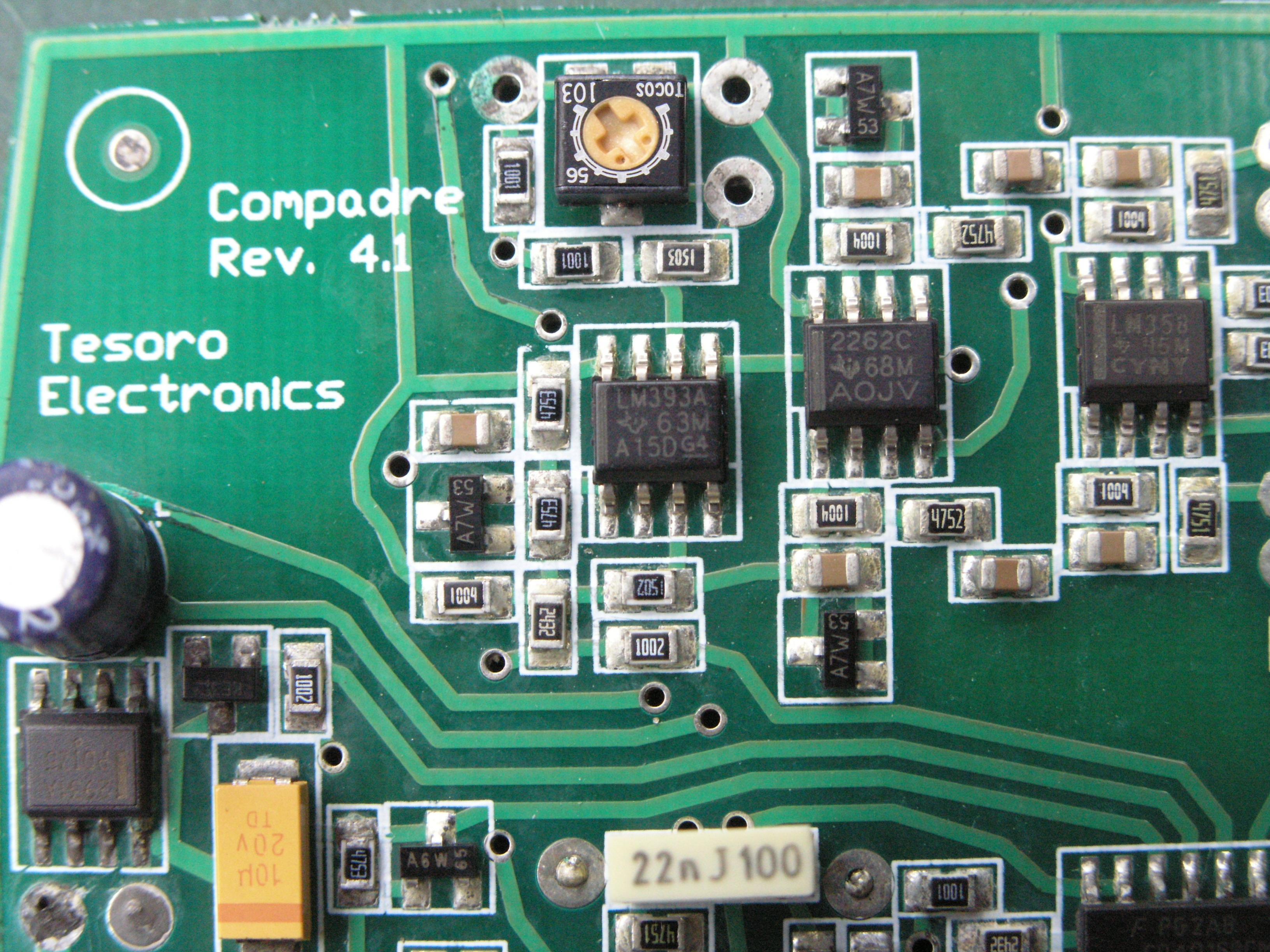

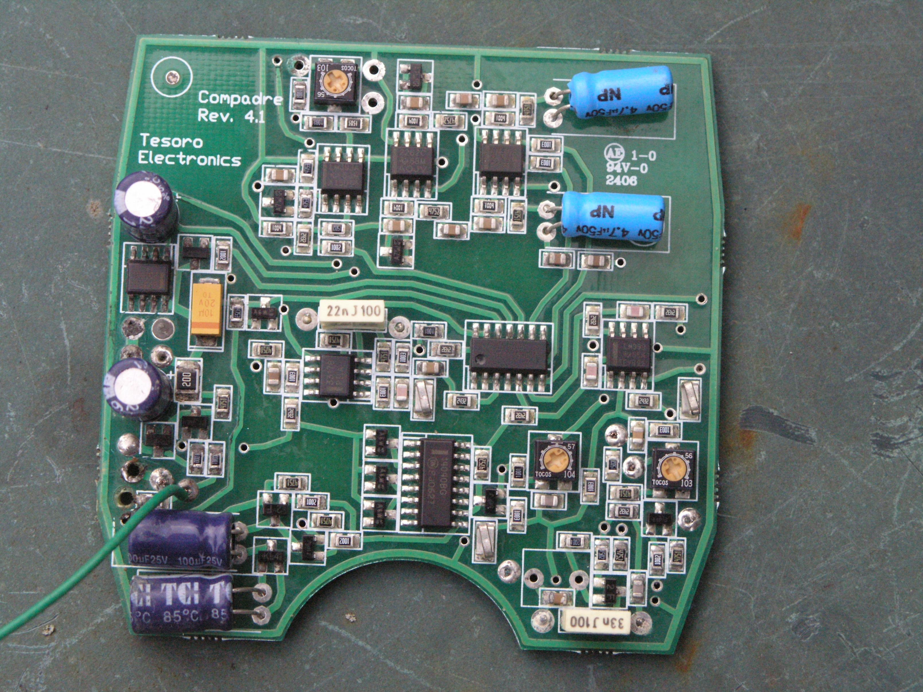

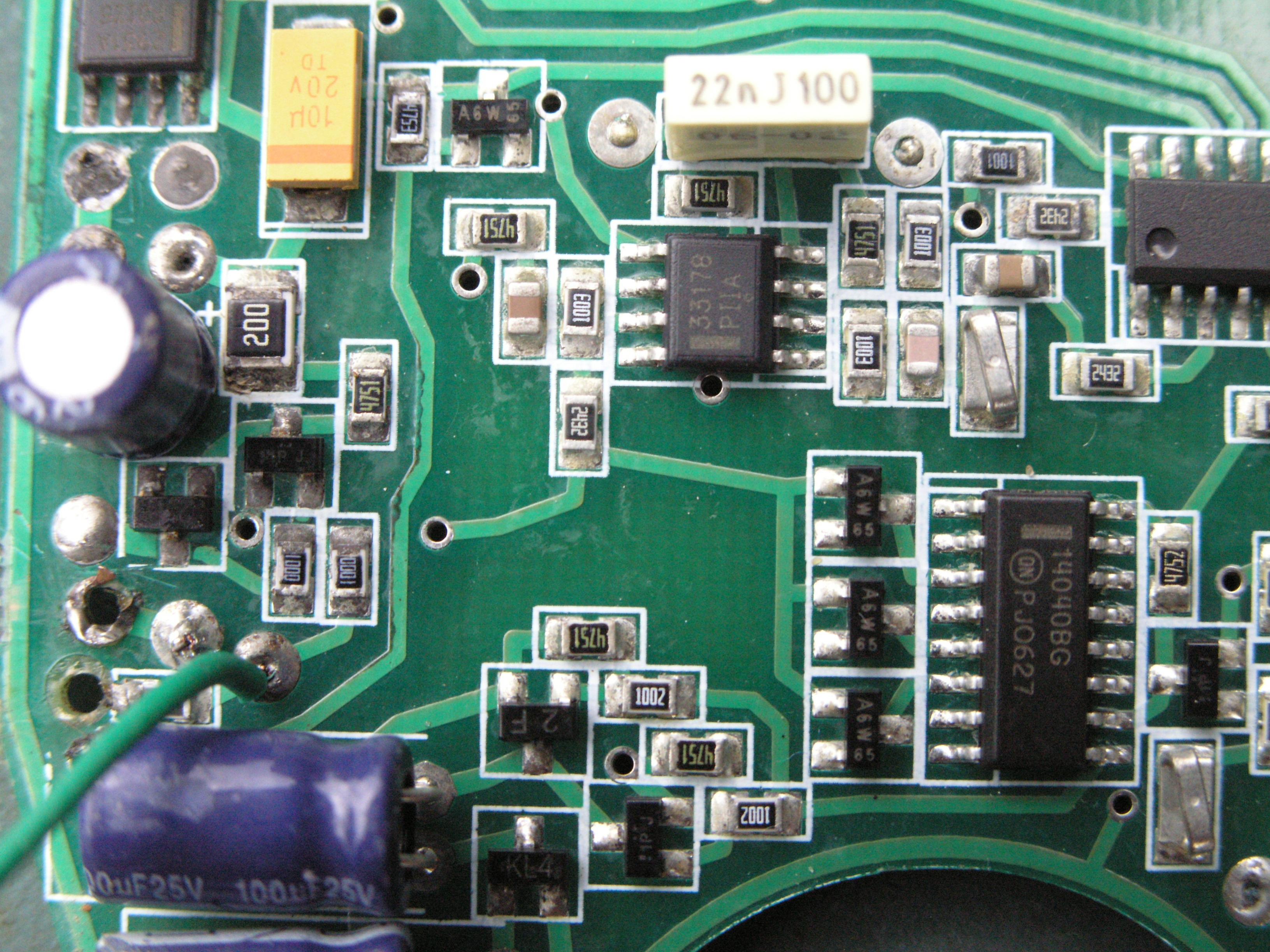

                      Looks like I might have to give is a clean the board to be read all the resistor values properly

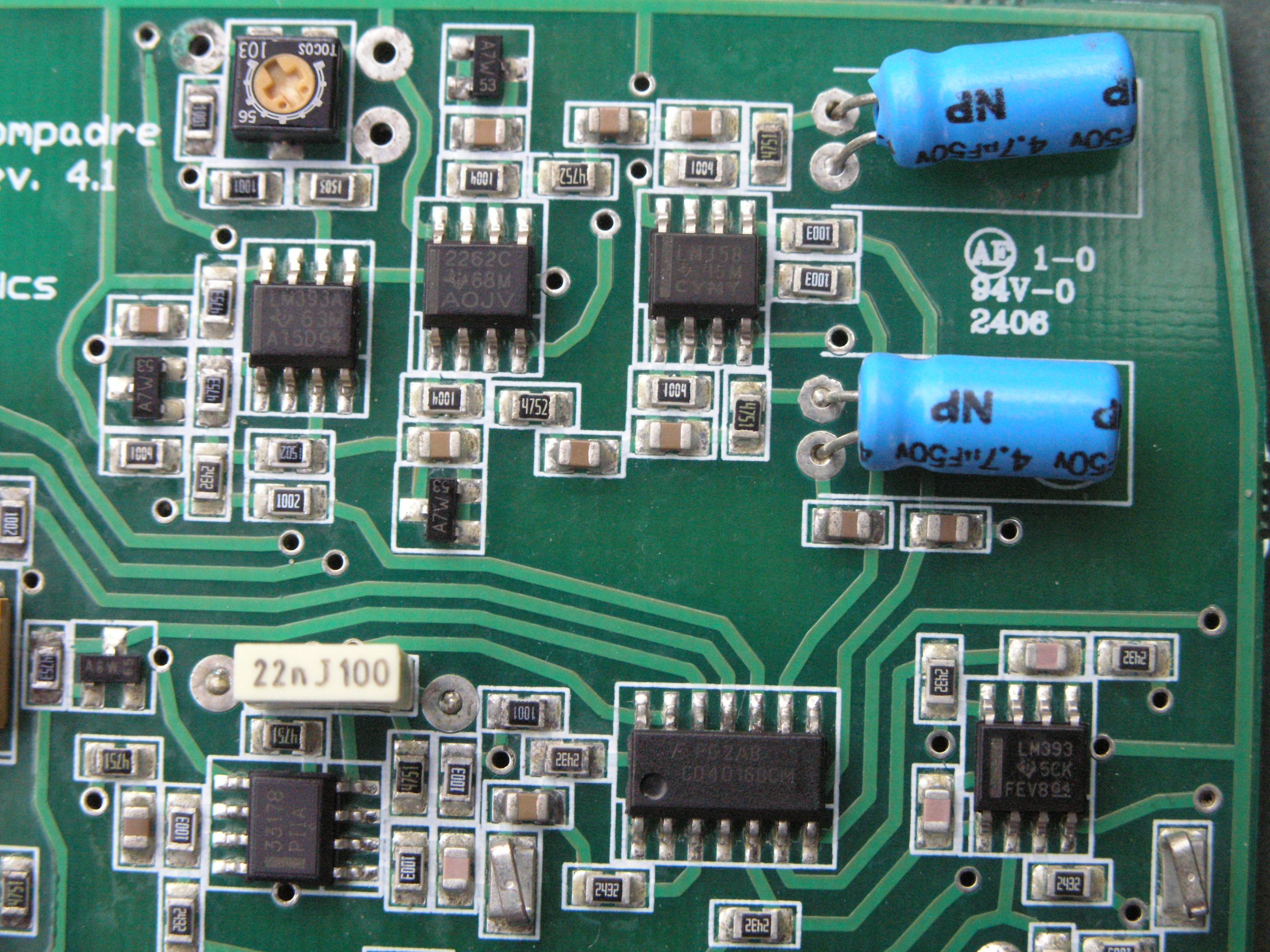

                        PEOPLE I AGAIN PRAY YOU TO GIVE HI RESOLUTION PICS AT SUNDAY AT THE SUN LIGHT.
                        please dry wash the boards you shoot from dirty and dust! where you can - desolder the wires. give both - WITH wires and WITHOUT the wires.
                        YOU THINK YOUR PICS ARE GOOD. NO GOOD! ALL ARE BAD! this is EXAMPLE, i did, 4 mpixel camera (FOUR MP!).

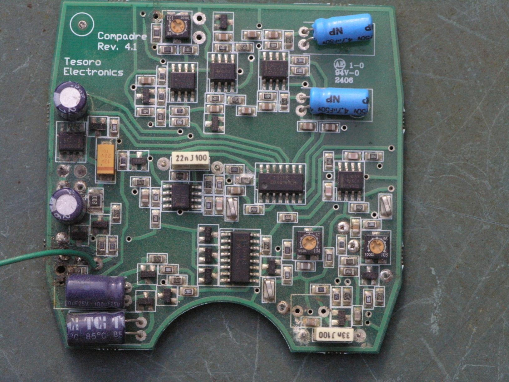

                          Given in a bit of a clean
                            WOW! nice job Koala! thank you lots! perfect example for everybody. another (bottom) side please too...
                              hi koala, i bet that board is salvagable, you said before it was water damaged, my sinclair ql looked a lot worse than that(after the floods last year), but its been saved.
                              i guess it depends if you like compadre's or not.
