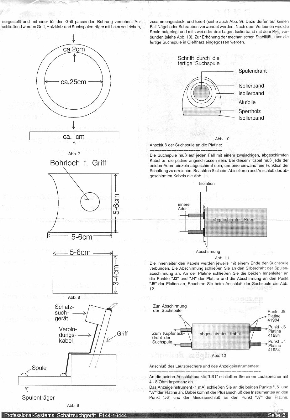

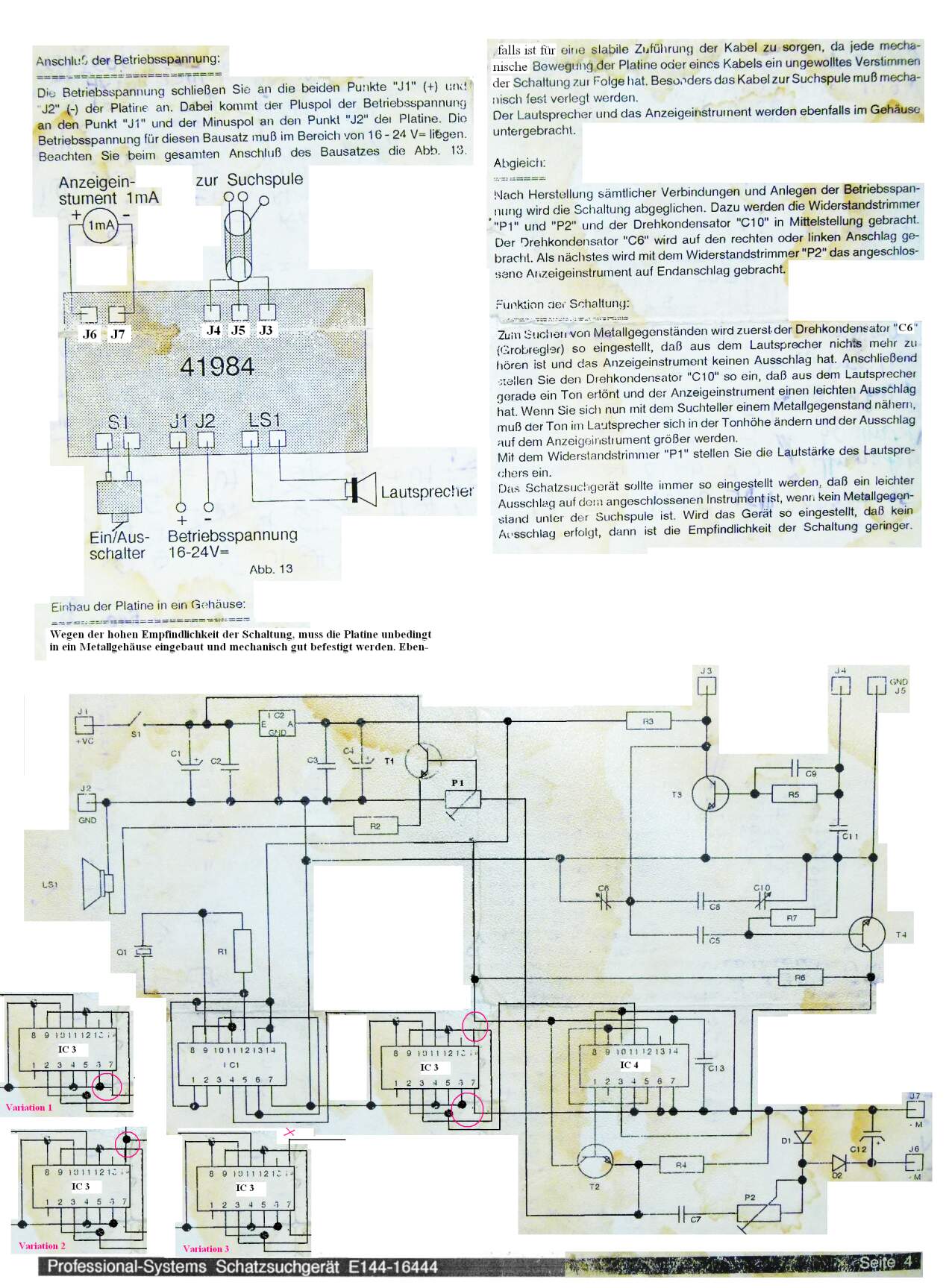

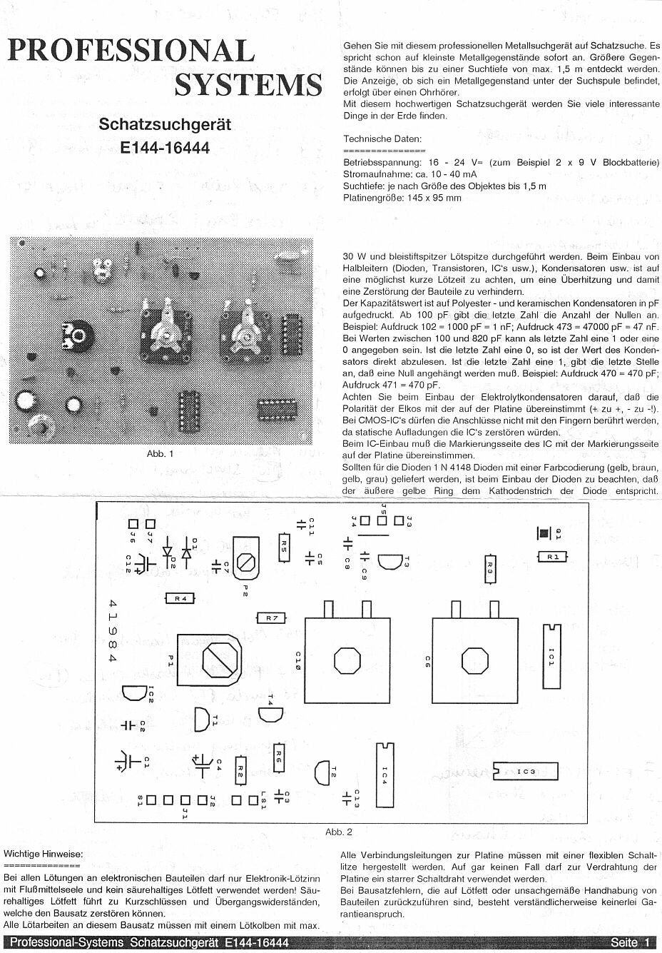

    Yes! Meanwhile I could find and recover my very first MD-schematic from many years ago!
    It was offered in some no longer existing selfbuiltable-electronic-devices-catalogue.
    The describtion claims that the maximum detection distance is 1,5 meters (with a 25cm coil) !!!
    If this would be true of course it would be fantastic!
    Could somebody please check out what kind of circuit it is (probable P.I.) and
    if the schematic already is correct or instead one of the described connection variations?
    The paper with the drawing on it was in pretty bad condition but I really did my
    best to recover the schematic!
    Enjoy!
    i think it is not a pi the way to tune frequency speaks for some kind of bfo it is a single coil and some windings to much for pi
      Thx for the info, and perhaps the quartz also speaks for BFO.

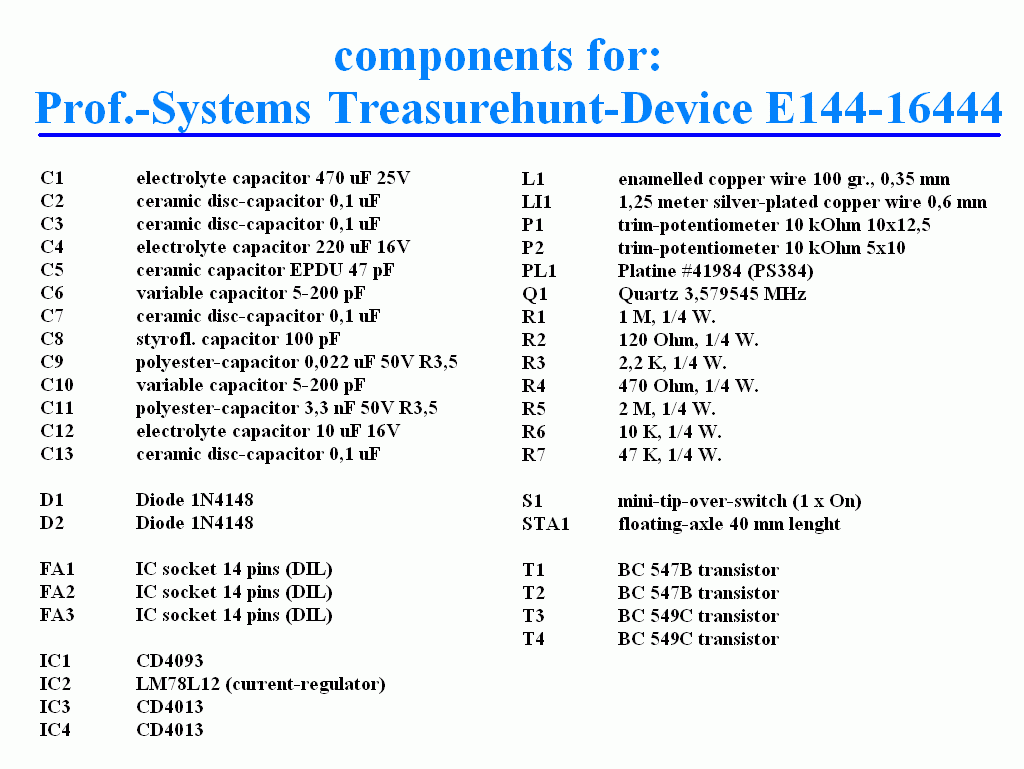

      I have now translated the parts-list into english and below also is attached the
      complete how to built this device manual (still german but should be no problem).
      The formerly price of the kit was 45 deutsch-marks which meanwhile are worth
      around 50 Euro (inflation etc.).

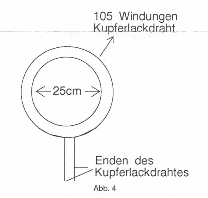

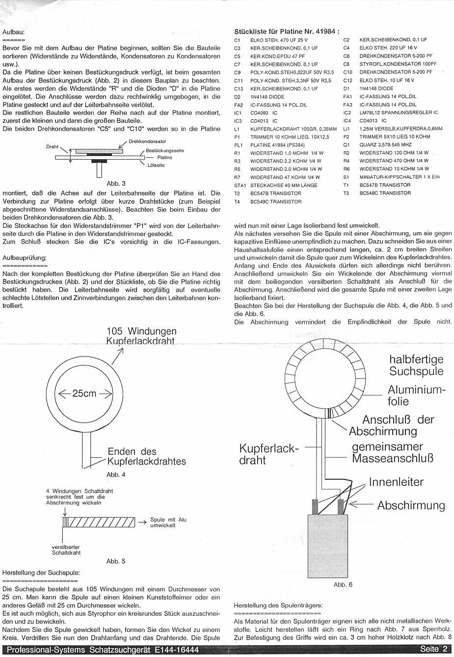

      Useful technical details:
      There is some coil-shielding with the silverplated-copper-wire and stripes of alufoil.
      The both coilcable-wires have to be shielded, with those both shielded cables inside
      another shielding. The shielding is connected with the coils-shielding and with
      soldering spot "J5".
      Adjusting the sensitivity is done by the potis.
      The speaker may have ca. 4-8 Ohm impedance.
      Voltage: 16-24v DC (two 9v block-batteries work)
      power consumption: 10-40 mA
      depth with 25cm coil: up to 1,5m (for very large objects)
      (larger coils should be even deeper)

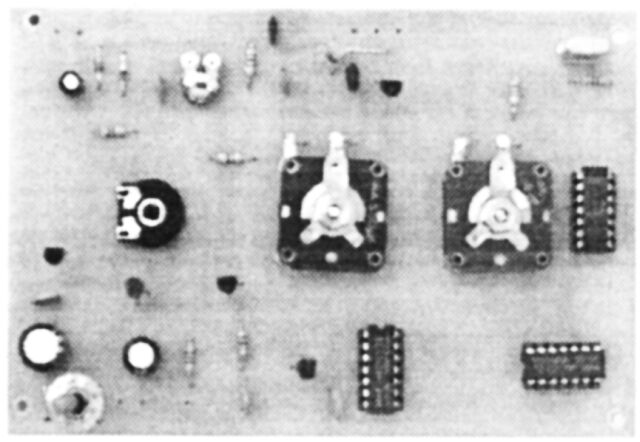

        the documents seem also from some other Version (if you lokk the pcb Pictures) also the entry article in the product order info says it can be powered from single 9V
        if you make also a Little pcb layout i would build it too
        but take care of the trimming capacitors, this should be a modern common type the parts from building document seems like old Radio parts ;-)
          Drawing a pcb layout should be no problem by using the sketch from the #1 page
          but first it would be good to be shure what are the correct connections of IC3.
          This is some Dual D Flip-Flop chip for simple digital operations (CD4013).
          Also the IC1 (CD4093), this is a schmitt trigger for digital NAND calculations.
          I guess I can find out the real working chip-connection just by looking at the interal
          chip pinout and design.

          The PCB shown in the catalogue seems to be just an older model.
          It looks that both have pretty the same parts in use and also the Number 16444 is identical.

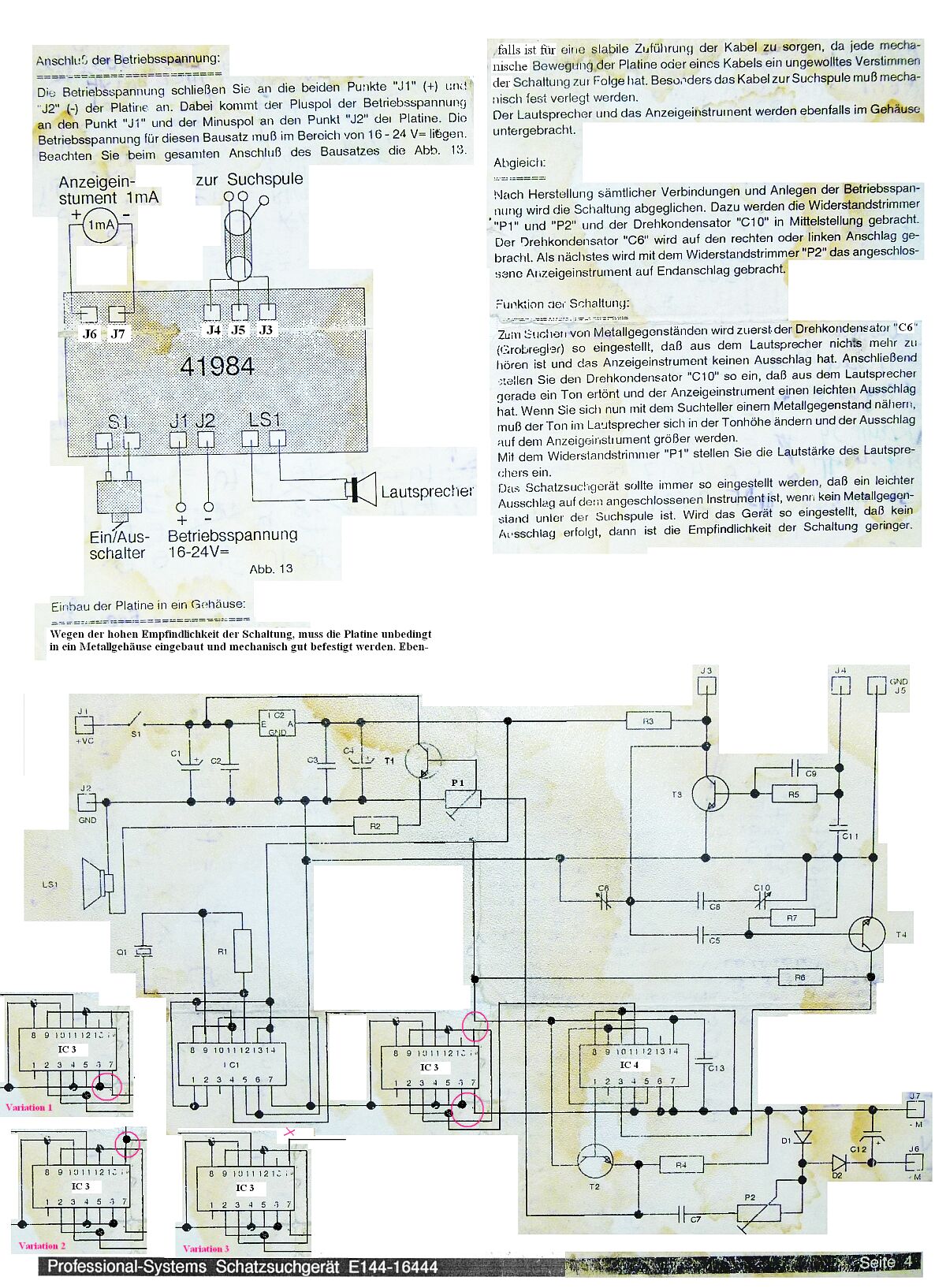

                The connections to IC3 shown in the main schematic are definitely wrong. Suggest checking against the 4013 data sheet.
                  Also, the connections around IC1 don't make sense. For example, pin 11 (an output) is linked to the positive supply, and the crystal is connected across two inputs so there is nothing driving it. There would be no point in building this until the schematic is OK. Sorry.
