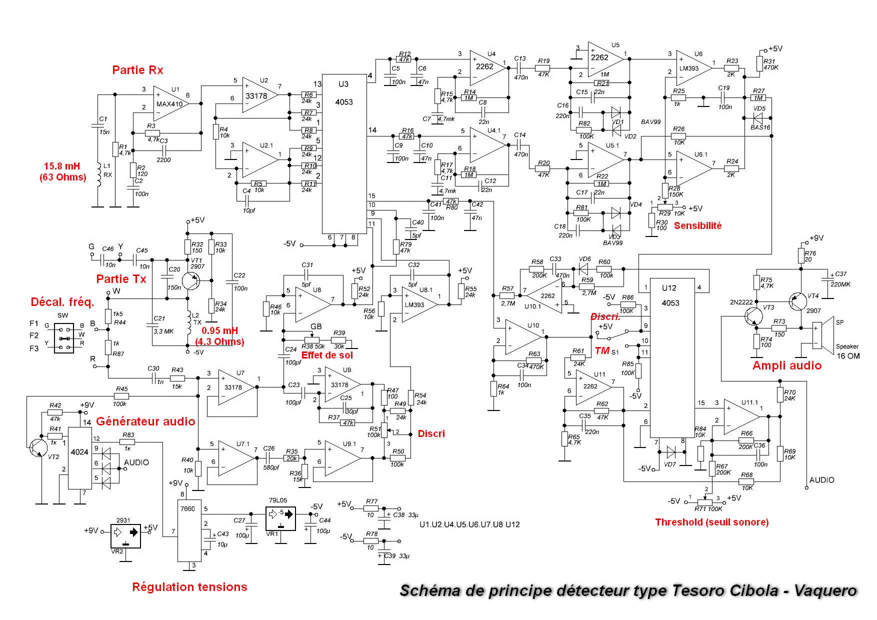

    I'm building a TESORO CIBOLA with a schematic i found on another forum.
    I think it comes from Russia.
    My first question is : On CIBOLA/VAQUERO, there is a pinpoint button which is absent on the scheme, Is it normal ?
    I'd also hear comments about the coil building cause the requirement seems strange for me (0.95mH for TX looks more like a PI coil than a concentric one).
    I heard about spider coil for CIBOLA but spider coils sounds like PI project to my ears.
    The Cibola and Vaquero detectors use Tesoro 4-pin coils. These have a TX inductance of approximately 1mH, and an RX inductance of 7mH.
    A value of 0.95mH (950uH) is too high for most PI detectors, although I understand that some of the C.Scope detectors designed by Eric Foster have 1mH TX coils. So - to answer your question - the value of 0.95mH is OK, but the idea of using a basket weave coil doesn't make any sense.

              Do you think it's a big problem if a homemade coil fit the inductance requirements but not the resistance ?
              The resistance act on the current/power transmit by the coil and the inductance on the frequency. So, few differences on the coil resistance may not have big impact on the working, no ?
              What do you think ?
              If my resistance is too low, i can add one in serial to reduce the current ?
              If it's too high, i cannot do anything to reduce it, except using a bigger wire.
