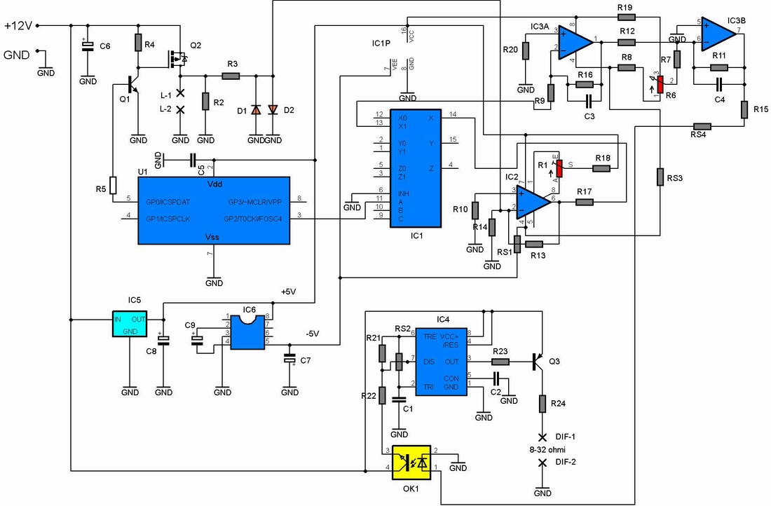

What is this Schematic?
  • What is this Schematic?
    please give us more info
    do you have partlist?
    where do you get this scheme?
    i can remind that i have seen similar device last two weeks while looking for now Projects
    was also with optocoupler
    U1 is pic Controller right?
    if you Need help you should Play with open Cards, ok?
      Comp
      R2, R3, R4, R8, R10, R15, R19, R23 = rezistor 1 K
      R5, R12, R14, R7 = rezistor 10 K
      R18, R21, R22 = rezistor 22 K
      R9 = rezistor 3,3 K
      R11 = rezistor 330 K
      R13 = rezistor 1 M
      R16 = rezistor 30 K
      R17 = rezistor 220 ohmi
      R20 = rezistor 1,5 K
      R24 = rezistor 33 ohmi
      RS1, RS2, RS3, RS4 = 0 ohmi
      R1 = semi 100 K
      R6 = pot 10 K
      C2, C3, C4, C5 = cond 100 nF
      C6 = cond 1000 uF
      C7, C8 = cond 100 uF
      C9 = condr 10 uF
      C1 = condensator 10 nF
      D1, D2 = dioda 1N4148
      OK1 = optocuplor 817
      Q2 = tranzistor IRF 9540
      Q1 = tranzistor BD 139
      Q3 = tranzistor 2N3906
      IC2 = NE 5534AP
      IC1 = CD 4053BE
      IC3 = LM 358P
      IC4 = BE 555
      IC5 = 7805
      IC6 = ICL 7660
      U1 = PIC 10F202
      DIF-1, DIF-2 = dif 8-32 ohmi
      PCB: 7,7 x 10 cm
        I would like to know if it is worth doing
          what changes can be made
            seems that is has two stage Receiver amp - thats ok
            if coil damping resistor is r2 it could be i Little bit to high better to search best value by measuring the damping curve
            and i should have more watts then the other 1k resistors maybe 2w at least
            do you have layout for pcb, hexcode and source?
            source would be nice so we can watch Timing of the delay, and pulse freq. and width
            you Need at least a working hex
              it is this right?

              i think you have to buy the hex code
              i hate don´t like People which Claim diy Project and sell pre-programmed µControllers
              pcb Looks good and kit seems ok
              but how much should you spent (how many €)?
                yes it is, do not have hex file, parts would reach 30 euros
                  do you have contact to seller, or are you the seller?
                  is the Price including the pre-programed µController, and how much is shipping Romania to Germany for example?

                  the coil and Connection cable is not needed, because most poeple here do the own coils which fits best to their coil Shells
                  for myself i prefer 27cm or 32 cm for those kind of pulse detectors
                    sells ready assembled complete with coil He says that detects a gold ring from 20 cm with coil 22 cmI'm not the seller, I want to buy it,how do I make more sensitive I do not know how cost from romania to Germany should contact seller
                      I'll order one and I will try with another coil maybe 27cm or 32 cm
