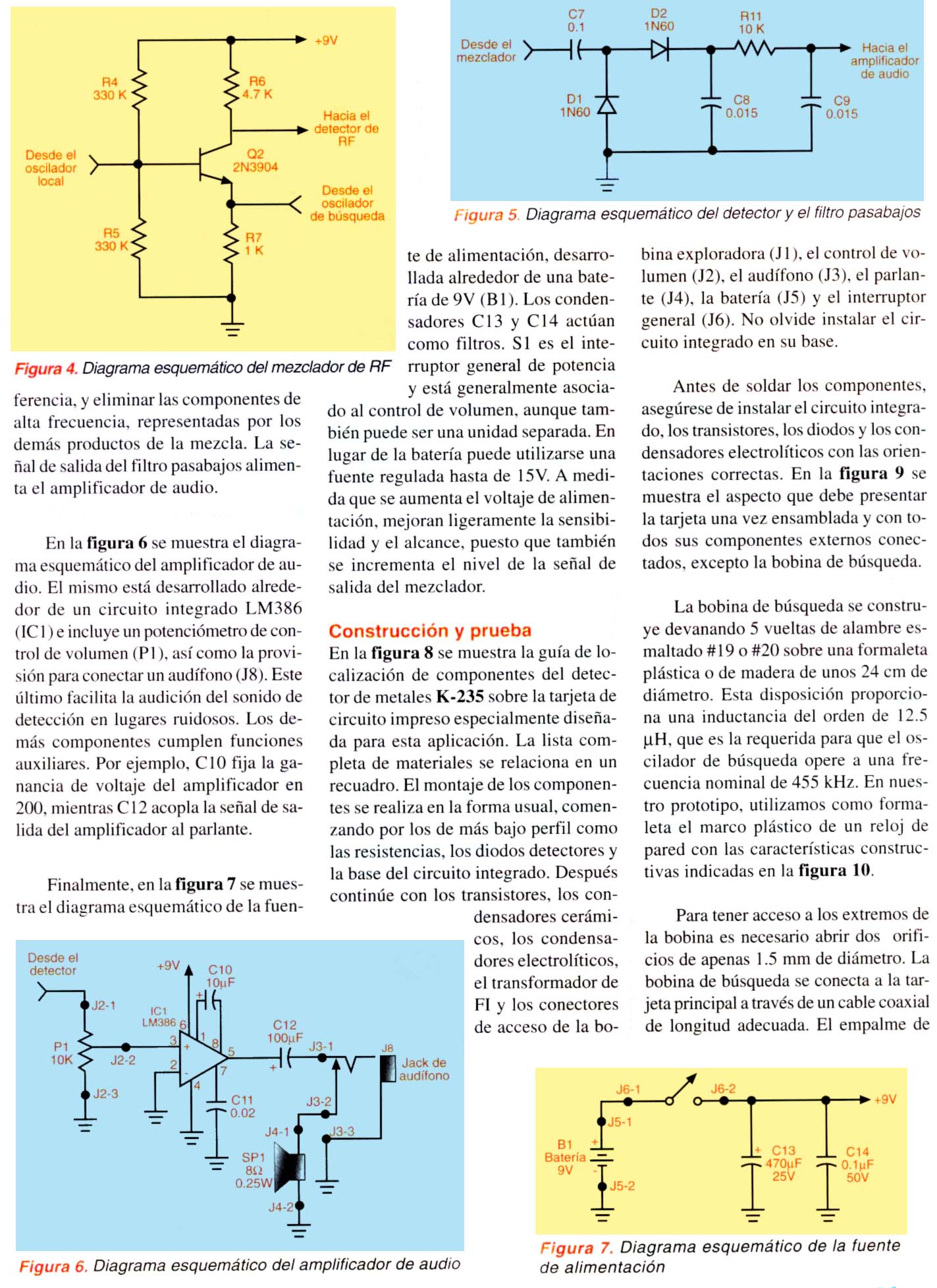

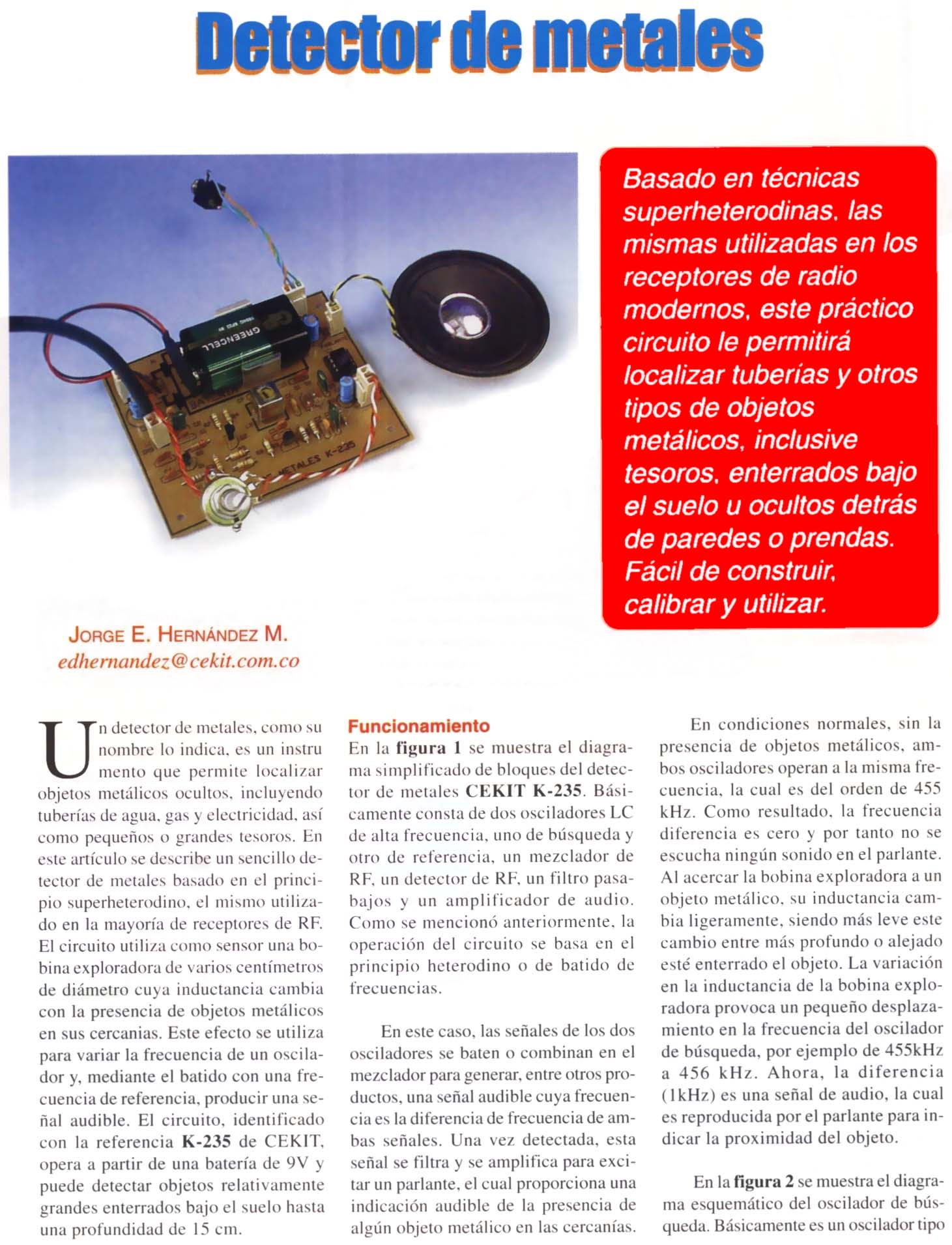

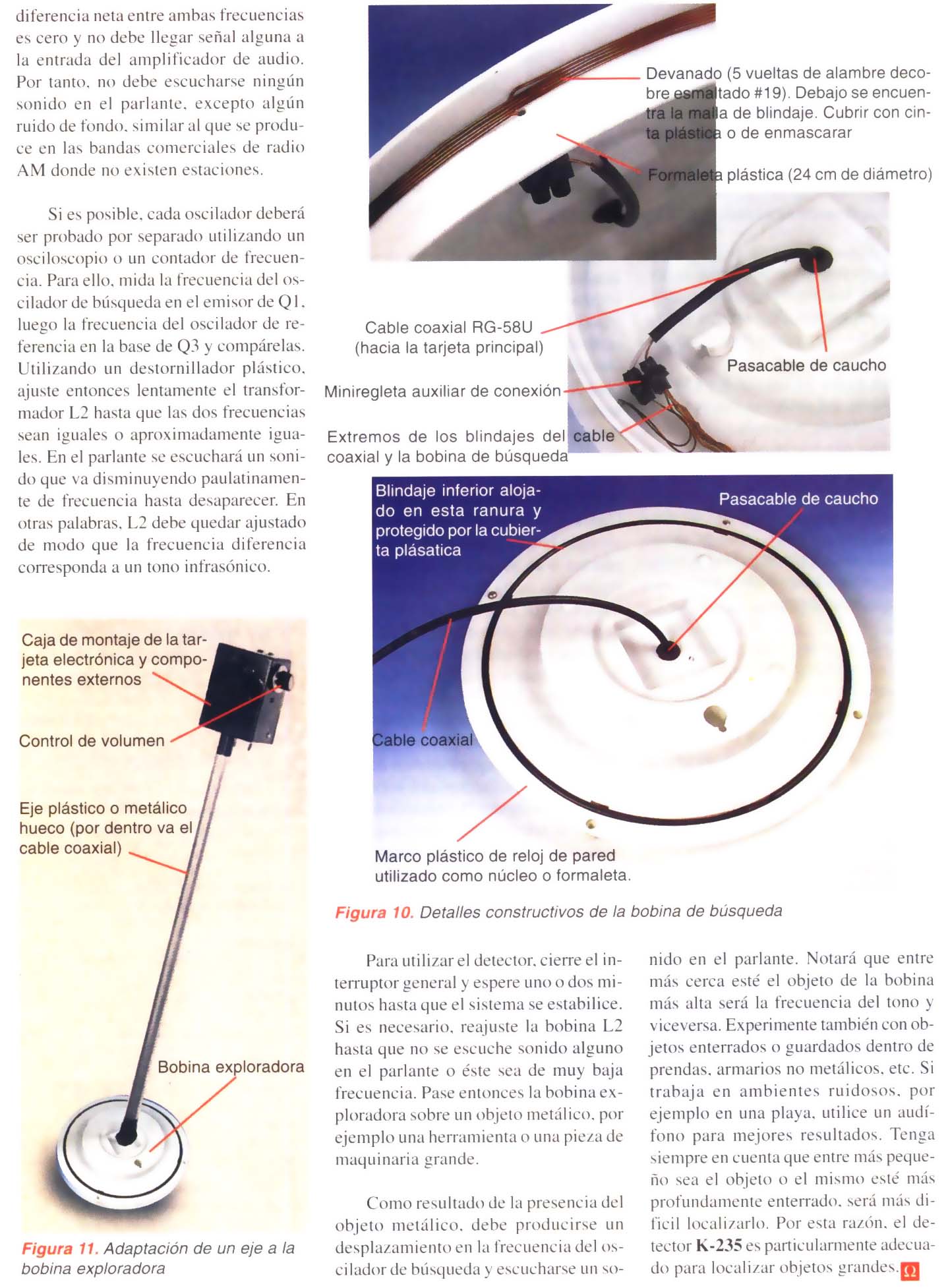

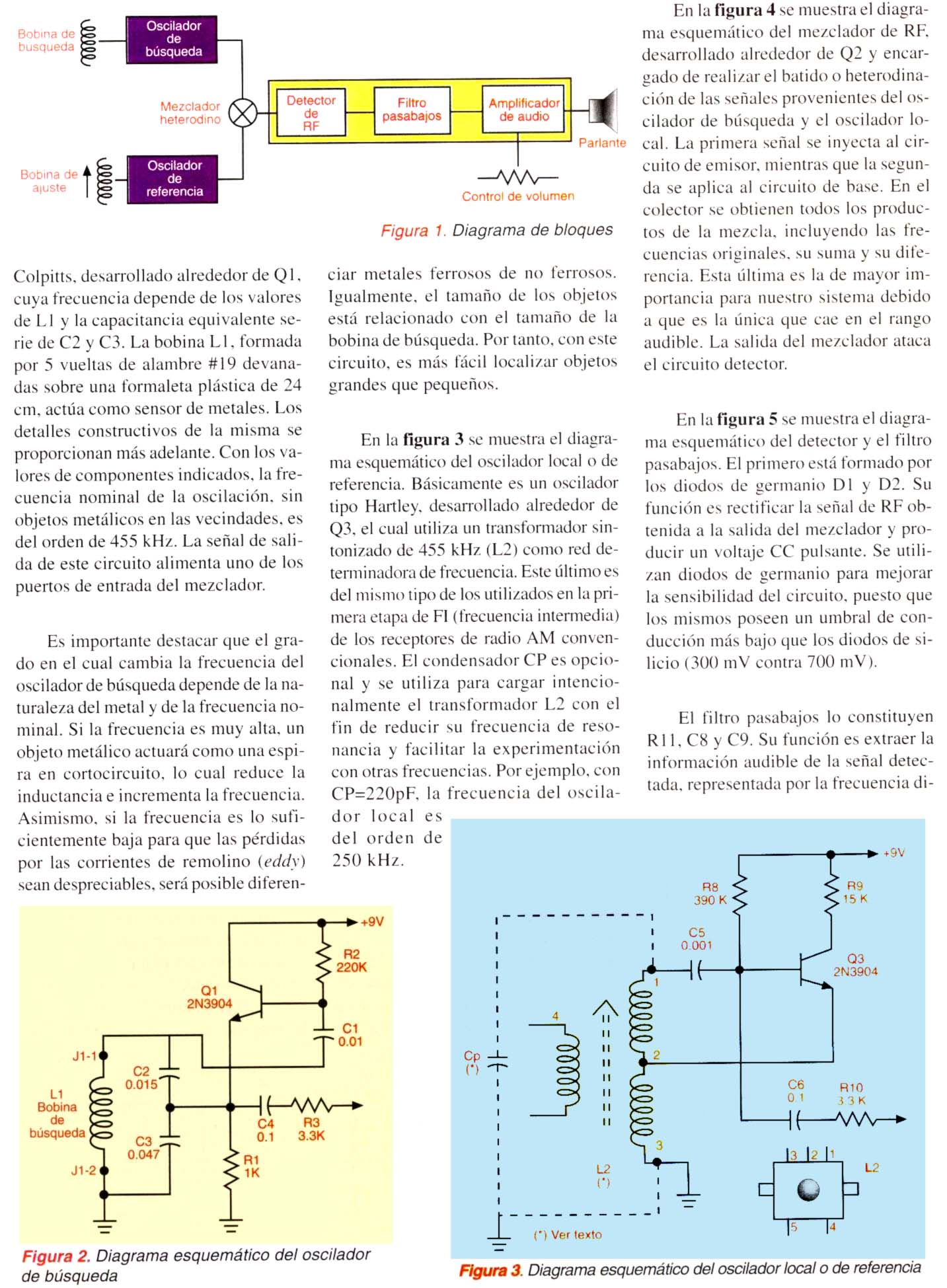

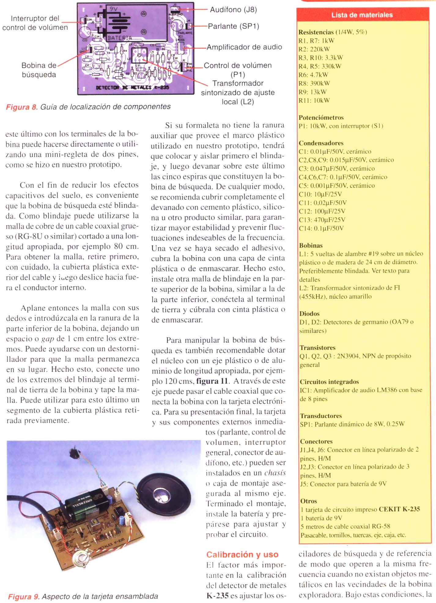

    Here we could need some OCR soft and then we can translate it to english.
    Of course the pix and the schematic is international
    understandable so it will be no problem to built this MD.
