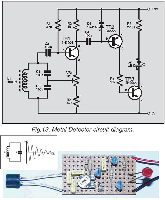

LED Metal Detector
  • LED Metal Detector
    Perfect for beginners or persons in need - very few parts!
    A little ferrite-core with 100 windings but also
    some larger coil will work if it has 100 microHenry.

      Keep relaxed and I hope there is now a circuit you can built and then you have a real working metal detector!
