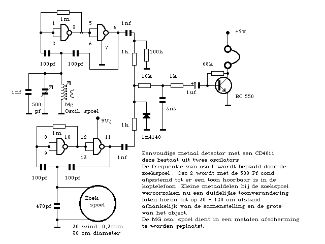

Dutch Metal Detektor with CD401
Translation:
Simple metal detector aroud a CD4011 conssiting of two oscillators.
The frequency of oscillator 1 is determined by the search coil (Zoek spoel).
Oscillator 2 is tuned with a 500p capacitor until a tone can be heard in the headphones.
Small metal parts next to the search coil will now cause a clearly audible change in tone
up to a distance of 30 - 120 cm depending on the composition and size of the object.
The Mg. socillator coil must be enclosed by a metallic screen.
This same detector has been posted many times under many names. All BFOs using logic IC oscillators have about similar performance, 120cm is probably a realistic detection distance for a buried Tiger-tank made from wire grade copper...
Unless there is any particular interesting feature about it, it's much like posting the same PI/VLF detector over and over under a different name like some national clones seem to appear. Can you post all these old BFO schematics under a single thread? For a very good example, KT315 keeps a thread for his own schematic archive.
It is easier to read through an "archive" thread instead of many small cluttery threads that easily get lost in the forum. If you want to preserve these schematics I suggest you make them a single archive!
