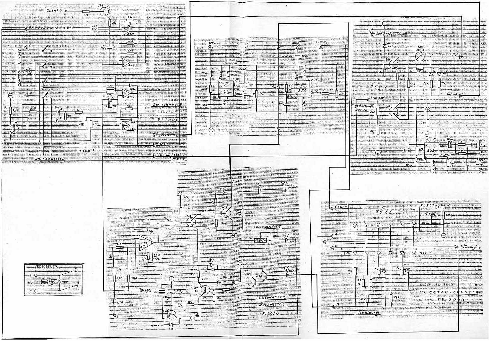

Anyone ever see this Schematic Says PI 2000
  • Anyone ever see this Schematic Says PI 2000

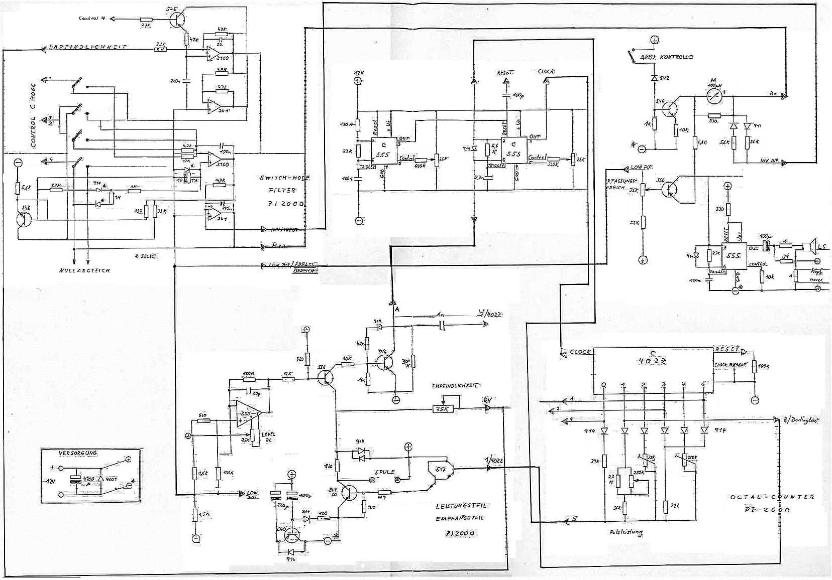

    I had this in my archives. It was very poor and hard to read so I use paint to clean it up a bit.
    There is a lot of german on it. I had thought it somehow refered to the Whites PI 2000 but
    I'm not sure what it is. It doesn't seem complete.

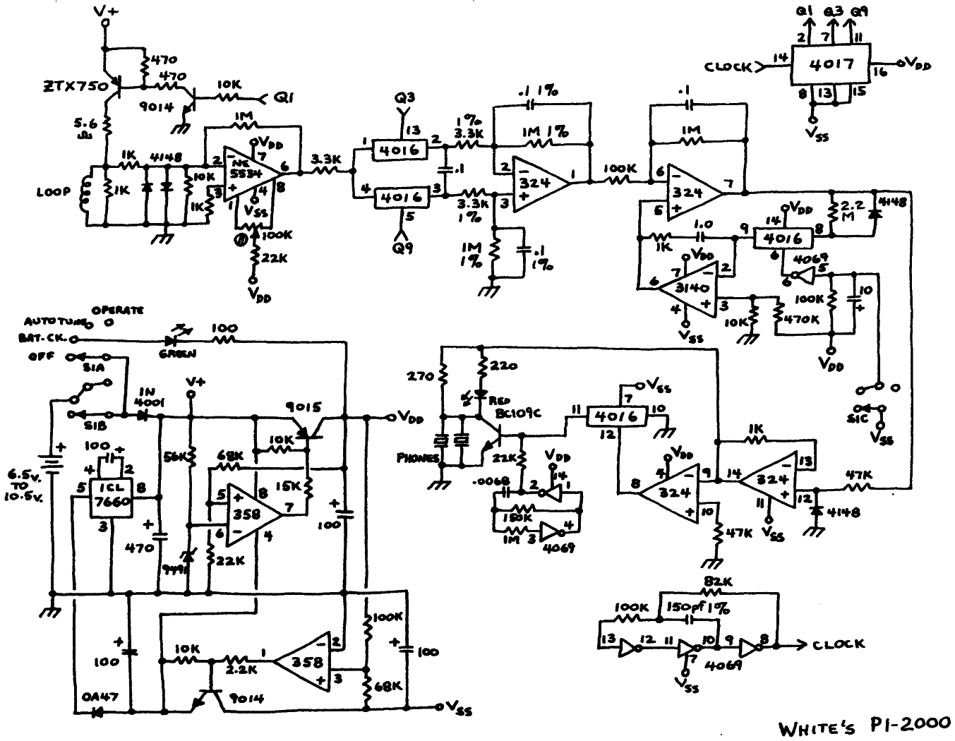

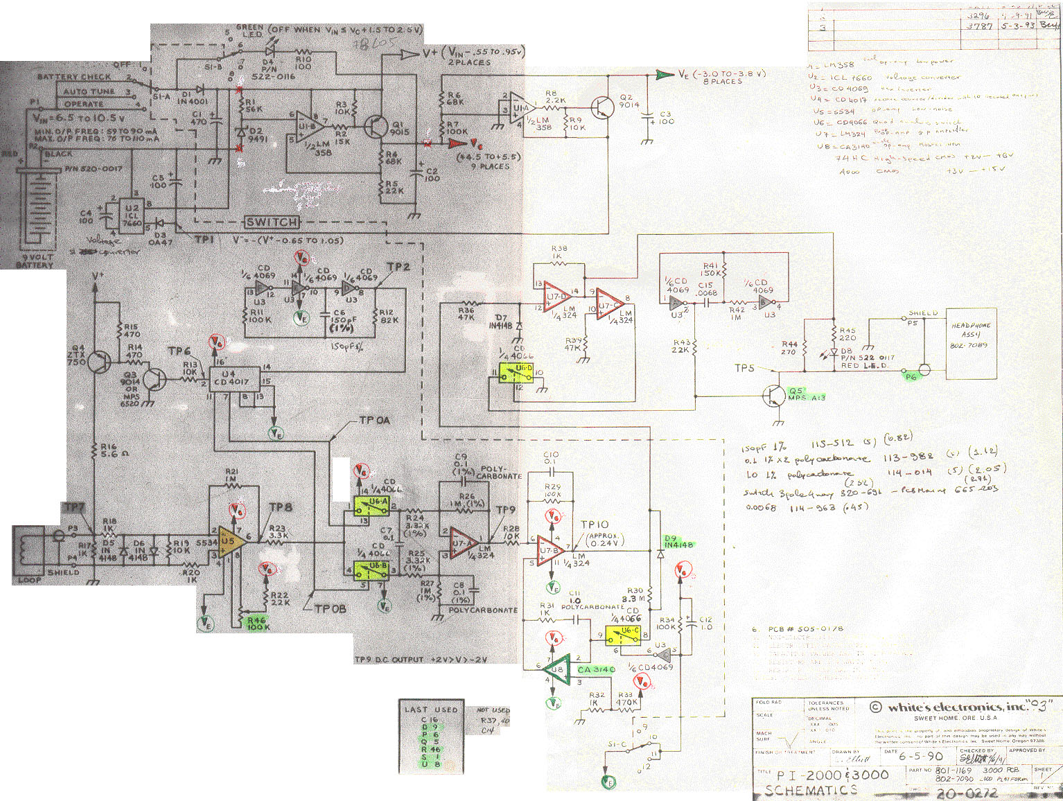

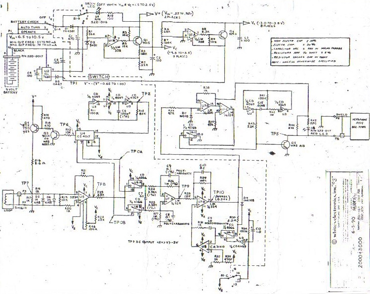

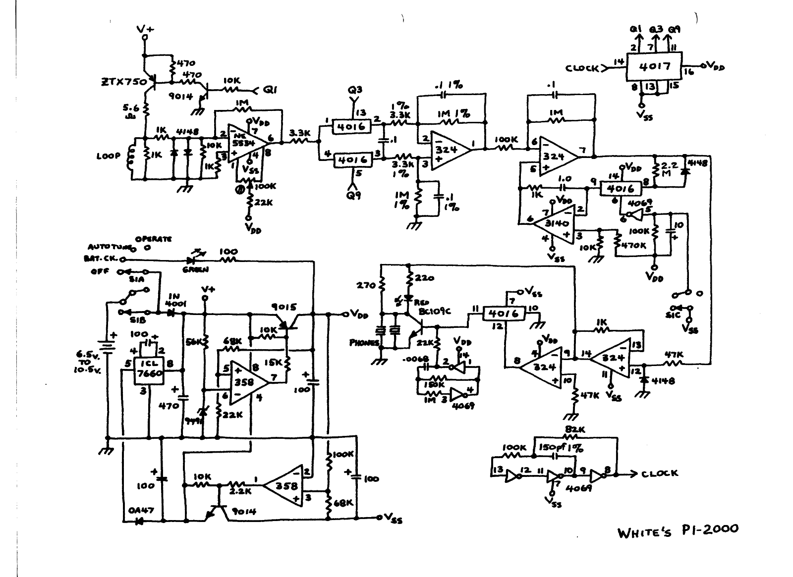

    Try this -> Click image for larger version
ID:	345300Click image for larger version
ID:	345301Click image for larger version
ID:	345302Click image for larger version
