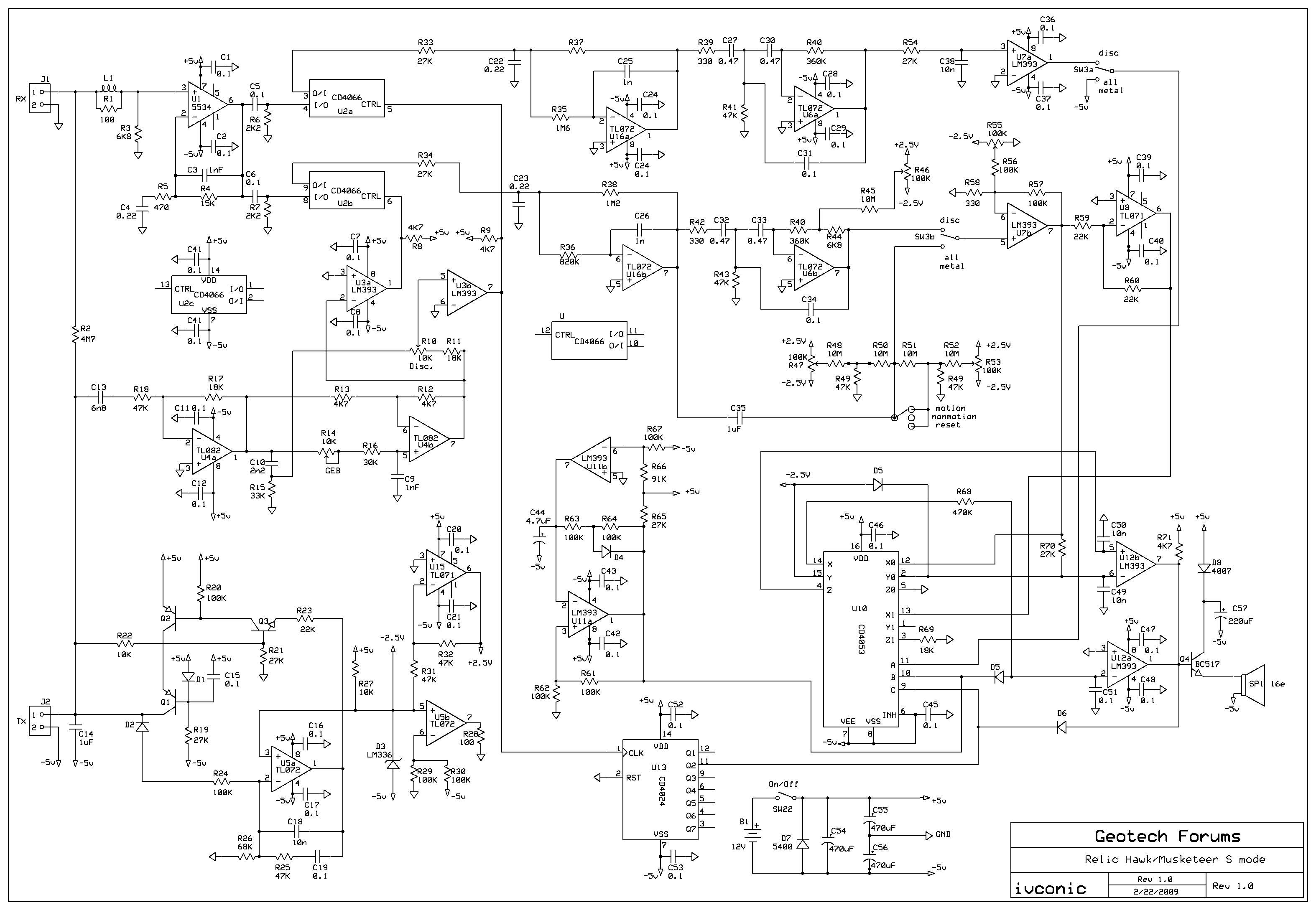

    I have your schematic for the relic hawk, dont know where it came from,
    but I'm interested in the +- 5volt supply which is simple capacitor split voltage supply.
    I see its used for all the IC's , TX and the audio section
    is this capacitor design really sufficient to handle the proper regulation of the +- 5 volts and current requirements of the circuit ?
    What is the voltage rating of the caps ?
    Thanks 6666
    Look at U5b
      Davor was faster!

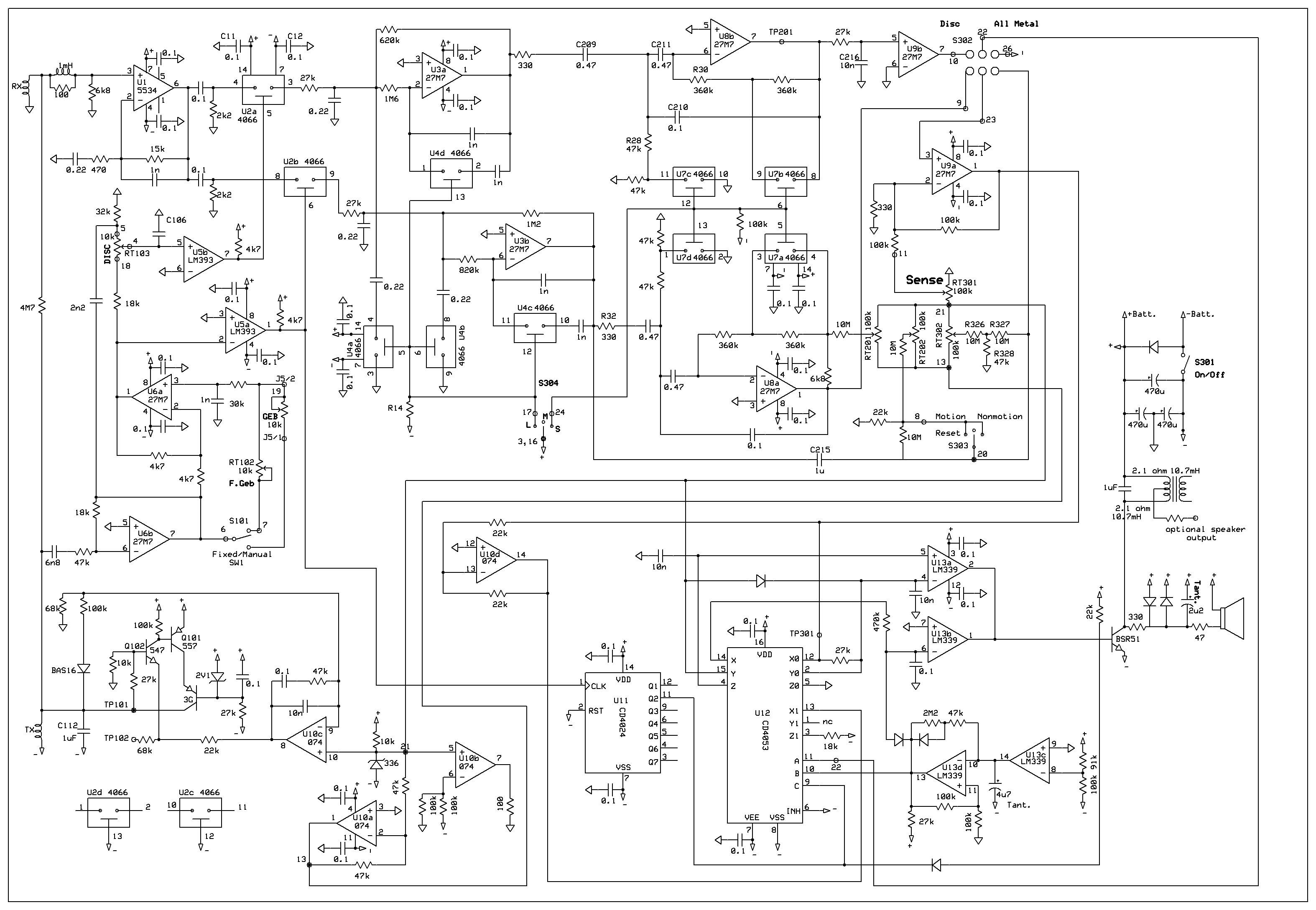

      It's schematic of Relic Hawk reduced only on S mode.
      Musketeer and Relic Hawk are almost identical.
      Here are both schematics for comparison;

        It's been a while... i completely forgot about those schematics!
        Now looking them back again; i see that i omitted audio transformer (a choke actually) at first schematic!?
        Right now i am not sure why i did that!?
        But most certainly second schematic is more interesting to analyze.
