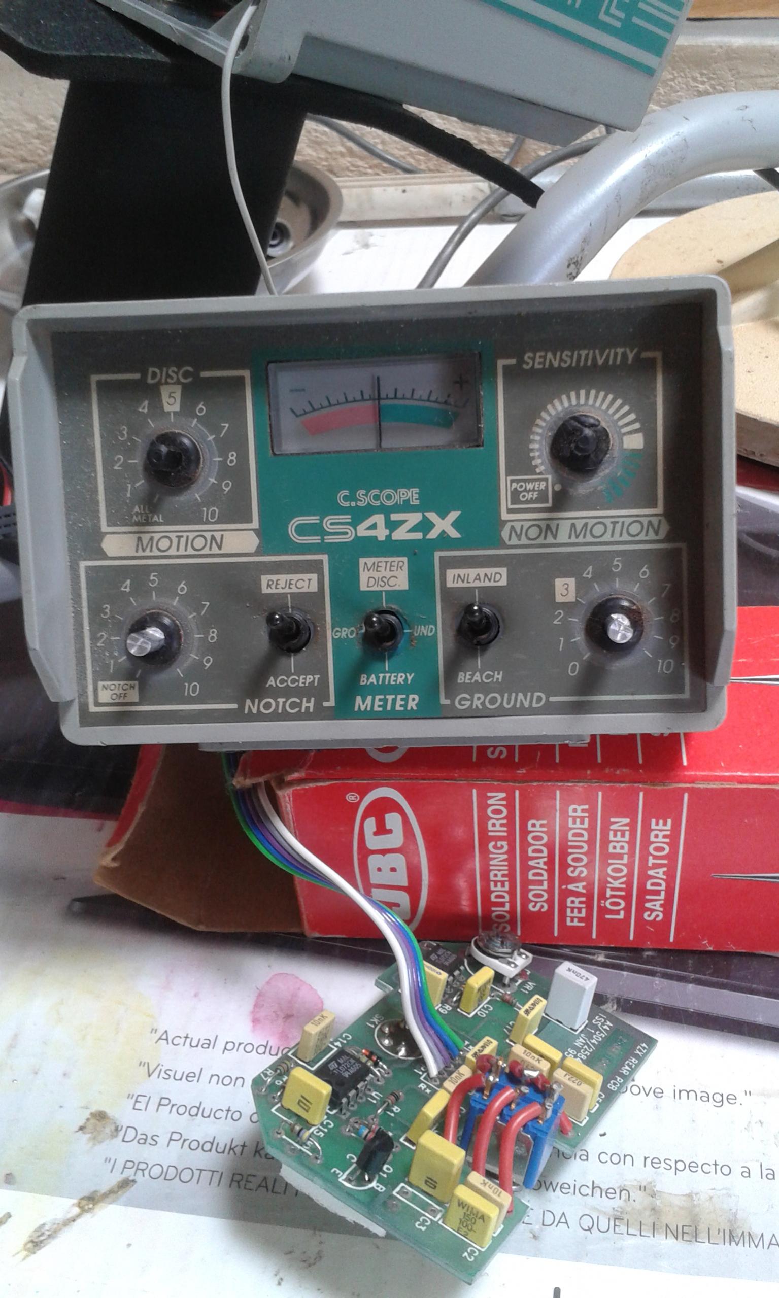

This week end I had the detector on my bench
I have some pics with the mobile phone. In the next post if I am able to do, I will publish them

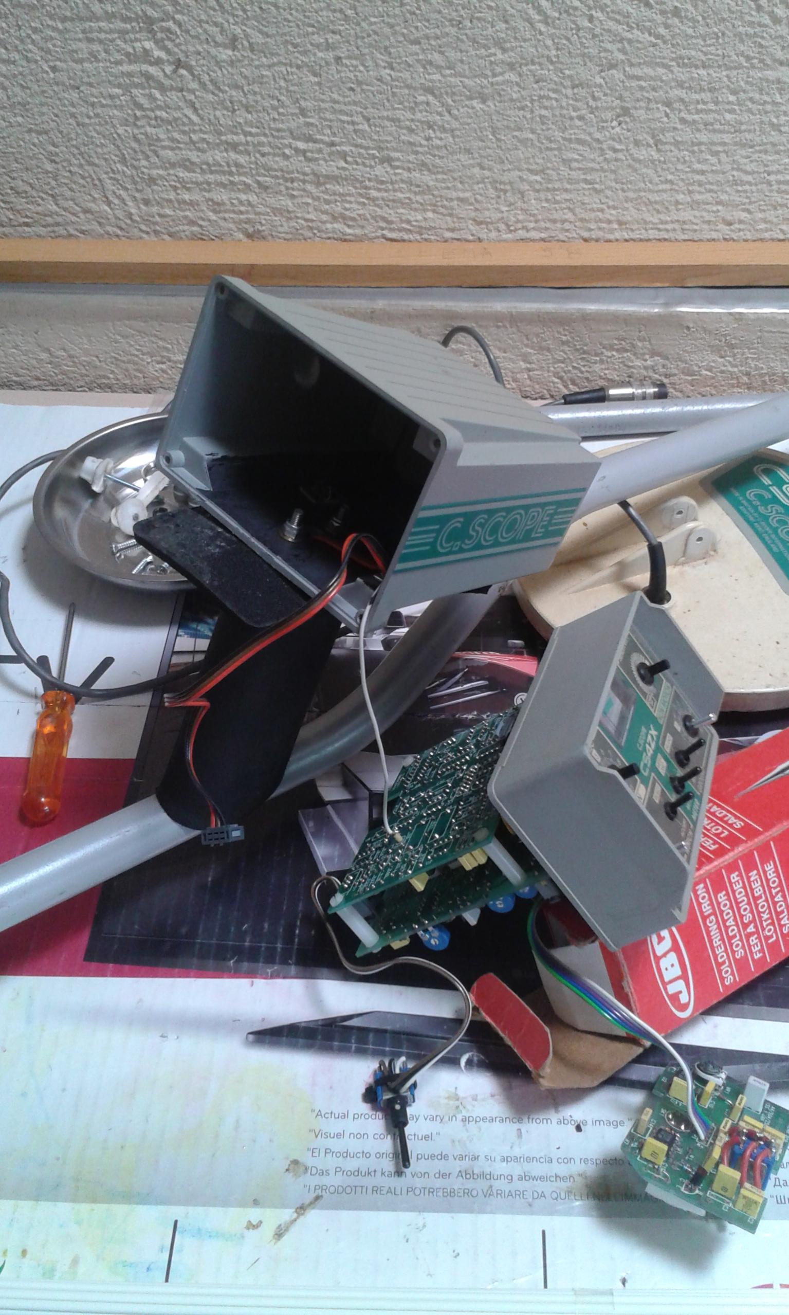

Interesting things:

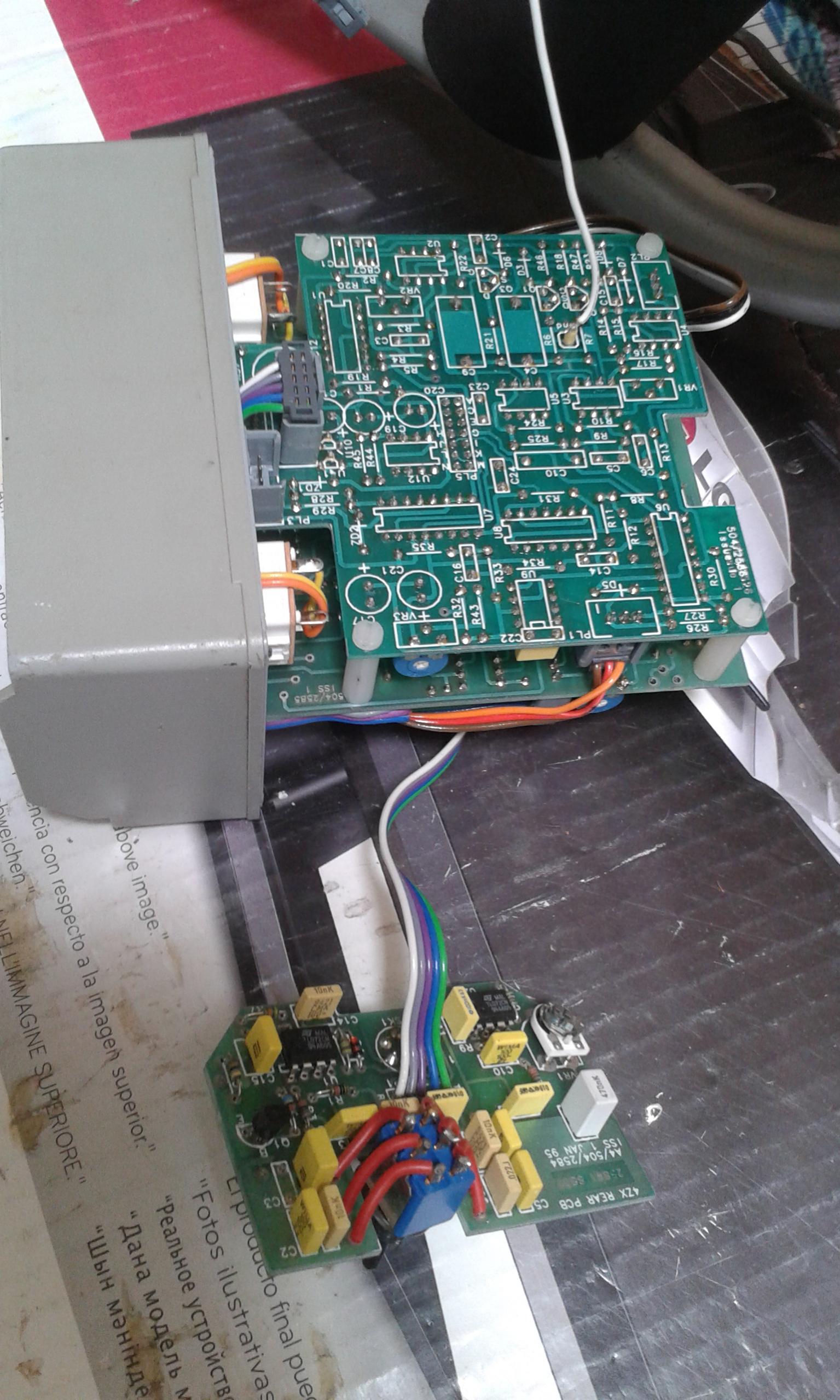

- 4 PCBs into the main control box, one for the front panel another for the rear panel and horizontal sandwich with the other two

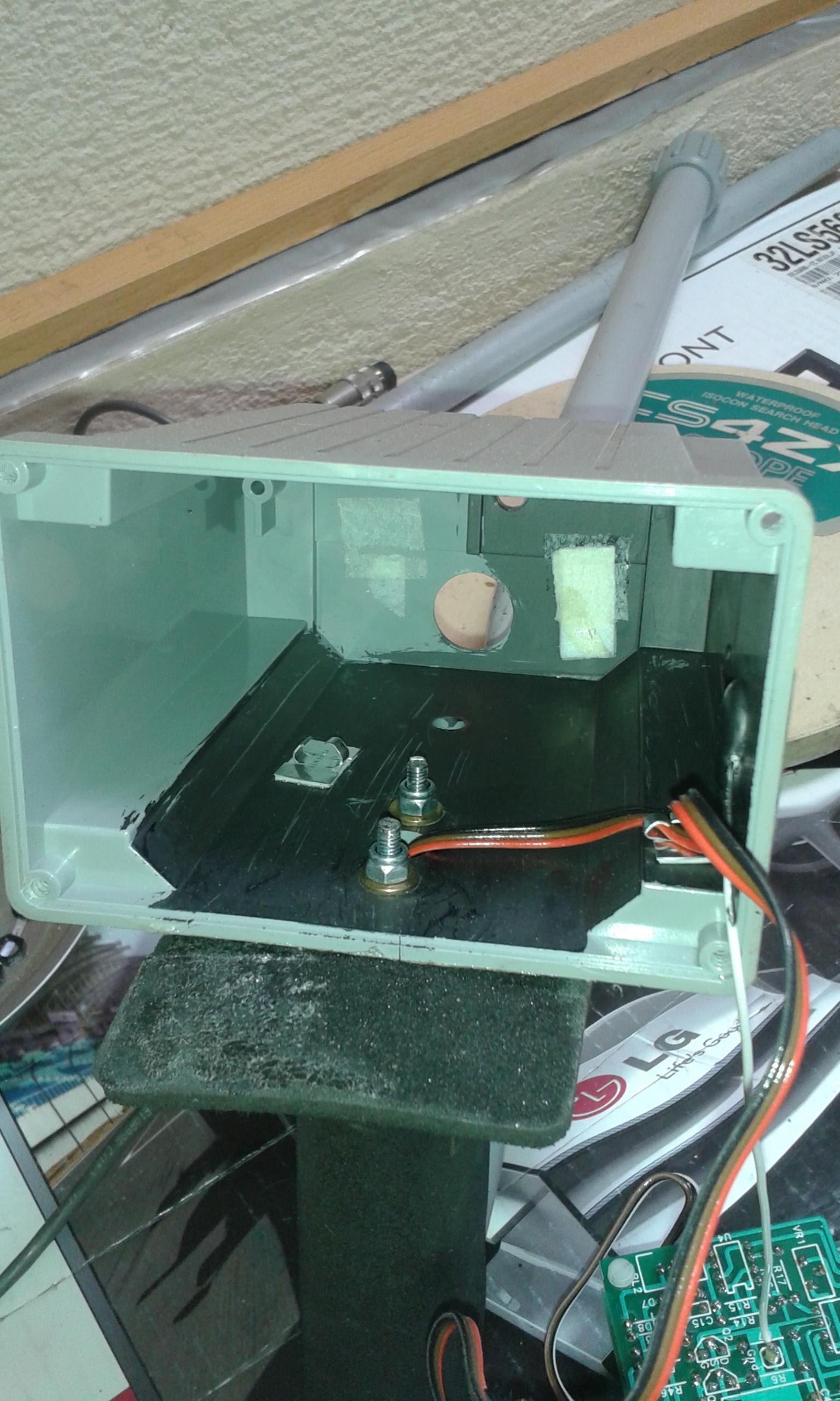

- Electronic looks like new. Interesting the way pots are sealed from the water. They have a rubber piece like a mushroom with a hole in the center for the pot shaft
- Internal part of control box is painted with a graphite paint I think, for shielding. It is connected with the GND of PCBs
Well I am only dismounting the detector. When it will be in separate parts I´ll start to take photographs of PCBs with a camera. They are with serigraphy and components are available to read the values. I think It could be deduced the schematic. But as I have not too much time, I´ll print the PCB photographs and I take notes of the components values over them. Perhaps with more time I´ll paint the schematic starting from this information
For the moment I'll clean and restore the detector, and I'll try no change the alignment pots. I hope it works again
