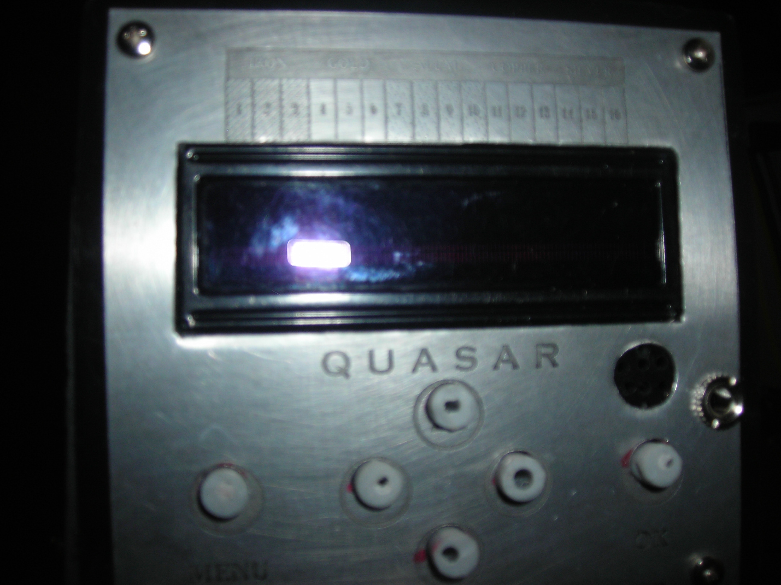

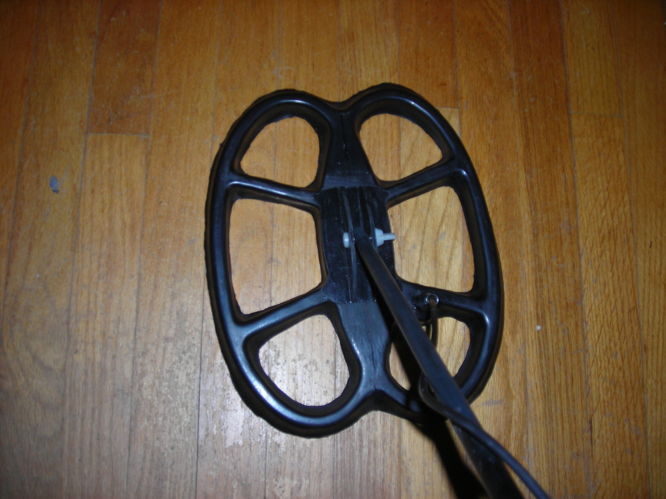

    Here is my latest built metal detector the Quasar Arm designed by Andy Federov. Its my favorite over others I have built including dip Mole, SMT Mole , Golden Saber lite several pulse detectors and IDX.I built a vacuumed formed butterfly coil to use with it Click image for larger version

                    Hi Wiltran, i don't care about your state but i do about your detector.
                    Please, can you explain your assembly (diy board ?) ..
                    Thanks for sharing
                      The difficult part of this detector is building your pcb. I always make my own (photoresist process). To do it right you must make vias (drill small holes.) I used a sprint file from MD4U (Djepsis) because it had the control buttons mounted directly on the board. This board design used a non standard LCD screen, so I rewired it using a header pin socket to use a oled display
                        Hi at all,
                        can you offer some more details about your Coil? I have build the Quasar ARM and it works fine. At the moment my Coil ist only a heap of wire on my table.
                        I wonder how I have to conect the Coil to the Board. Is it important wich wire ending from the Tx and RX Coil comes to the Ground? I mean the winding direktion, (beginning and end of the coil or rotation of the winding)
                          Hi Wiltran,
                          Can you please share your modified layout file here ?
                          I'd like to test the Qasar.
                            Follow the authors original coil and you will have a good working coil. Spend extra time trying to balance the coil.
                            The Sprint layfile I used is found on MD4U Quassr/pcb on around page 15 if I remember correctly.
