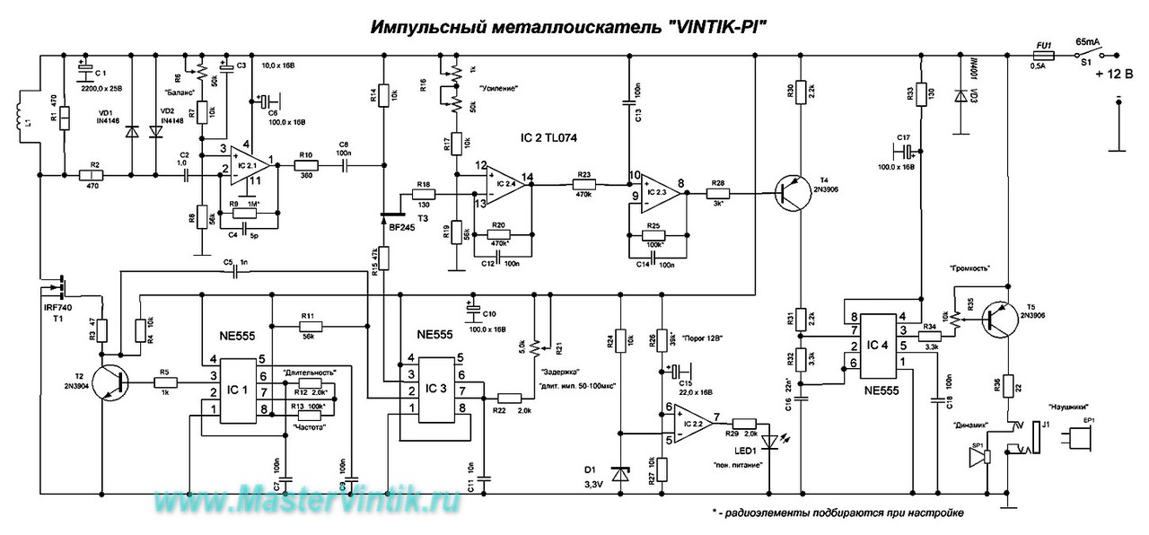

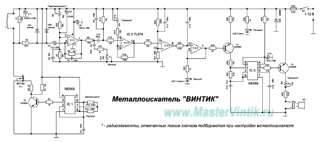

Found this on the net, couple of versions of a single chip PI, interesting concept.
Single chip PI
I was looking at a smd catalog when i found few lines about "DTR" which means
Digital TRansistor. They have built in resistors. Maybe it would be usefull
to use them in a "single chip" project to reduce the componment number..
Does anyone knows somdthing about it ?
A true one-chip solution can be built around an ATtiny85 or ATtiny84 MCU that have an 20x analog amplifier connected to an ADC and timers for configuring the pulses. A digital integrator can be easily implemented in software to provide more gain and noise reduction. A beeper can be implemented with the other timer.
