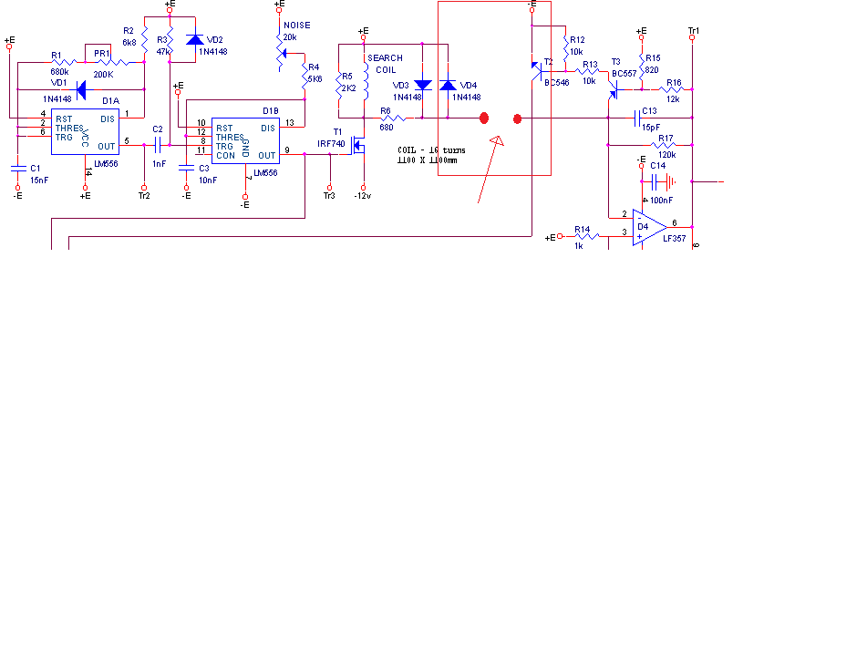

    Καλημέρα. Θέλω να βάλω ένα απομονωμένο στο σημείο που το αποδεικνύει. Αυτό γίνεται με μετασχηματιστή [ATTACH] 40189 [/ ATTACH]

        Good morning. I want to put an isolated one to the point where it proves it. This is done with a transformer
        Greek Transalate English
          Thanks arionas

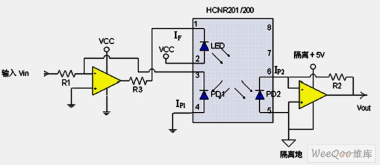

            I want to be out the points l have shown in red l think to do it with a transformer or with one optocoupler ,you can help to make one transformer ,or if there is analog optocoupler.
              I can use it hcnr 200. ???
                What is an hcnr 200. ?
                  HCNR200 and HCNR201 High-Linearity Analog Optocouplers Avago Tecnologies
                    It's a analog optocouplers .

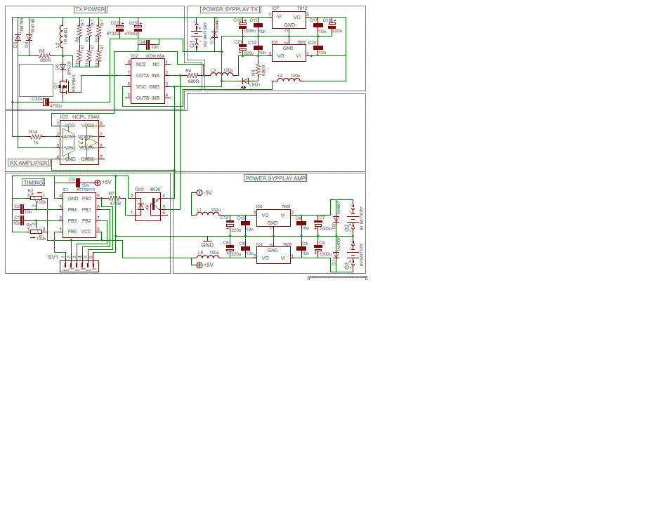

                      You know someone here a new counterpart hpcl 7840 .I need a newer item .for HPCL 7840 .. it covers me but it is very old and is now manufactured by a manufacturer at an expensive cost. And I upload its pdf datasheets.hcpl-7840-000e-datasheet.pdf
                        Can the administrator correct my title from helpsG.S in helps g.s for gsm1.I design my own pi And I want to publish it here for discussion and to help me or the magicians here to implement it.Thanks

                            Good evening in this forum I owe the knowledge I have learned for detectors pi and thank you,I have them now need much more to help me materialize this crazy project with three batteries.
                            please your friends which have a simulator to help for mistakes that may exist in materials or in error in the schematic.
                            enclose pdf
