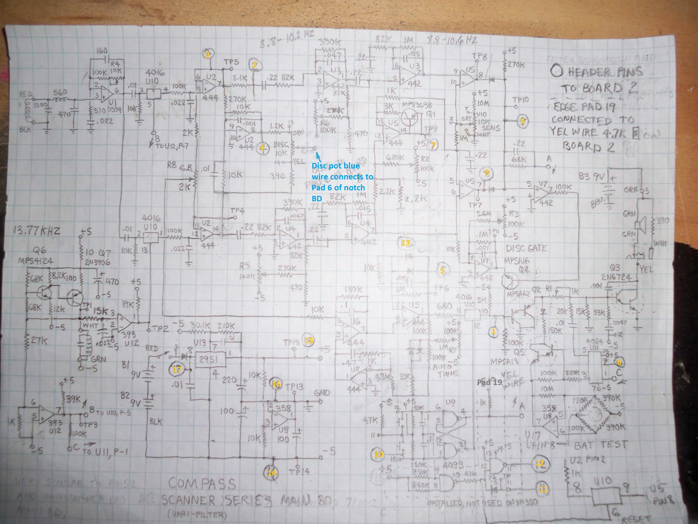

    A lot of people have been asking for this Compass information which until now has only been held by a few hoarders. I will have a component location diagram and bottom board schematic which includes the interface header connections latter.

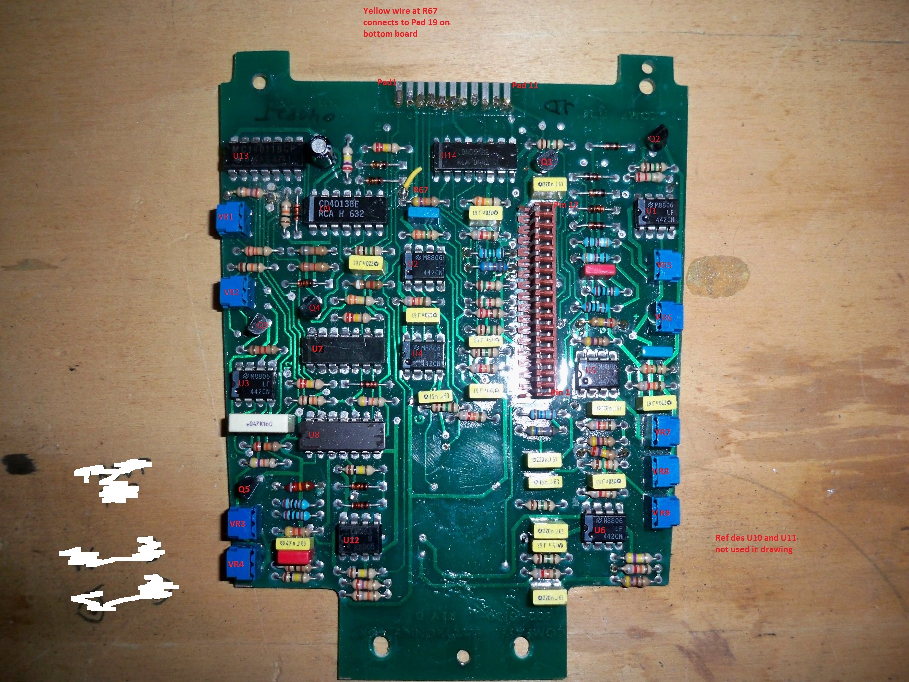

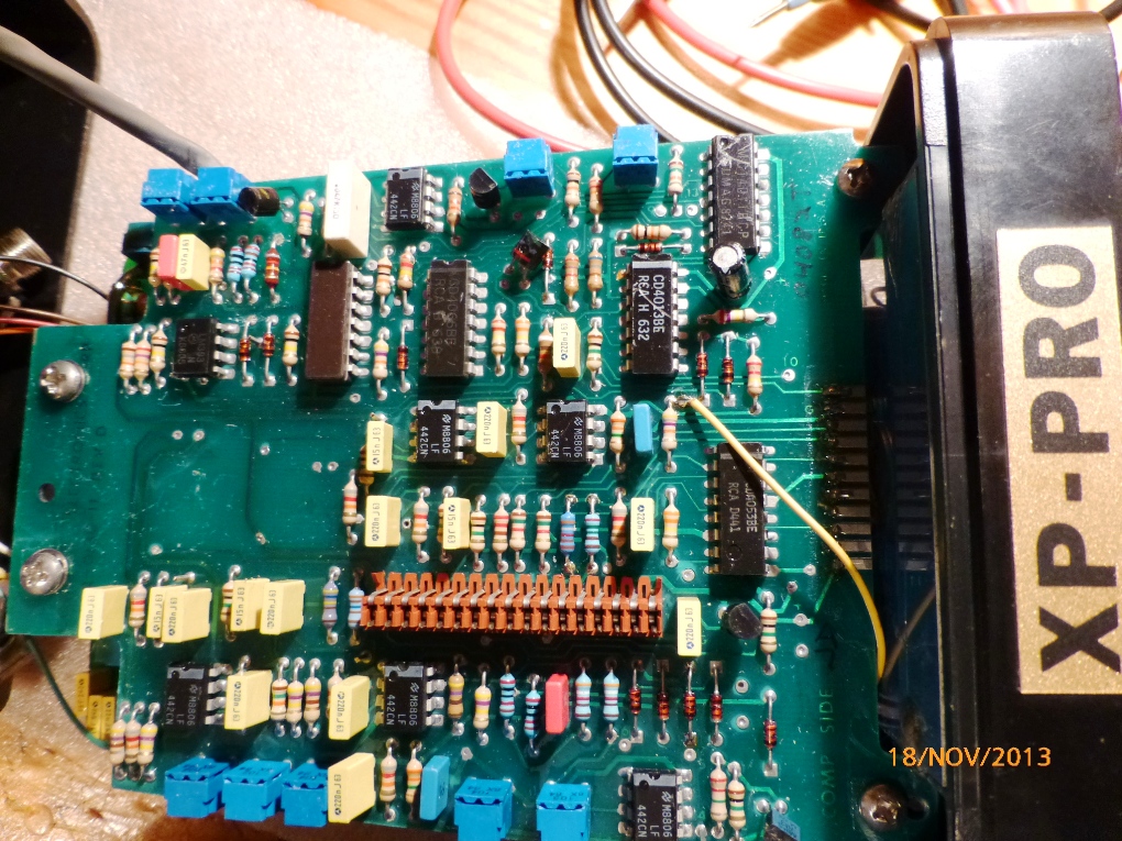

      Additional location and interconnect info

      Also pin 4 of U8 should connect to -5V and I did not use a ref des U10 or U11 in the drawing, late design review on my part. On the units with this board the center wire from the Disc pot is connected to Pad 6 where either it or a pre-set auto notch resistor pair R6 and R7 is selected by U14. R49 and R50 are also a pre-set pair selected in place of the notch pot by U14 in auto notch mode. The unmarked pad at R67 is connected to the main board edge Pad 19 by a yellow wire.

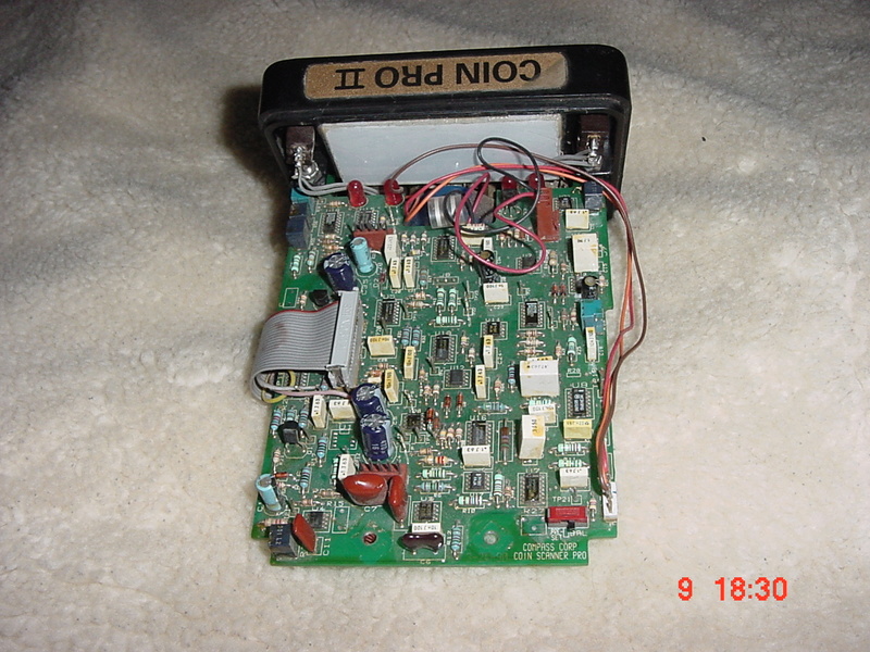

        coin scanner pro and coin scanner pro II done in SMD while your board is not in SMD. so this is not
        gold scanner pro either coin scanner pro. its XP-PRO.
          This is the 2 board design by John Earl used in Compass Scanner XP-Pro and Gold Scanner Pro. The XP-350 uses the bottom board only and the Xp-450 has the top board but only the notch section is populated. All of the Vari filter models except the Liberties use these boards. This is not the George Pane SMD model that is similar to a bounty hunter, there is a big difference although they look similar on the outside. The George Payne model used 8 AA batteries but the Vari-Filter models use 3-9volt batteries.
            I have a Compass Scanner Coin Master II and it has one printed tile, using 8 AA batteries, it was made in SMD technology.

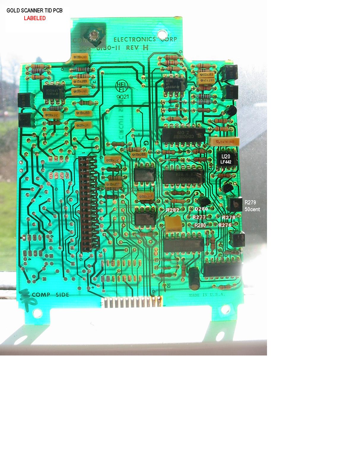

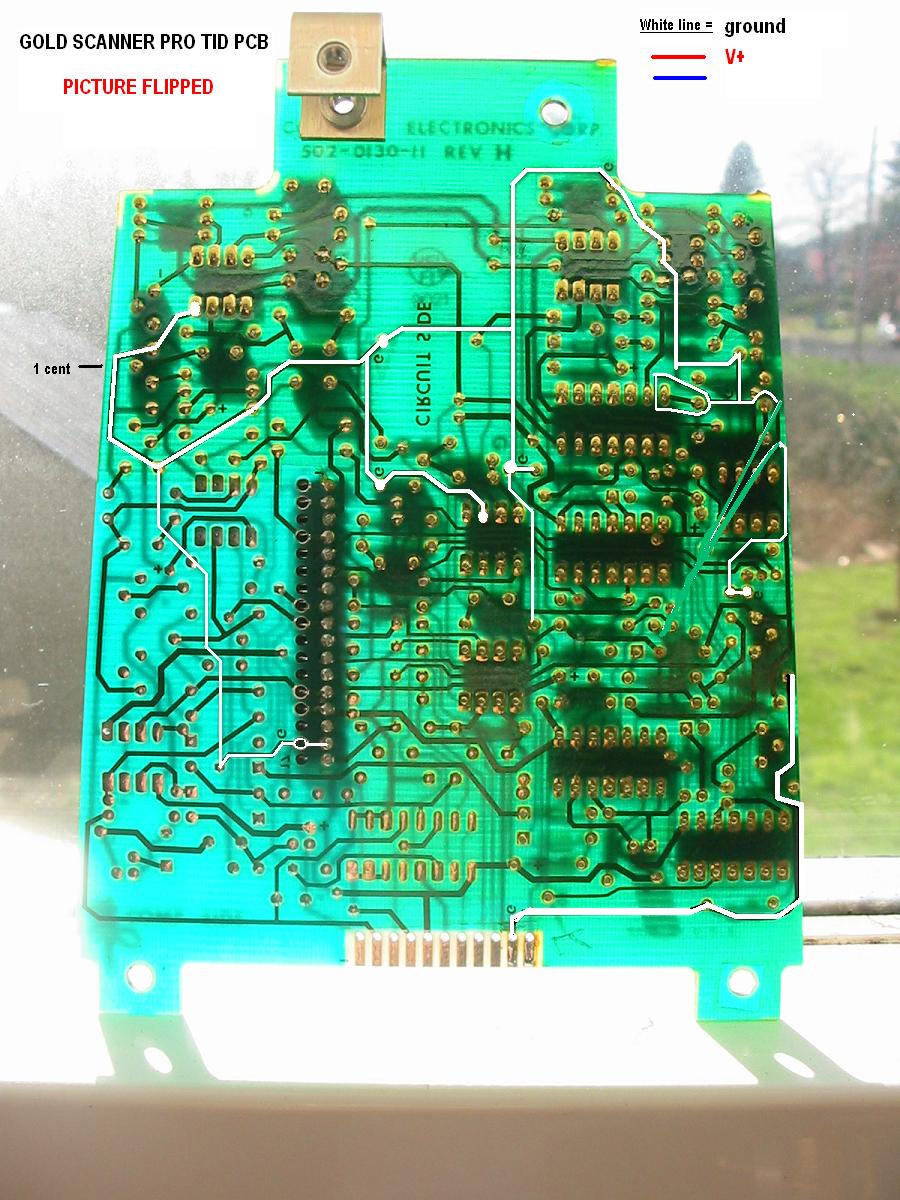

                KT, CRNi1............ you guys are talking about a different animal as David had mentioned. The Drawing David is sharing is of the original Scanner versions. Not George Paynes Coin scanner series. They are utterly different entirely.

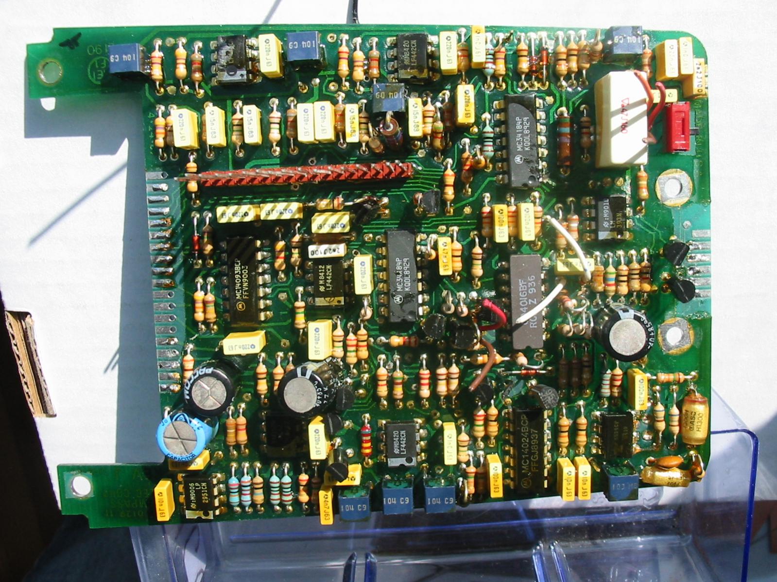

                Here is a photo of the Original John Earle Scanner Top PCB (TID) for comparison with your GPayne coin scanner machine. I'll find a picture of the bottom PCB and post later.

                IMPORTANT: please disregard the component designators on the photo, they are private designators and not from the Factory or Davids drawing.

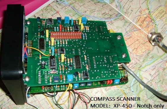

                  For further comparison here is the top board of the John Earle Scanner Model: XP-450 with notch as the only additional feature above the stock scanner circuit. This photo identifies the notch components for you.

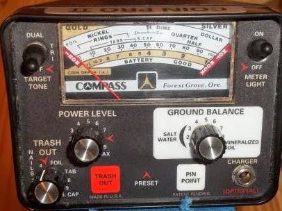

                    TB, i see only pics of pcb. i need full pictures with face panel plus board to sure believe you. and why you mention XP-450 while we do not say about 450?

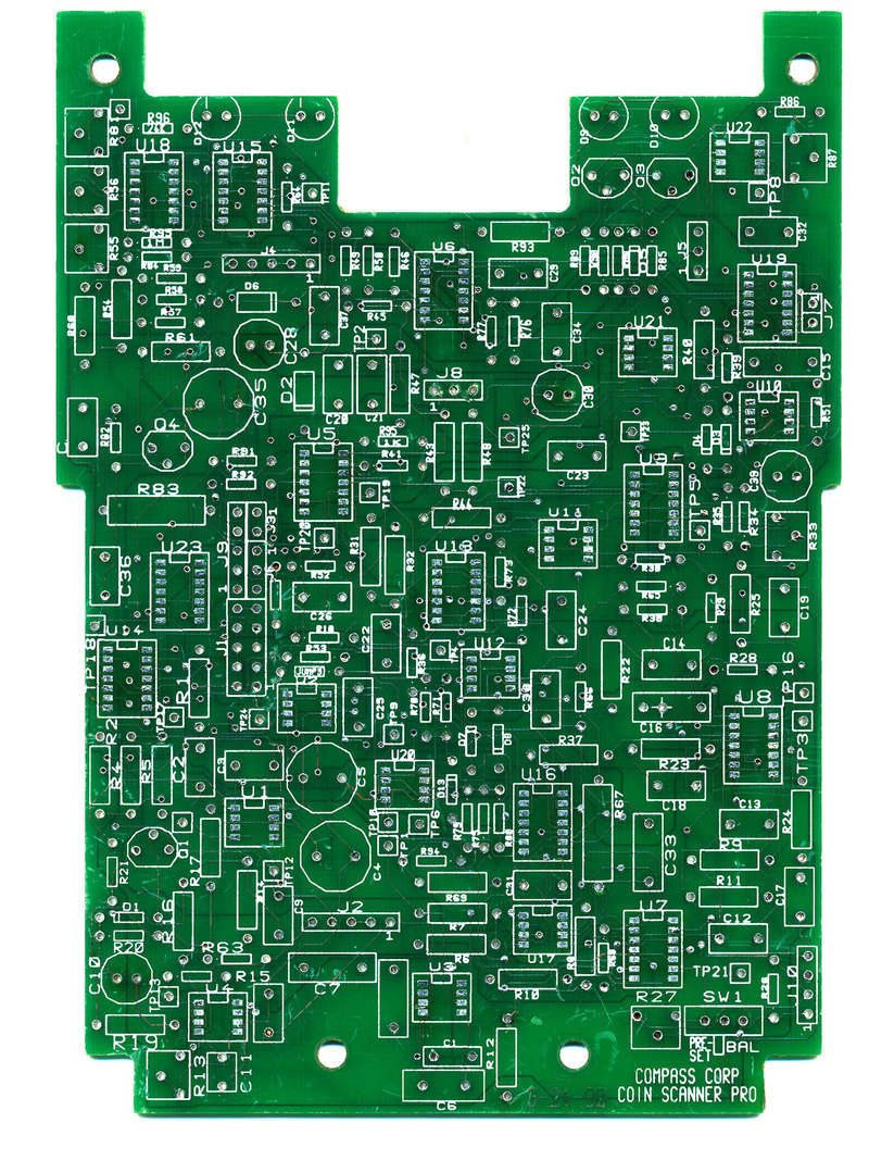

                    like only example what i mean - attach
                      The Compass Coin Pro II Is nothing more than a Bounty Hunter Big Bud modified a little and operating on 13.77khz instead of 6.5khz. This is why that model is so unstable in mineralized ground. The old JE versions with the vari-filter are very stable in mineralized ground. Totally different detector.

                        I only bring up the XP-450 because it also is the same board as the one David is sharing info on. I also am just trying to help by showing the components that make up the Notch Circuit, and because it was the only picture I had available at the moment to share of the Compass Scanner TID PCB.
