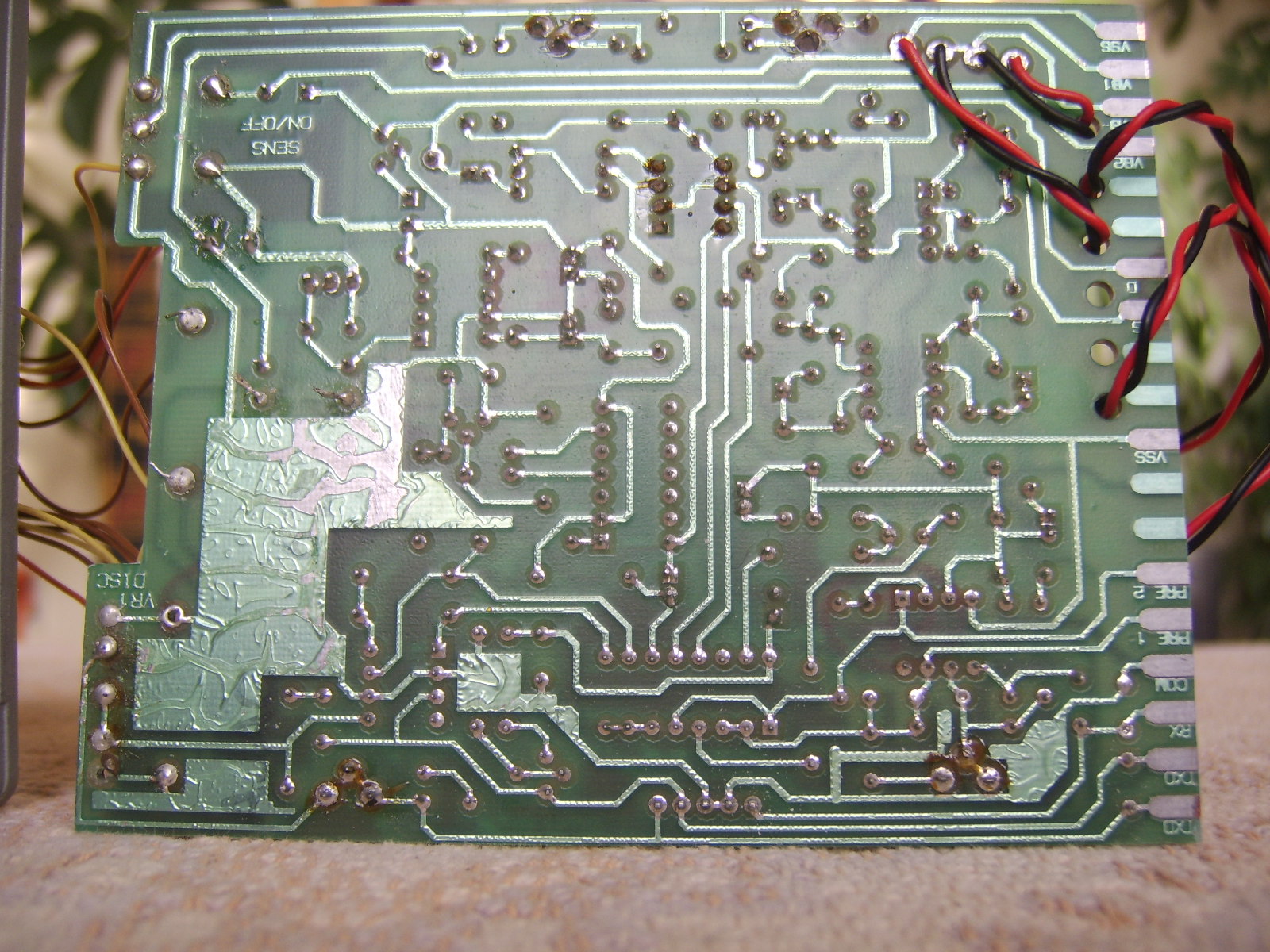

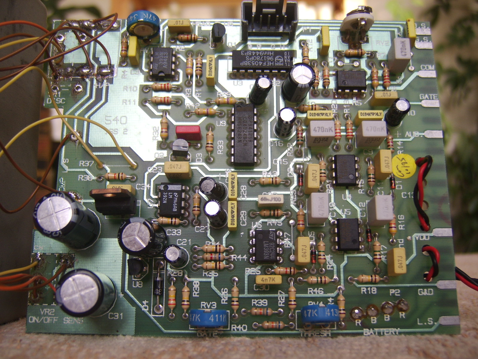

          it seems you need to make new board. i see marks of incorrect coarse repair or try of to mod.
          its general problem - low qualification of the people in soldering and electronics repair.
            The original silkscreen should give you a guide as to what it was before bodge job.

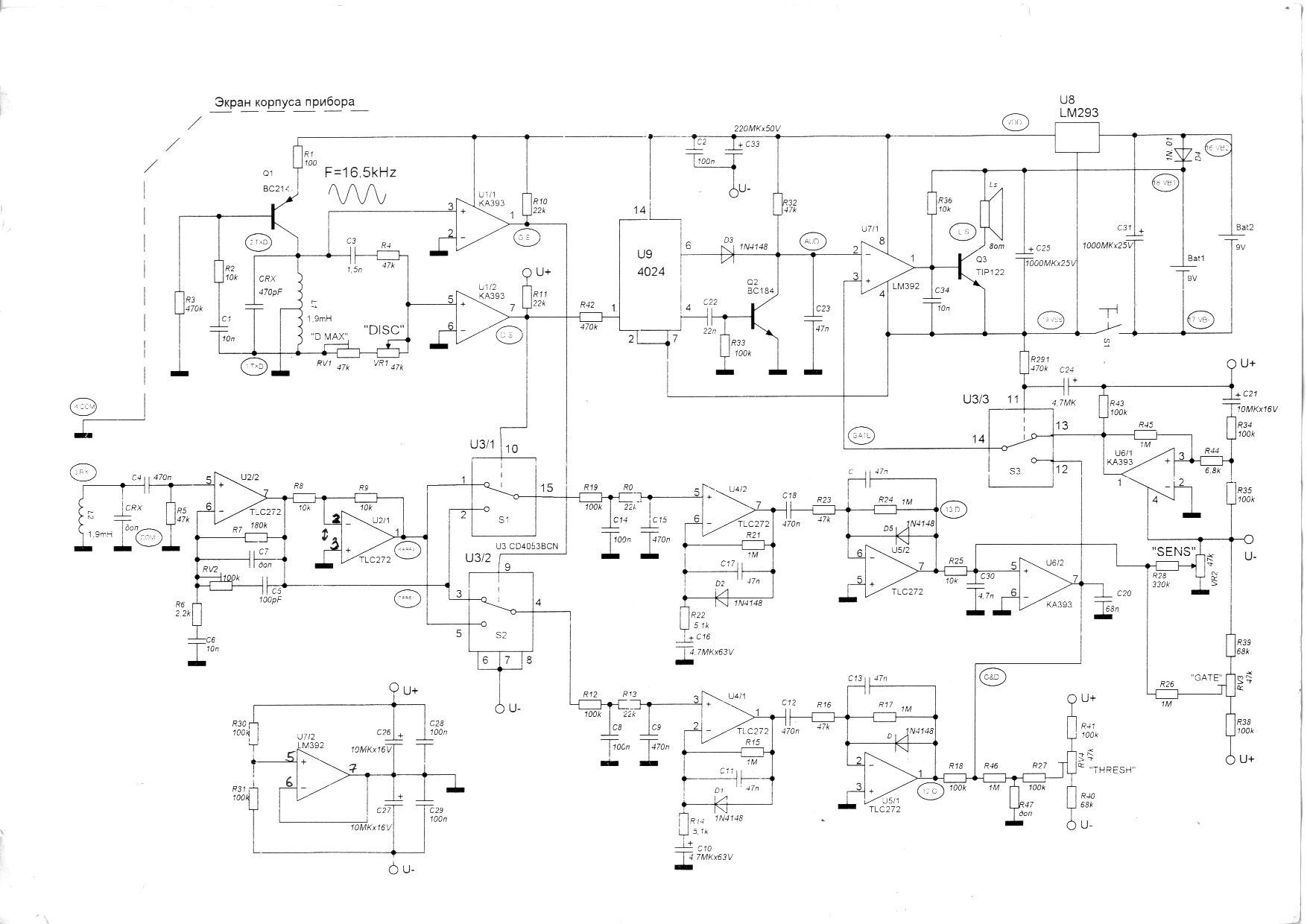

              Think I found C scope CS2M schematic. It matches the components on the board.
                Yes, it is definitely cs2m schem.

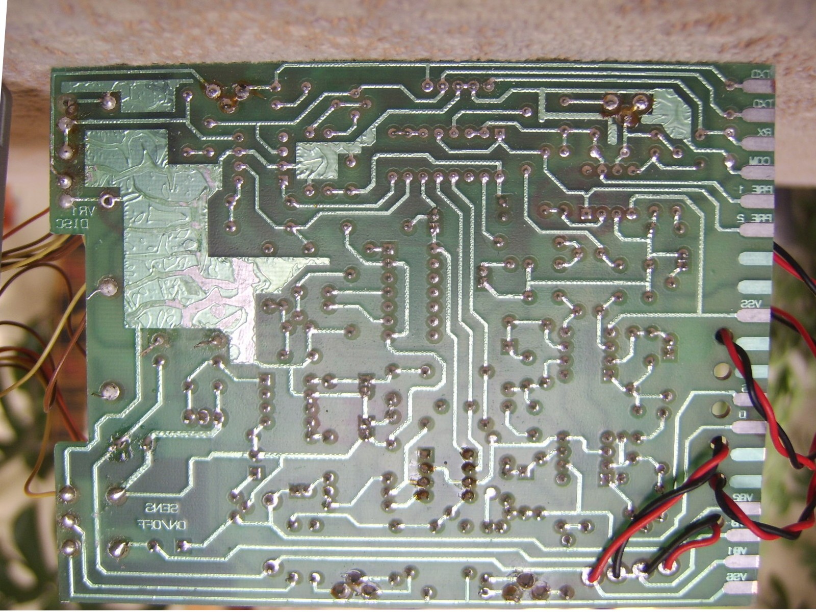

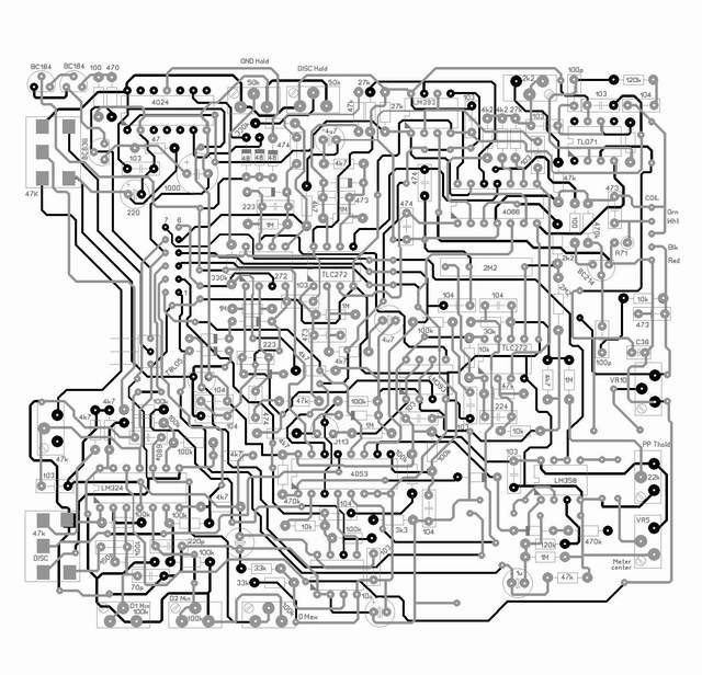

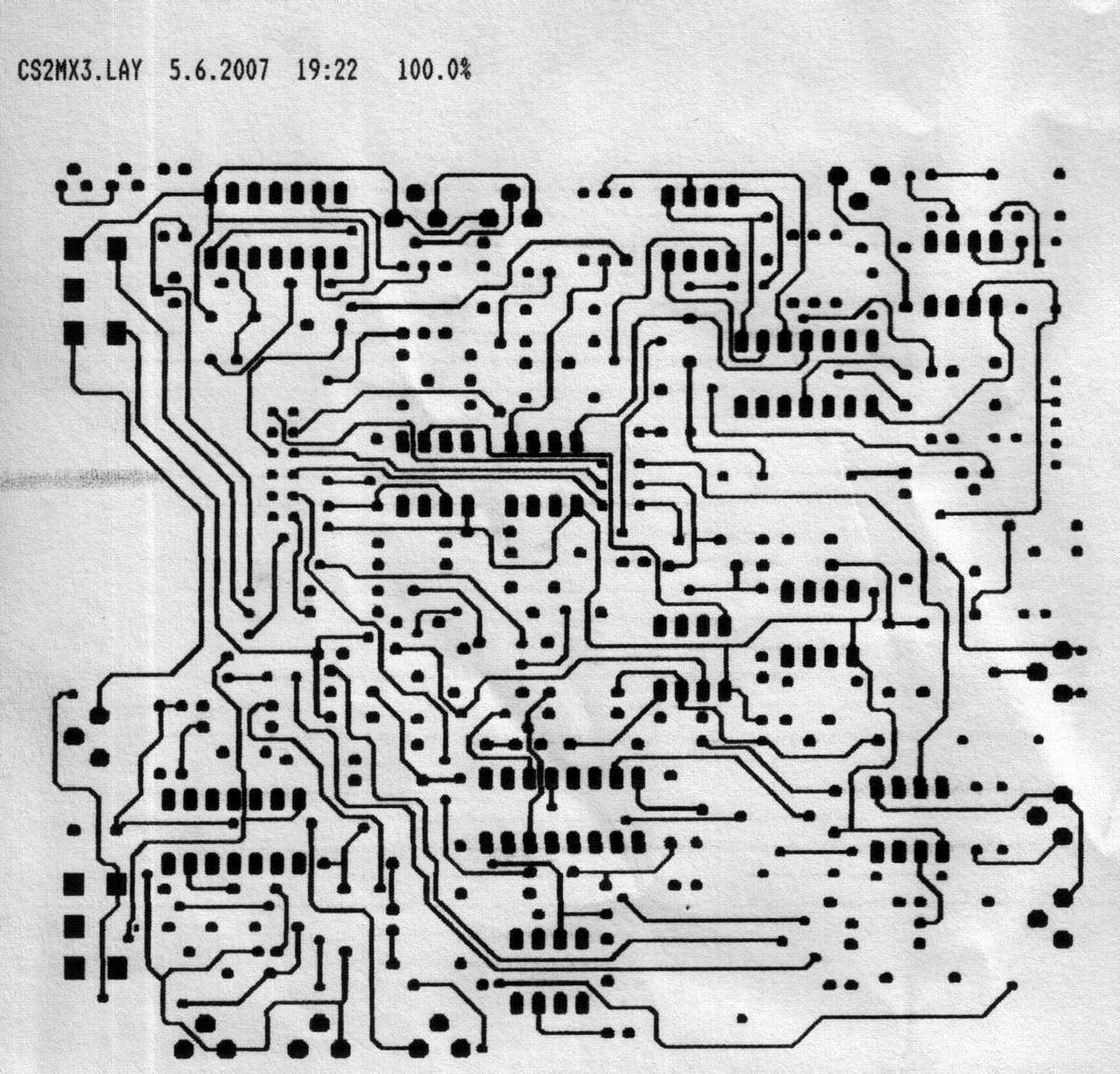

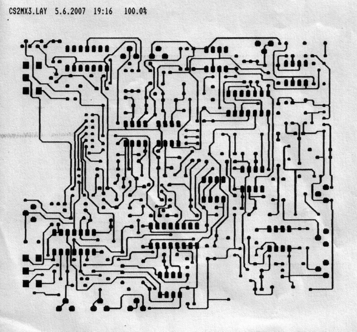

                    Some work in progress, who wants to finish top layer is welcome. The schematic is posted in thread #21

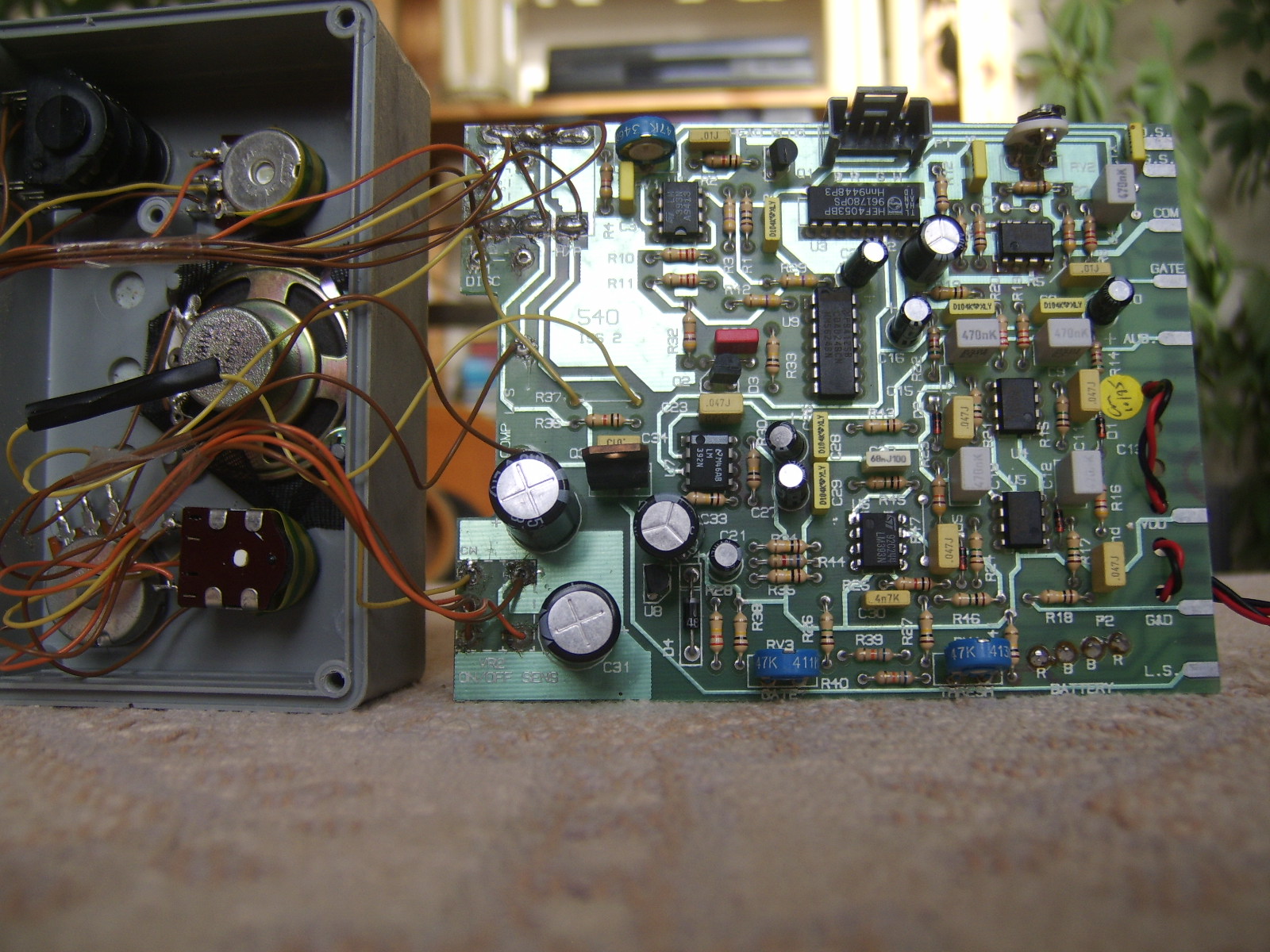

                          Please , board information for cscope cs2m
                            Please see attachment.
                            The board I'm tracing is for CS1/CS2M and not MX. This schematic attached matches the board component for component. Even the component names match!
                              Here are board pics for CS2M. The schematic is correct, at least so far i haven't found any errors.
                                Please help me to complete the top layer. I already finished bottom layer.
