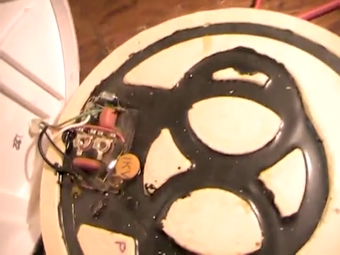

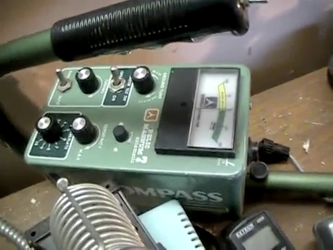

            Can someone please help me to identify this Compass Relic Magnum coil? https://www.youtube.com/watch?v=dT0v_YfTIbY
            What type of coil configuration is this, double omega maybe? I don't know.
              Dbanner,
              I live in a secluded forest area, so I only have access to the internet through an old telephone line, using USB dial up modem. Thus I cannot obtain sufficient bandwidth to view anything on Youtube. If you can, post the photo of the coil here, so I can actually see the coil.
              But I know the Relic Magnum product completely. You did not actually tell me the full Relic Magnum model number or name, but I know them from the first RM machine to the last RM machine. I can answer it accurately and completely. It has been answered below...
              If it has a white coil, with black decal lettering, is an Axial coil, which they patented.
              If it has a colored decal, it is a Concentric coil, which was the last coil they put on it before they quit selling the Relic Magnum models. The Concentric coil will go 1-1/2 to 2 inches deeper then the Axial coil. Whites Electronics made Omega coils. From your guess here, I am guessing it is the Axial coil you are describing.
              Now if it is one of the small gold prospecting coils, it is an Axial, despite any markings or names on the coil.
              Melbeta
                The video is titled relic magnum 7A
                  Dbanner

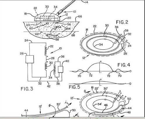

                  The description I gave you was for the RM7a model, as it was the most popular and the last of the RM series models. Your first photo is of the RM7a. Now the second photo, shows the inside of the stock coil, which I called an Axial coil, but Compass called it a Co-Planar coil. Now the reason I called it a Axial is due to the graphic which is in the patent. But as you look at the drawing graphic, you can see in one drawing it looks like an Axial, anther drawing it looks more like a co-planar coil, and in another drawing it kind of looks like a concentric coil.
                  Now as I have never seen the innards of the Axial coil, your photo could be it, and perhaps is a home made variation coil that someone make up inside the case of the Axial coil. I do not know for sure. Carl or Qiaozhi will have to wade in on this one It sure as heck looks more like the Nexus coil inside, doesn't it? I can only tell you what they made for the RM7a, not what any of the coils look like other then the concentric, which I have seen inside it... I guess flip a coin. Or buy it and see how it works for you.
                  The RM7a is a VLF for all metal mode, but the discrimination is not VLF motion unit, but a TR discriminator. Which is why the Coin Magnum, which came out the same time of the RM7a is VLF and VLF Disc.
                  Here is the Abstract description:
                  A unitary balanced-inductor system for use in the search head of an electronic metal detector, having a transmit coil, a smaller, preferably concentric cancel coil of opposite polarity, and a yet smaller receive coil inductively decoupled from the combined transmit and cancel coils. The cancel coil preferably has a smaller number of turns and is located in a slightly higher plane than is the transmit coil, while the receive coil may be placed in a slightly lower plane than the transmit coil, to provide adequate sensitivity to the presence of conductive or magnetic objects separated from the search head without unacceptably high sensitivity to similar objects relatively close to the search head. A closed loop load coil located between portions of the transmit coil and the cancel coil may be used to provide an inductive load on the transmit coil thereby further reducing the sensitivity of the search head to targets in close proximity to the load coil. The graphic drawing of the coil follows as an photo...
                  Melbeta
Name:	Axial Coil layout.jpg
                    Well that's very interesting. I did read the patent with the axial coil layout photo you posted. I was expecting to see such a layout inside the coil in video of relic magnum 7A, but was a little surprised to see what appears to be twin TX cancel coils instead of single concentric cancel coil. The RX coil looks as it is described in diagram. This is likely a variation on the axial coil layout in patent. It's the only coil I've seen made up like this. I also notice trimmers(presets) on coil pcb, no doubt for inductive balancing.
                    I sure would like to see a schematic of coil circuit for this one(including small pcb). Looks very unique indeed.
                      Small correction, the trimmers on small board are not for "inductive balancing" as I previously stated. But for fine balancing (nulling).
                        I can make a good guess. When Compass was testing their detectors, they made up different main boards, sent them out to service centers, who tested them, switched out to another board, tested that one, and so on. I imagine they also tested various kinds of coils as well.
                        The inside fine tune board, was a common board, they differed slightly in different kinds of coils, was used to set the nulling I believe. Compass was very innovative company. They had a smaller service center in a dealers shop in Pennsylvania, and he switched out and tested many board variations. As I understand it, the DD coil they built went the deepest, then the Concentric coil, and the last was that Axial coil.
                        But the gold prospecting smaller coils, all were of that Axial kind, and they were pretty hot coils. They had to be set up on the detector, by some internal adjustments.
                        Melbeta
                          Some day I hope to experiment with this type of coil design. Thanks again for tremendous information. One more thing, I found a schematic that purports to be the RELIC MAGNUM 6. From your knowledge, was this a reasonably good detector, similar to the 7A in performance?
                            There were differences between early to late RM6 models..........
                            Early RM6 had smaller meter, later RM6 had larger better meter. Some RM6 did not have the coil coax connectors, were hard wired to the motherboard. If I ordered two coils, then each coil had its own connector and could be removed and switched. Other then that, it is standard RM6 machine. It has what it has.
                            RM6 is smaller brother to larger RM7a (a=automatic) model. It was reasonably good but RM7a was far superior. Compass used the RM6 and the RM7A to check out various board changes for the Coin Magnum final unit. They ran the field tests for 3 years I believe I was told. You might end up with such of those machines. I have no way of knowing the test units.
                            I have all of Compass schematics on up and through the Challenger X-100, then beyond it my schematics are hit and miss. But before it I got most of them. Probably not all model versions of course, but have some of them. If you are trying to gain some experience, do what I did, bought them, tested them myself, then decided if I liked a model. If I liked a model, I sold them. If I did not like a model, I could not sell them. That is how I am, just like with food, it has to pass my test first before I eat a second meal. I tell it the way it is. No fake stories from me.
                            I still have a near brand new RM6 stored, for some reason it does not work now, so someday will have to go into it and fix what is wrong, and it will be somewhere from Power Supply and beyond.
