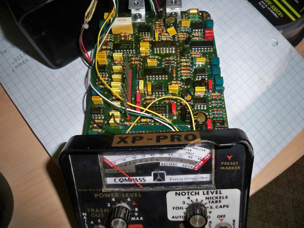

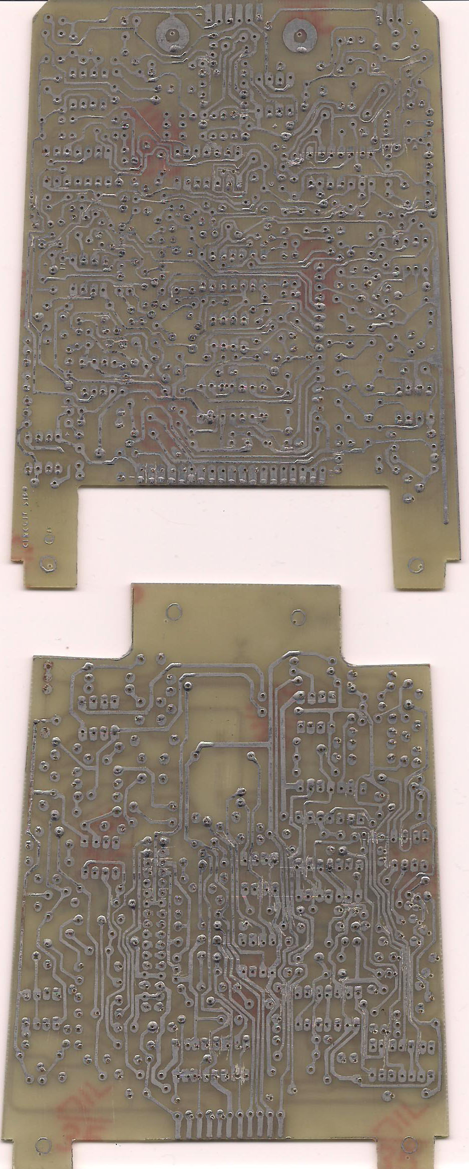

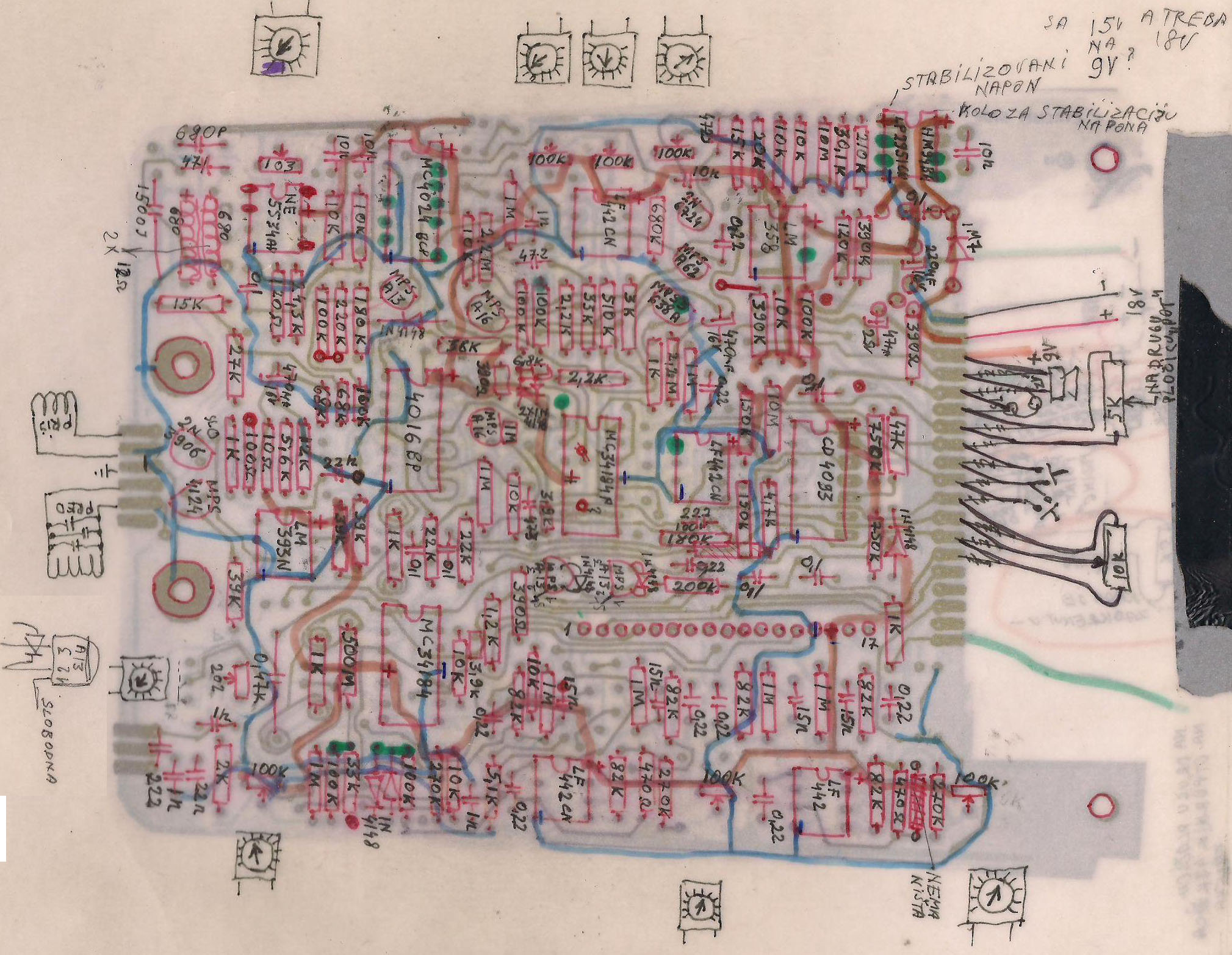

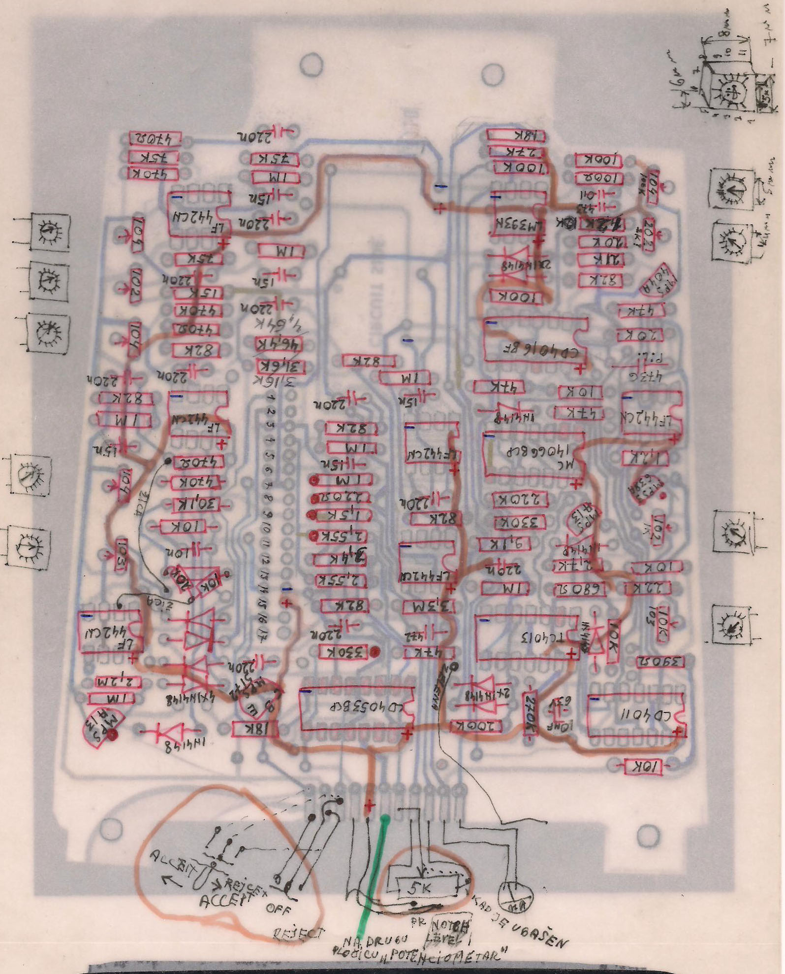

Actual Compass XP-PRO main board rev:F schematic
