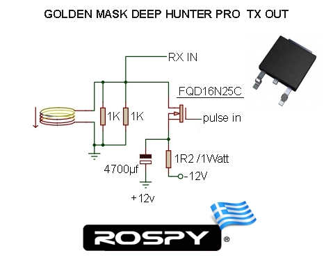

    I need the circuit of Golden Mask Deep Hunter Pro.
    PLEASE HELP
    No one has it. The PCB has epoxy on the lower side and there's a MCU unit so it's not a hobby level - available.
    Only Pro can reverse engineer it and I doubt he will post it freely on the webs and won't be complete w/o the MCU code.
      Yes i know it.I cleared a little bit on pcb and i I designed the tx out.
      This is the corect circuit
      if anyone else has the rest of it
