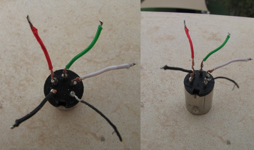

    Sorry for that and i'm afraid you right :-) . That was not expected from me at all, as the info i dig on the net shows the same connection on the DIN as on the screw on type. Now there are two possible reasons:
    1. Either the pin out on the Fishers F2/F4 with push inn is different than on the screw on same model (i read about this too).
    2. The coil which i buy is not for Fisher F2/F4.
    AS i have that bunch of equipment i connect the coil to G2 and... it works. Not much of a dept but at least seems the pin out is right for G2. I measure the resistance and it is around 19 Ohms on both receiver and transmitter. Really puzzled. Will post photo of the coil too. No any markings on it as on my stock BHQS.
      So here the conclusion, which may still need confirmation .

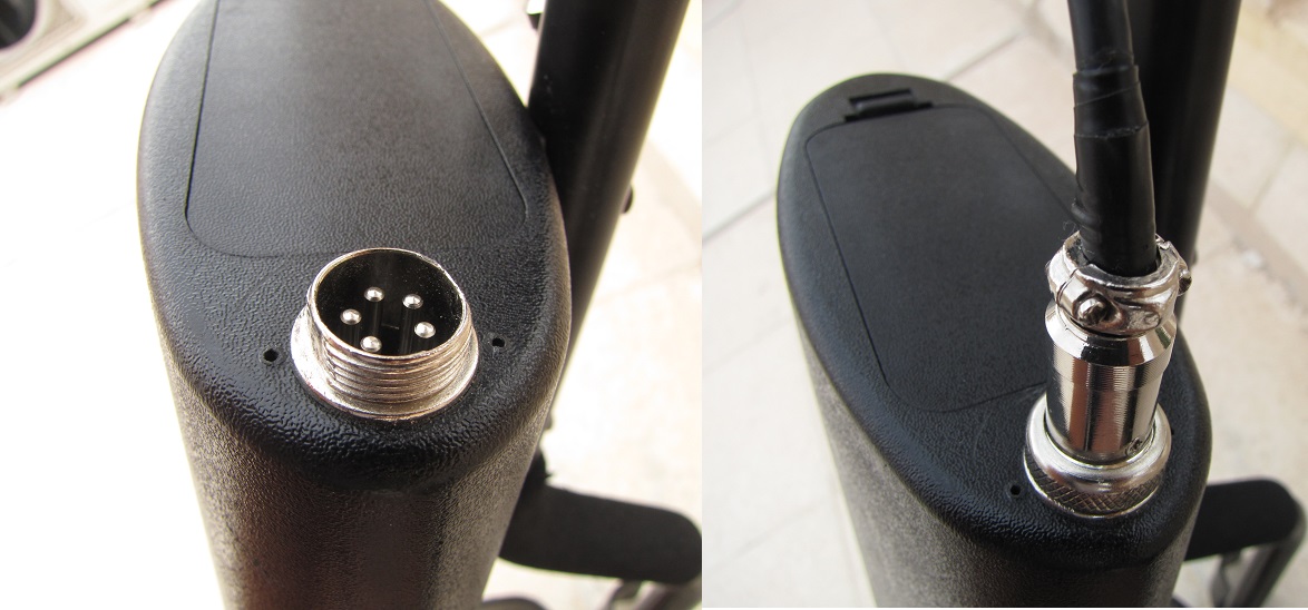

      The pinout of the older f2-f4 coils with push inn connector is the same as Bounty hunters. However the newer f2/f4 coils with screw inn connectors have the reversed pinout(or should i say mirrored?). It may be done on the purpose from the manufacturer, or just cause the screw inn coil cable socket is female, where the control box one is male.The push inns are reverse(male on the coil, female on the box). So i just swap the places of the second and fourth pin and it is working now. Picture will come soon.
        Here the pics of the modded Quick Silver EX
