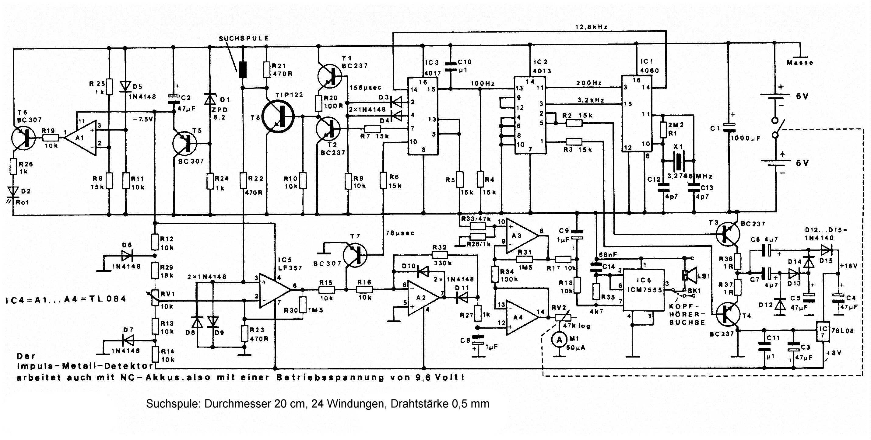

    Hola amigos, ¿alguien realizó el detector llamado Impedet?
    Adjunto los detalles

            i like the look of it "impedet" bears further research any other details ? coil data or full parts list as schematic is missing a couple of details and nomenclature is skewed?
              It's all the bibliography that I have. I can not find more information on the network.What data are missing ?. the coil is a classic for a diameter of 22 cm. 24 wire turns of 0.5 mm. with an inductance of approximately 300 uH.
              Carlos
              Carlos
                Thanks carlos and yes my mistake i had the jpg blown up and couldn't see the a1- a4 in the margin

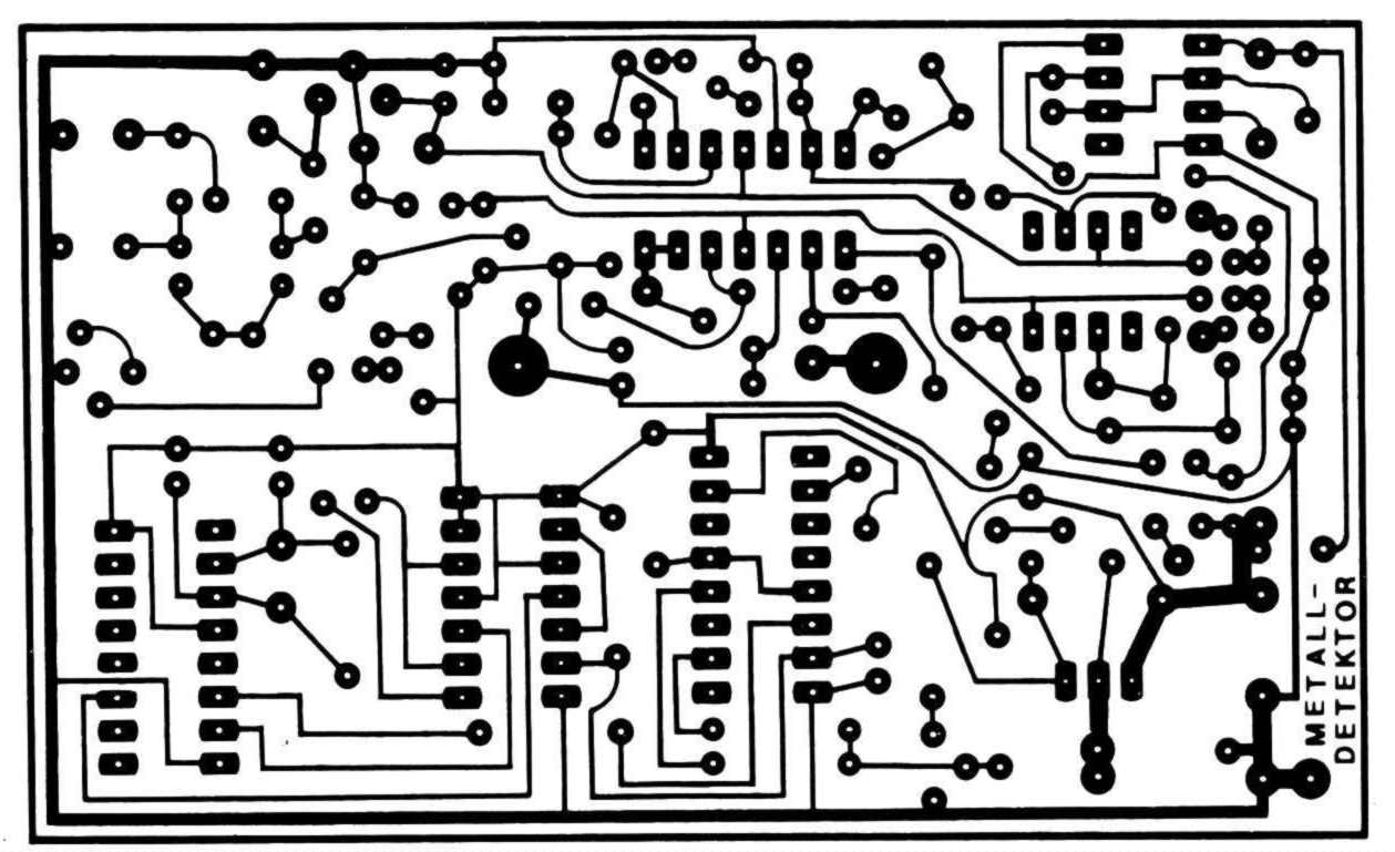

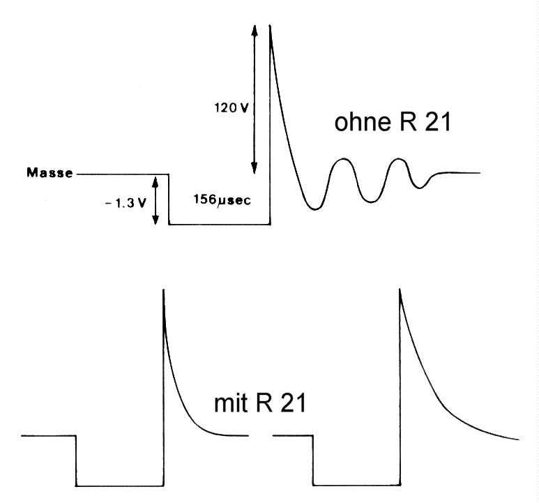

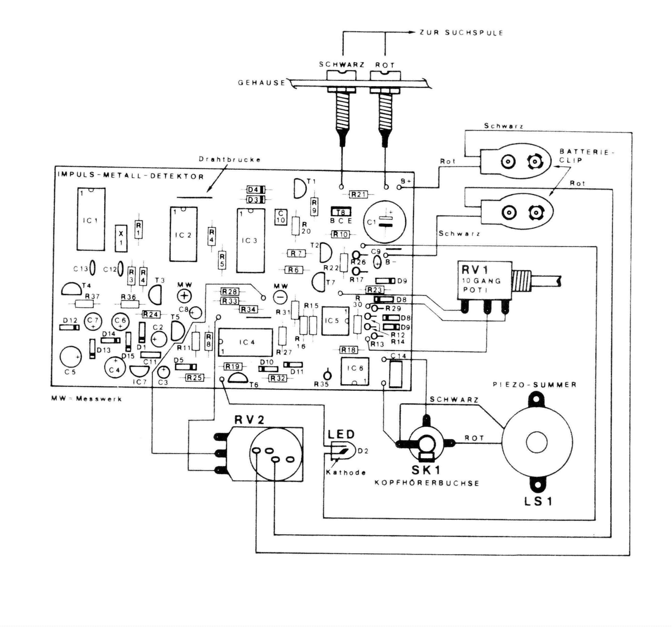

                  Carlos, I think I may have the complete documents for this metal detector.
                  I will search for them and upload if I find them.
                    I like the fact that the circuit uses a commonly available quartz to keep the frequency stable and precise.
                    I think this is nice little circuit to construct.

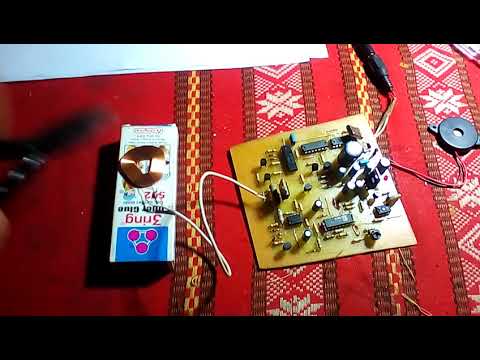

                          Is that the same circuit? Well if it is, I find that the response isn't sharp enough for my liking. Could you say what is the inductance of the coil seen in video?
                            The coil in the video looks very strange
