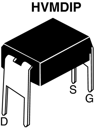

          oh my teeth... i see Eric's board there and as i guessed its certainly his 'c-scope/goldscan SS' design. no more 'a secret of The Wizard of Oz'.
            its a very small compact design
              i had wrote Eric does just two design in your life -
              1. with 300uH coil
              2. with 1mH coil
              we see here 2 point. so its c-scope 6PI schematic.
                hi kt....i remeber some years ago seeing a photo of the c-scope 6pi...it looked very impressive....i would imagine the head hunter uses the 1mh coil cause of using two pp3 batteries as the coil would have 3 times the resistance.
                  look on the photo of board. mosfet is irfd113 in DIP4 case. loving by Eric mosfet type. this is clear sign of c-scope 6pi and 1mH coil.
                  like the Eric's signature 'here was Eric'.
                  no secret here.
                    ive never used a irfd113 mosfet as always used TO 220 case type...i guess it makes sense Eric using a lower power type in the CS 6 pi and head hunter...maybe i will try and make a low power pulse detector over the winter and try and get it very light weight...most of the projects ive done apart from one have all been on the heavy side and arm killers
