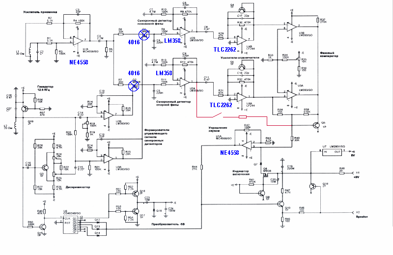

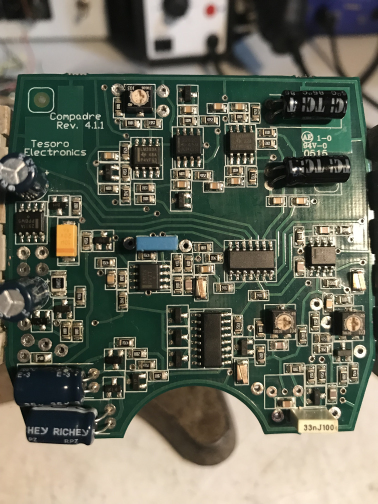

Tesoro Compadre Schematic PCB Rev 4.1.1
i do not see differ-s 4.1 vs 4.11. may be you guys see something? http://ipic.su/img/img7/fs/Untitled-1.1542222085.jpg
The only thing that looks different is some of the PCB tracks.Originally posted by kt315 View Posti do not see differ-s 4.1 vs 4.11. may be you guys see something? http://ipic.su/img/img7/fs/Untitled-1.1542222085.jpg
Since the version change is from 4.1 to 4.11, this implies that any changes are only cosmetic.

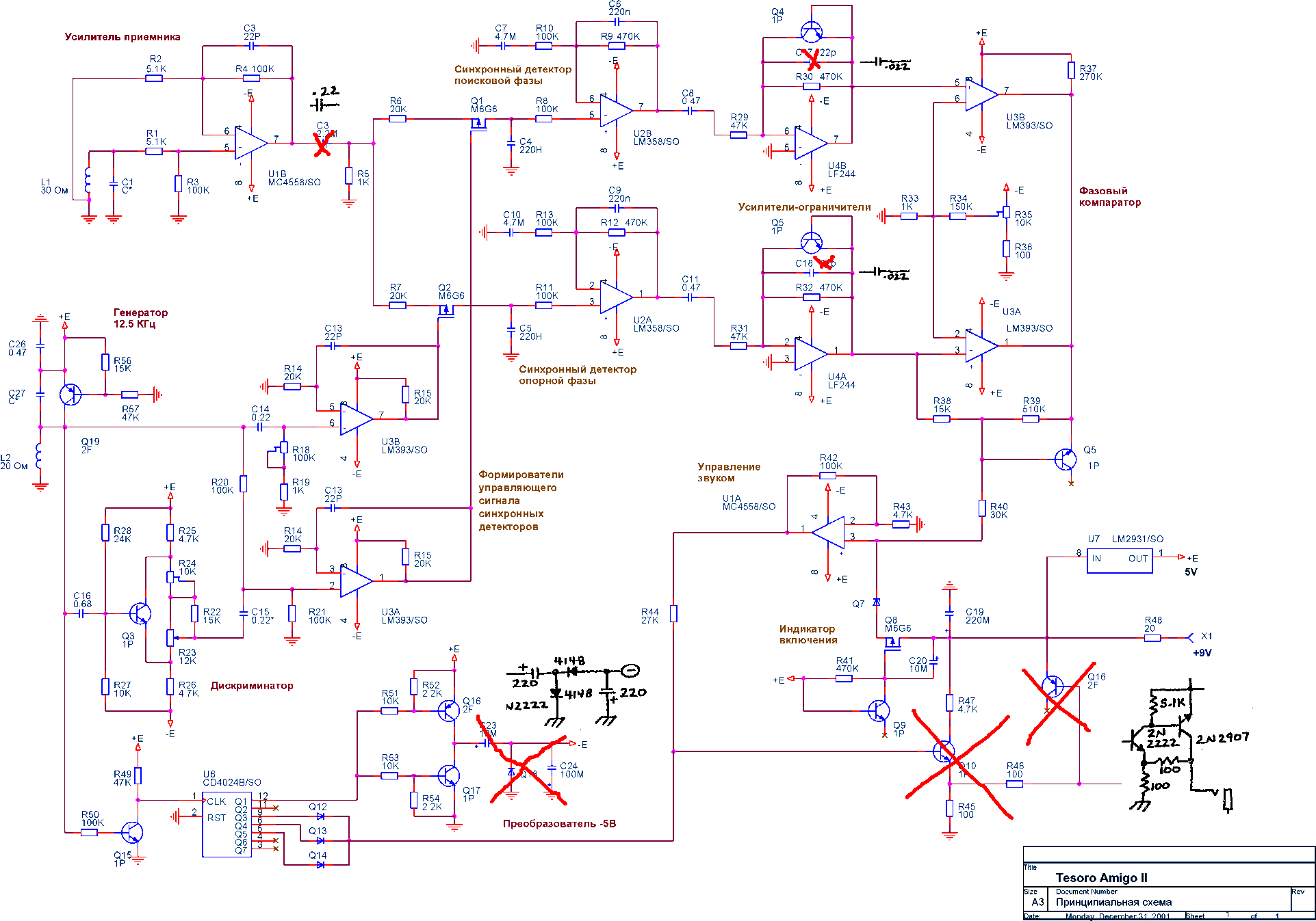

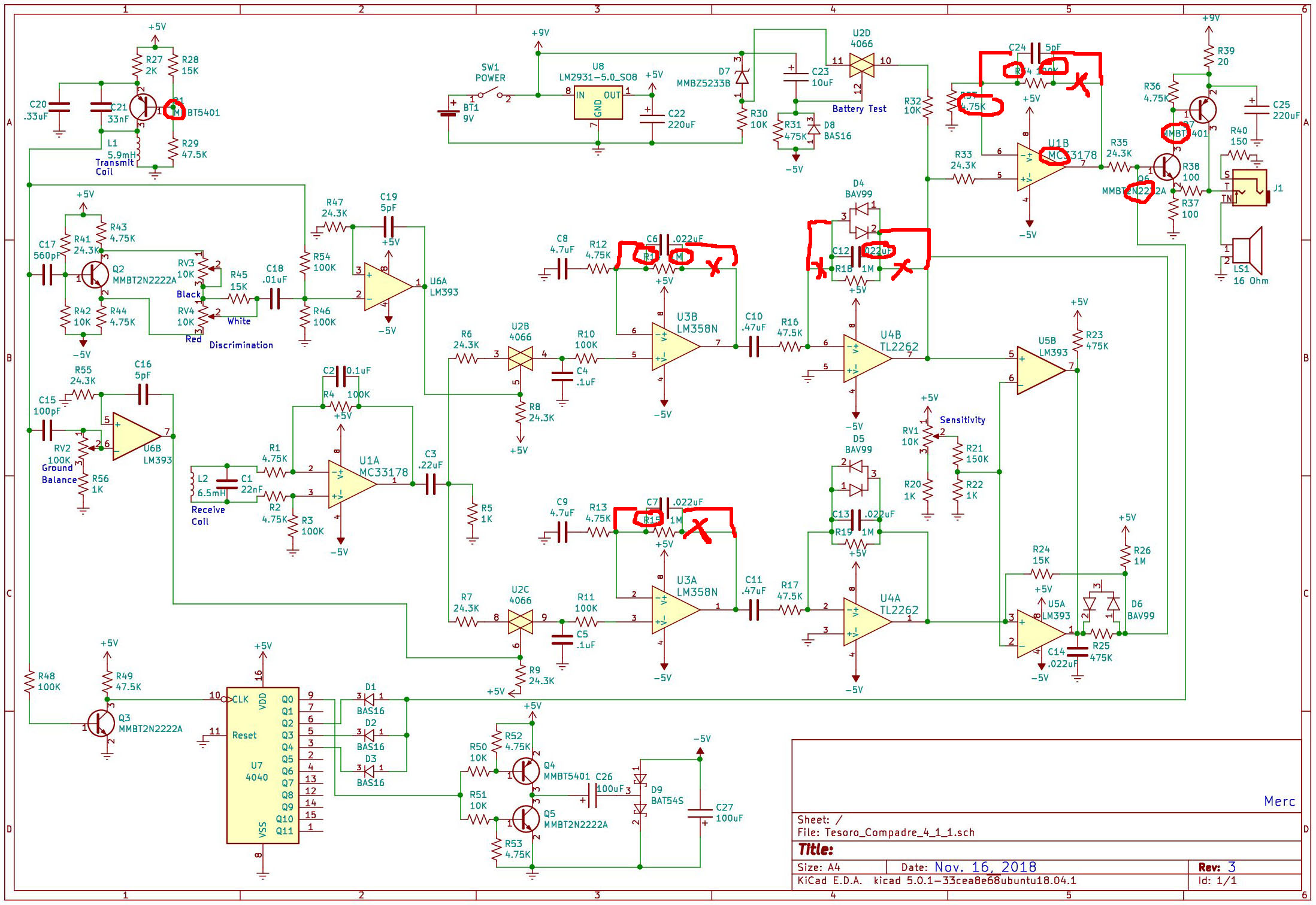

I have found and corrected two mistakes so far. One with the value for C20 in the transmit oscillator, the other was R54 missing near U6A. Still going over it. Here is Rev 2.
MercAttached Files
More errors fixed. Value of R48 (base of Q3). Location of R5 (at U1A output). Location of R36 (Q7Base/Emitter).

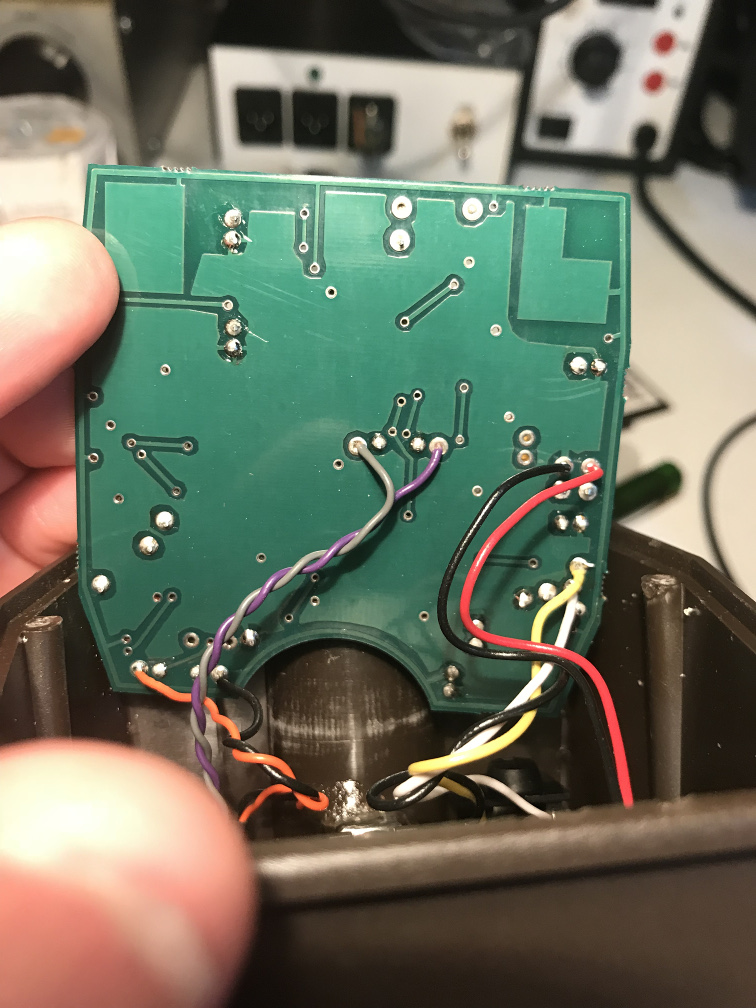

Here is the back of the PCB. If you need a shot that is more straight, it will have to wait until I disconnect all wires once again. I am currently testing it.
MercAttached Files
