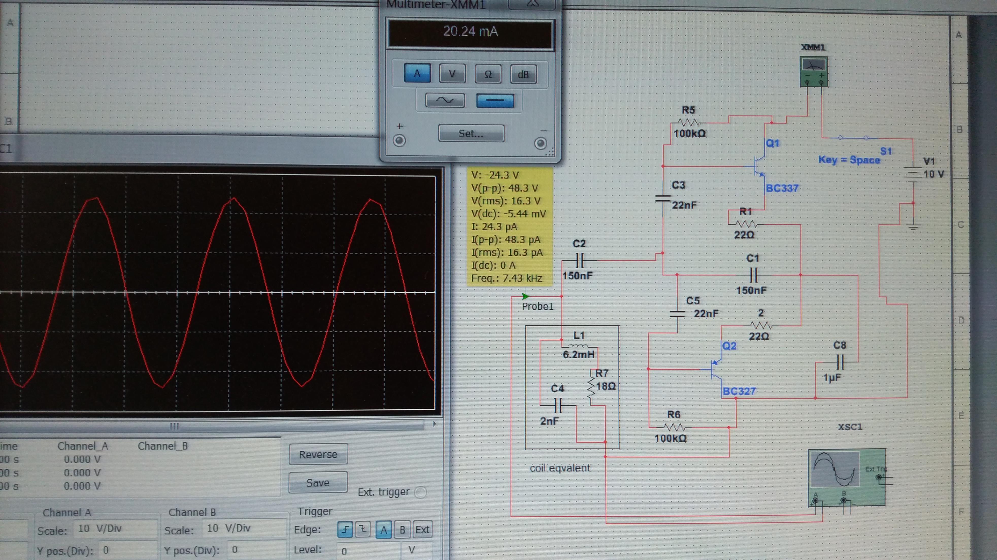

    Perfect working oscillator. Tested. Click image for larger version

    Nothing is ever PERFECT ! LOL

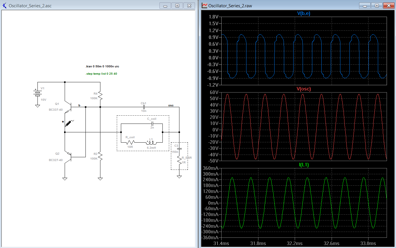

      For this oscillator is we can say.Do it and make sure.
        Improved variant.Click image for larger version
          Originally posted by scs View Post
          Improved variant.[ATTACH]46515[/ATTACH]
          Now it's even more perfect

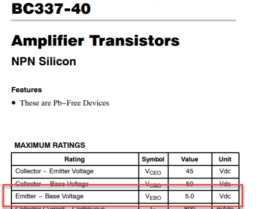

                This "perfect" and "improved" oscillator will destroy the transistors by applying a reverse Vbe voltage of 20V. Maximum is 5V.

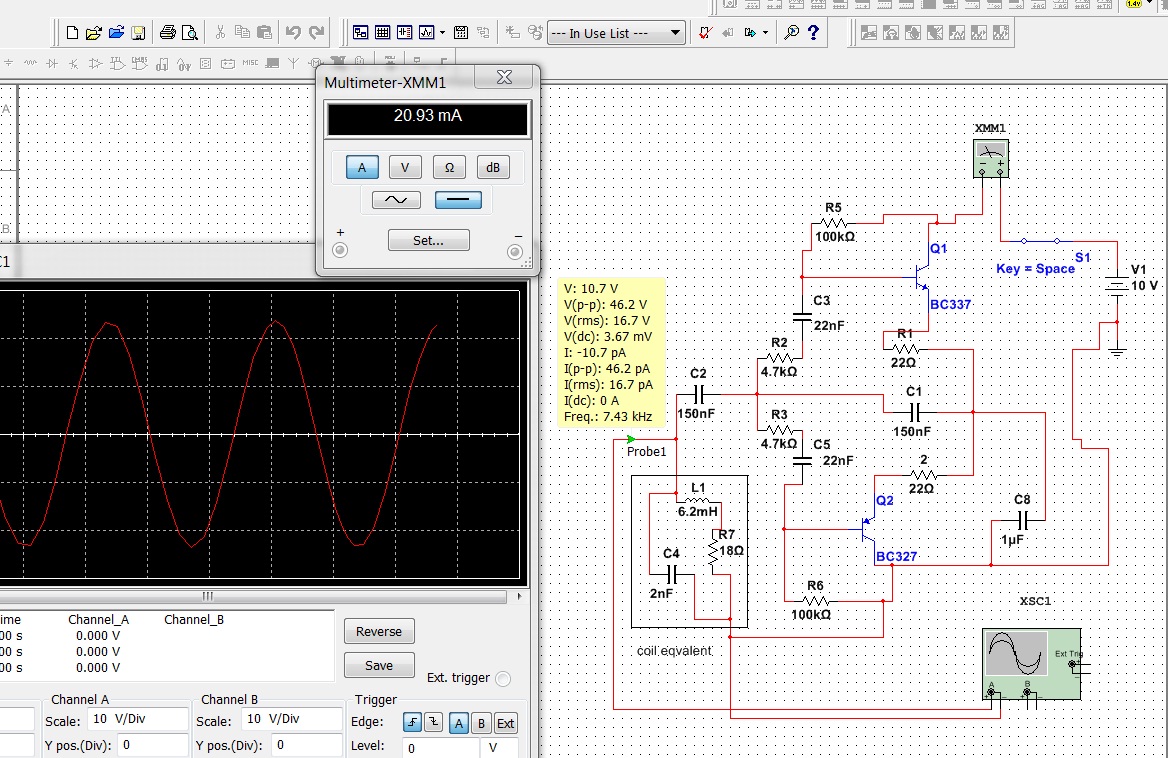

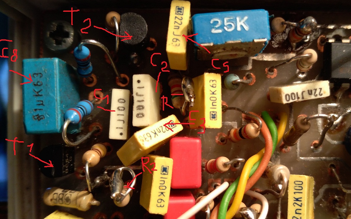

                  The schematic is part of a detector that works.C2=C1=100nf.C8= 1uf.L=9mH,DD coil.F= 7.5Khz. I do not want to deal with empty heads.Click image for larger version
                    Dear Teleno,
                    You need to know that the transistor breaks through the current created by reverse voltage. In the circuit this current is small. You can use for toilet paper your diploma.
                      The schematic is part of a detector that works.C2=C1=100nf.C8= 1uf.L=9mH,DD coil.F= 7.5Khz. I do not want to deal with empty heads.[ATTACH]46520[/ATTACH]
                      It works. For a while. The current gain of the transistors will quickly deteriorate.
                      Congratulations for this clever design!
                      By the way, the PCB is just as neat as the schematic.
                        The gain is current enough, the circuit starts working even at very low current on the transistors base.
                          The current gain is enough, the circuit starts working even at very low current on the transistors base.

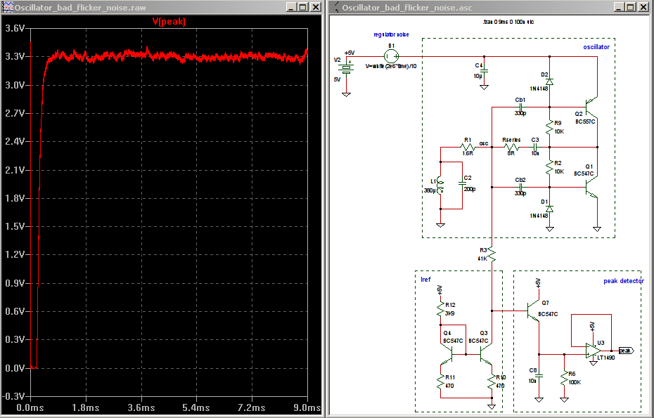

                            Try this. Simpler, more powerful, low Veb.
                              Not more powerful,Q factor is very high.
