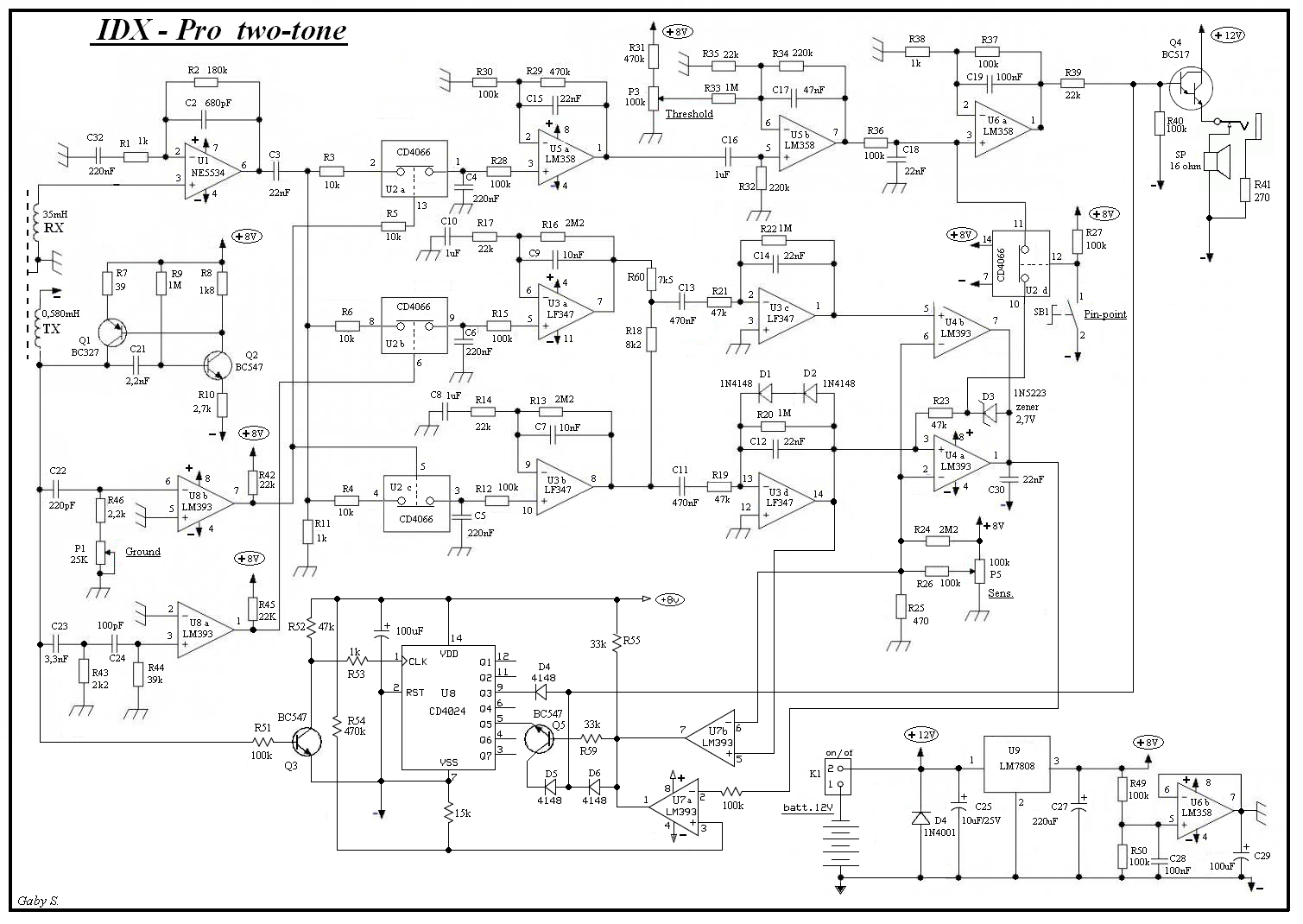

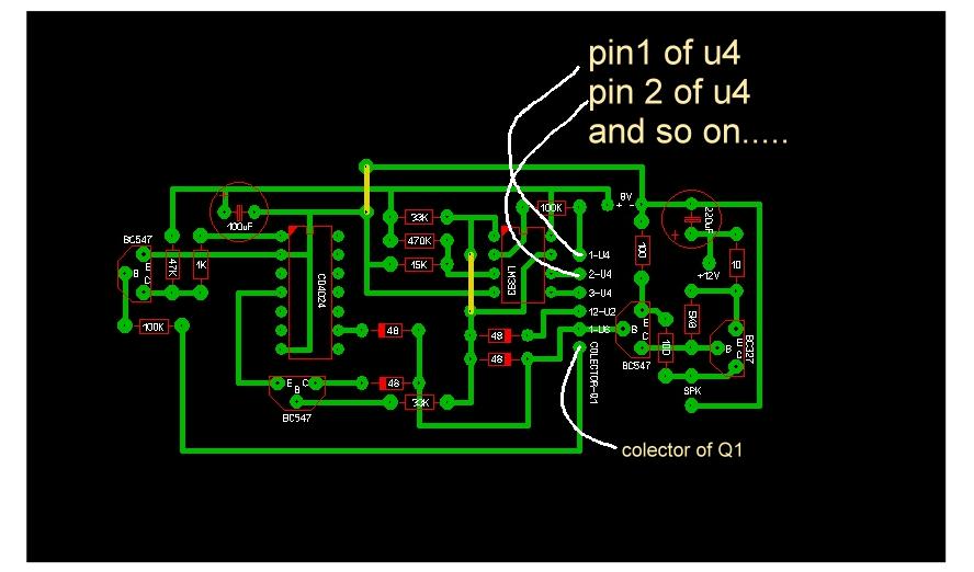

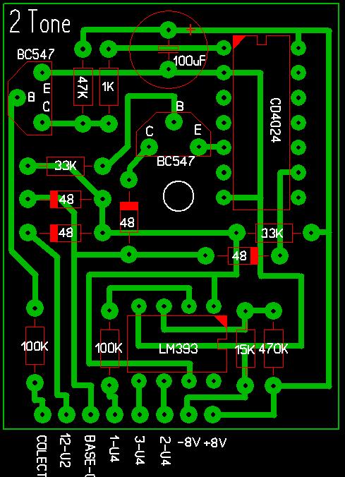

Hi. I did these consoles, it works poorly.Originally posted by Tony60 View PostHello friends, I kindly ask you an opinion of which is the best between the two schemes audio 2 tones for IDX Pro that you see in attacked.
Thanks and good MD at all.
Tony60.
