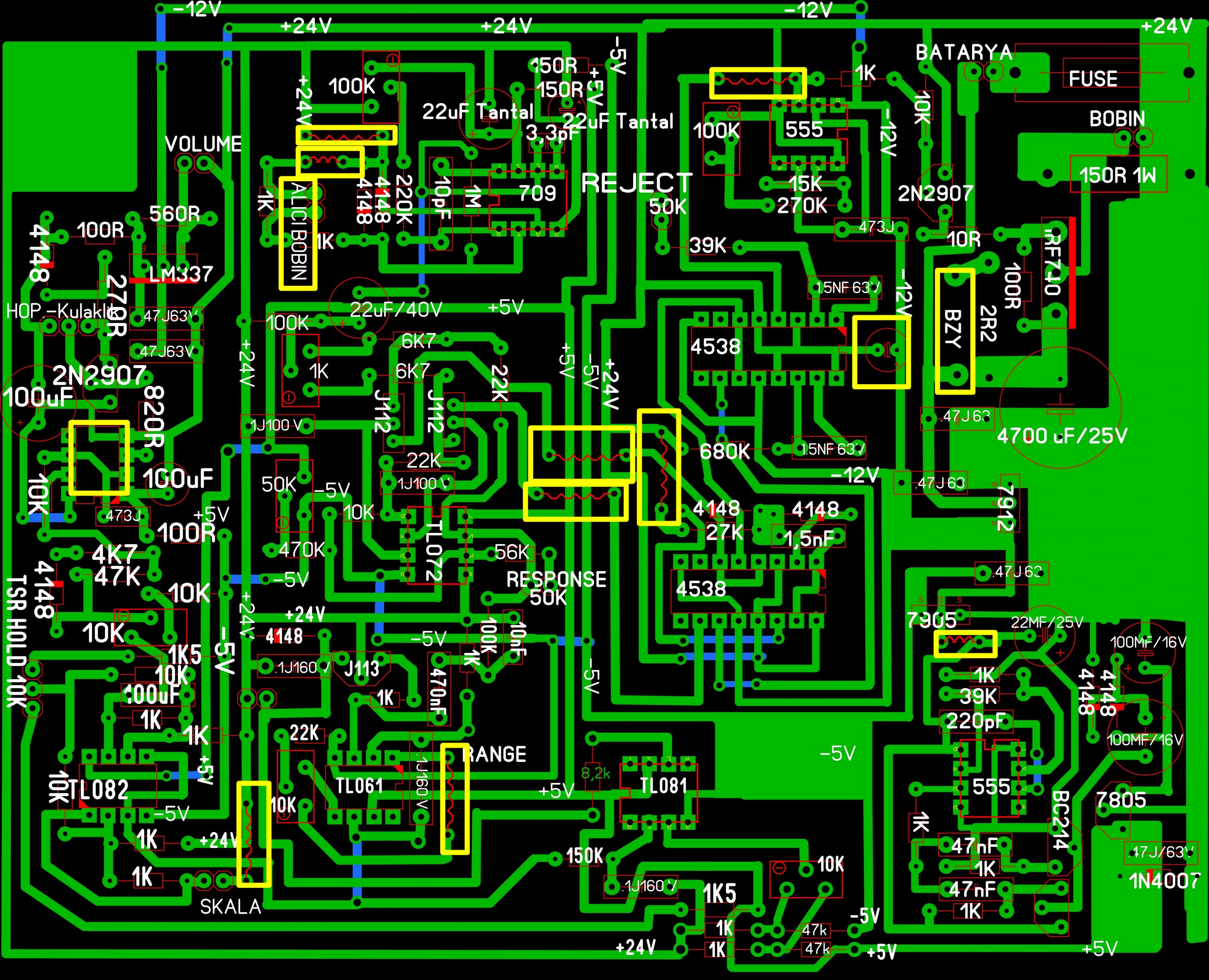

    this is a pcb where the inductances are placed but witch of them is the detection coil ?
      look bobin in right upper corner
        hi kt315 . I see many of inductance symbol on pcb . I can't figuer out witch one is the detection coil
          KT315 is correct. Look at the top right of the pcb, and you will see an IRF740. This is obviously the MOSFET that drives the coil. It is labelled as "BOBIN".
            thank you that's right, how anout " ALICI BOBIN " on the top left corner ?

              Are you sure the schematic matches the layout? The PCB shows a 709, but that doesn't exist in the schematic.
                different pcb, yet different pcb, different schematic, different layout pic from sl. all are different but where is bobin
                and why there are two bobin...
                sometimes i am feeling myself like i am Eric Foster... doing Goldscan and answering on questions 'where is the bobin here'.
                  The MOSFET transistor drives the coil. This is where the coil is connected to the circuit. Use coil 23 cm diameter, 20 turns of 0.4 mm enamel copper wire. Inductance 300-350uH. Use damping tool circuit to properly damp the coil, measure resistance and replace with a fixed 2Watt resistor.

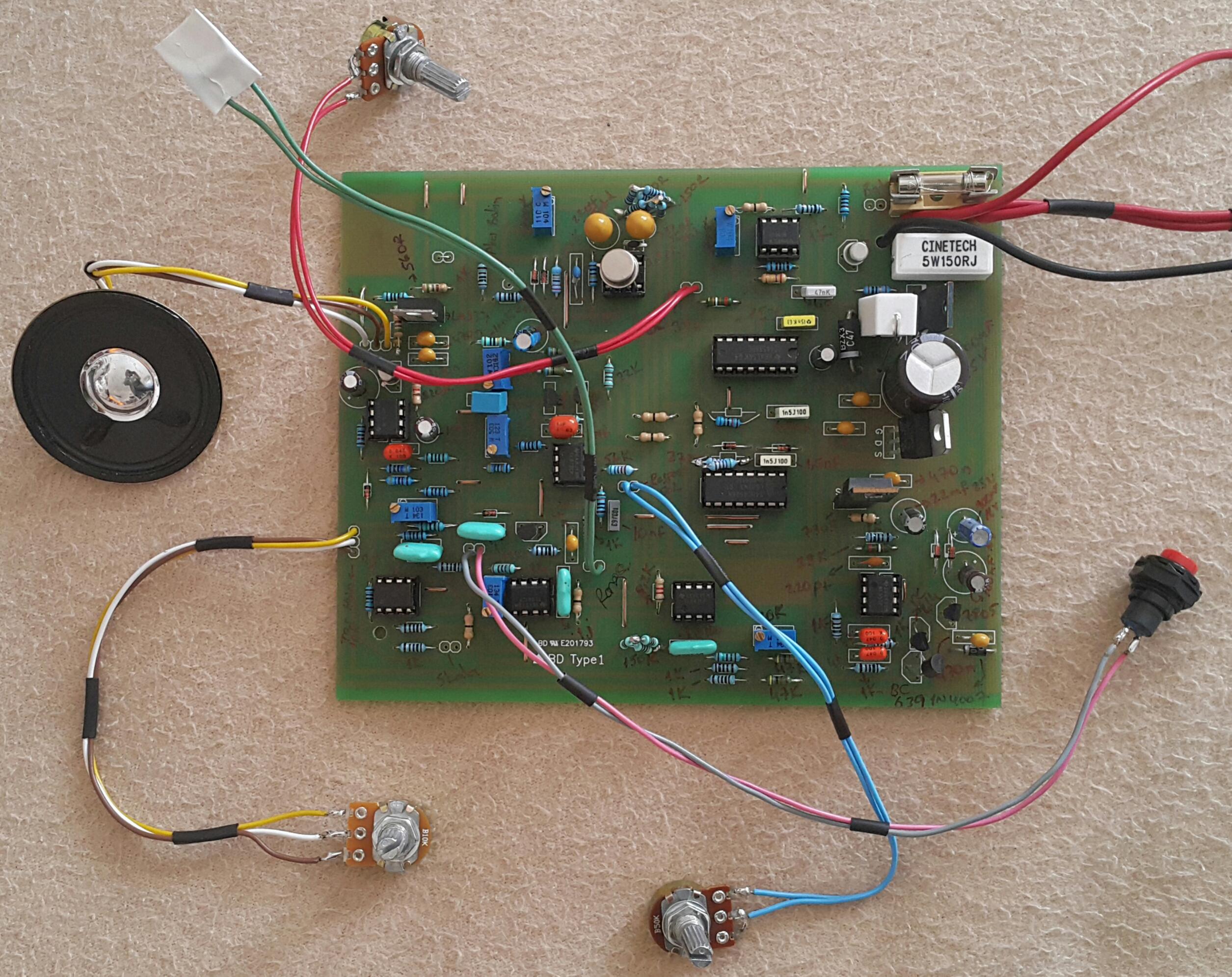

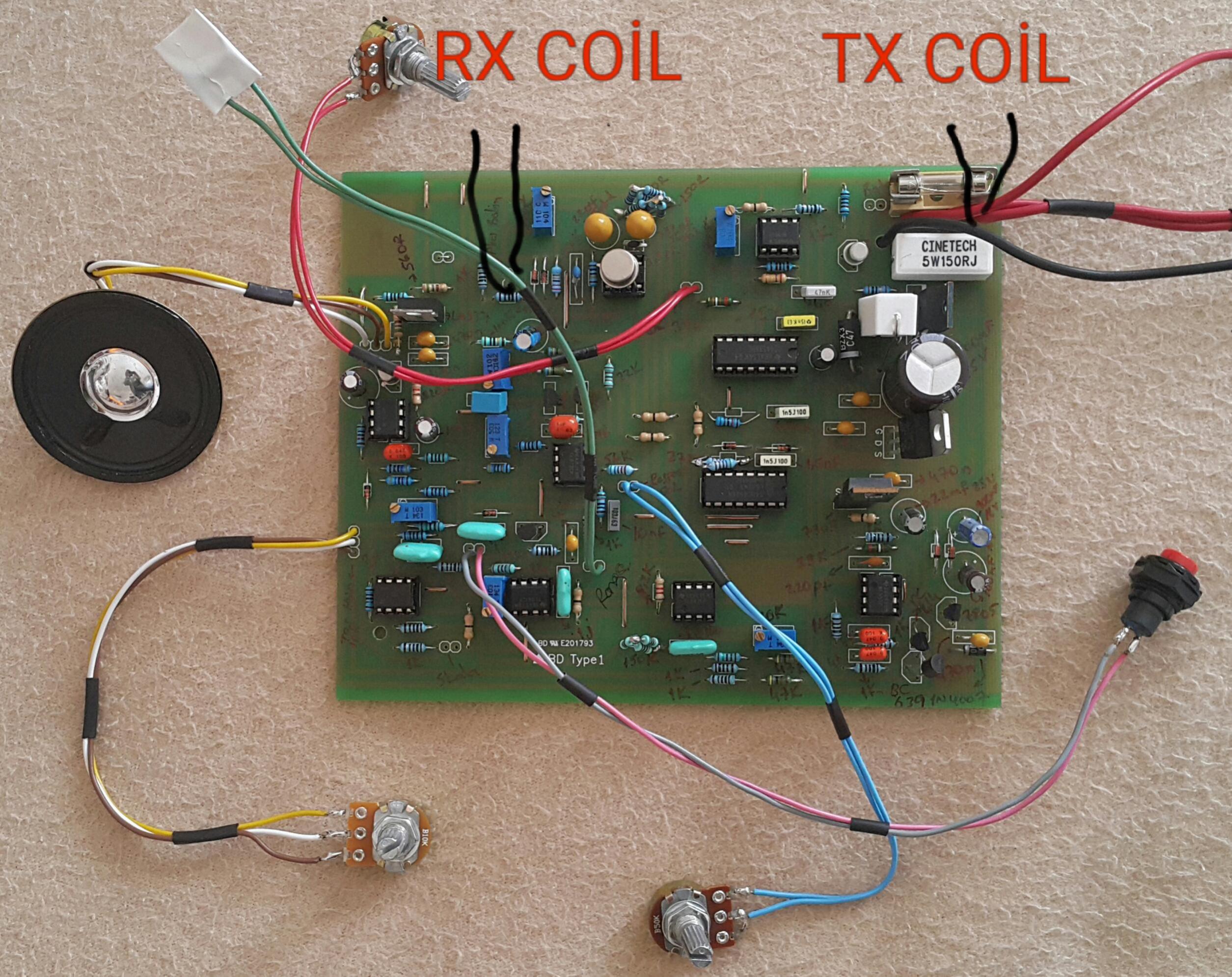

                      This superscan is designed as two coils. TX and RX. You can combine TX and RX TOOL PINS. mono coil to use
                        Hi Tufan can you show me the value of the inductances uses in this pcb . I don't mean the detecting coil .there are other inductances used in this PCB or fuse resistors I think . I'm confused about what kind of component used here, is it fuse resistor or inductance "L" ?
                        Best regards.
                          Hi tufan. Can you tell me why they used fuse resistors instead of 10uH inductances.I'm not talking about the detecting coils .
                          Best regards.

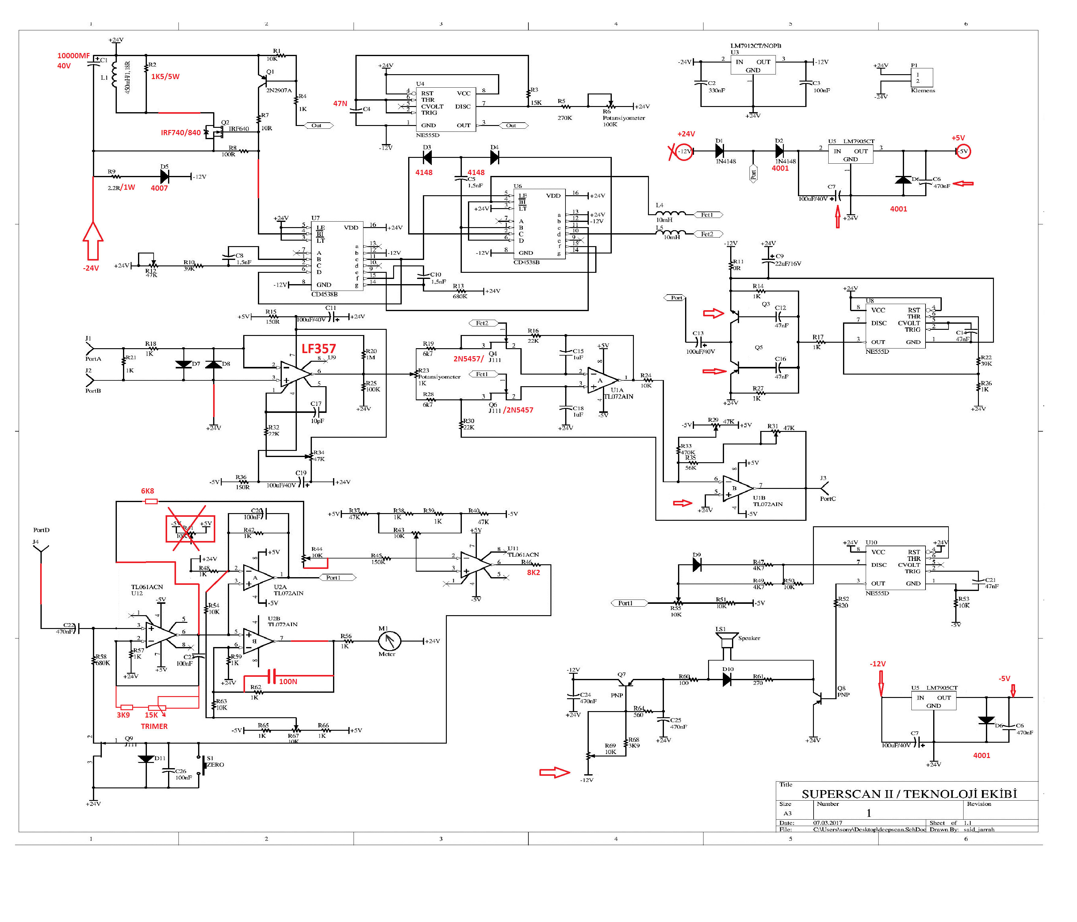

                            superscan there is no inductance coil on the diagram. Only 68mh of coil on the converter.

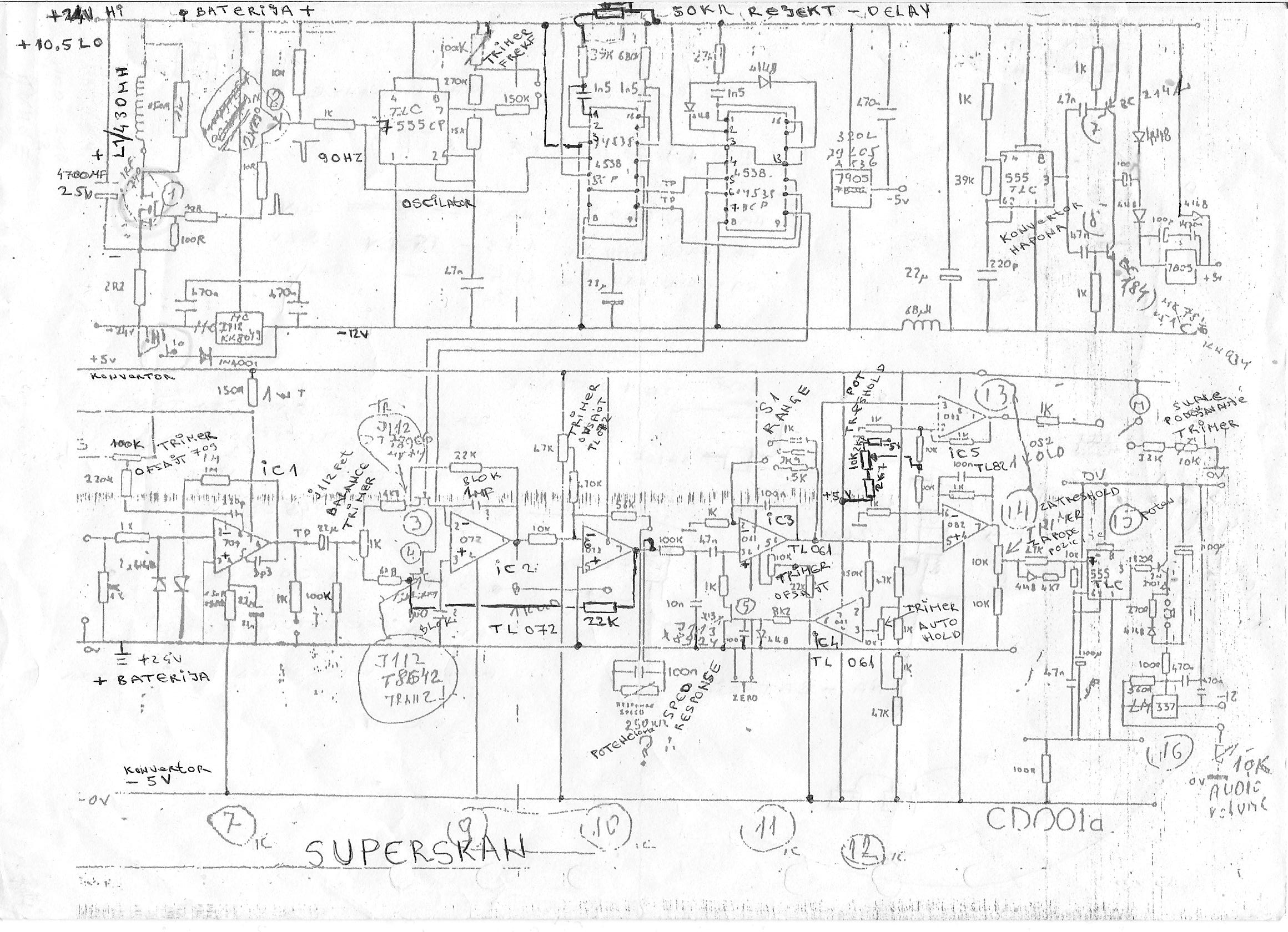

Name:	superskan by erik foster orginal kopija.jpg
                              This schema is not original. and probably won't work. a schema modified by turkish engineers.Click image for larger version
Name:	Copie de Sans titre.png
