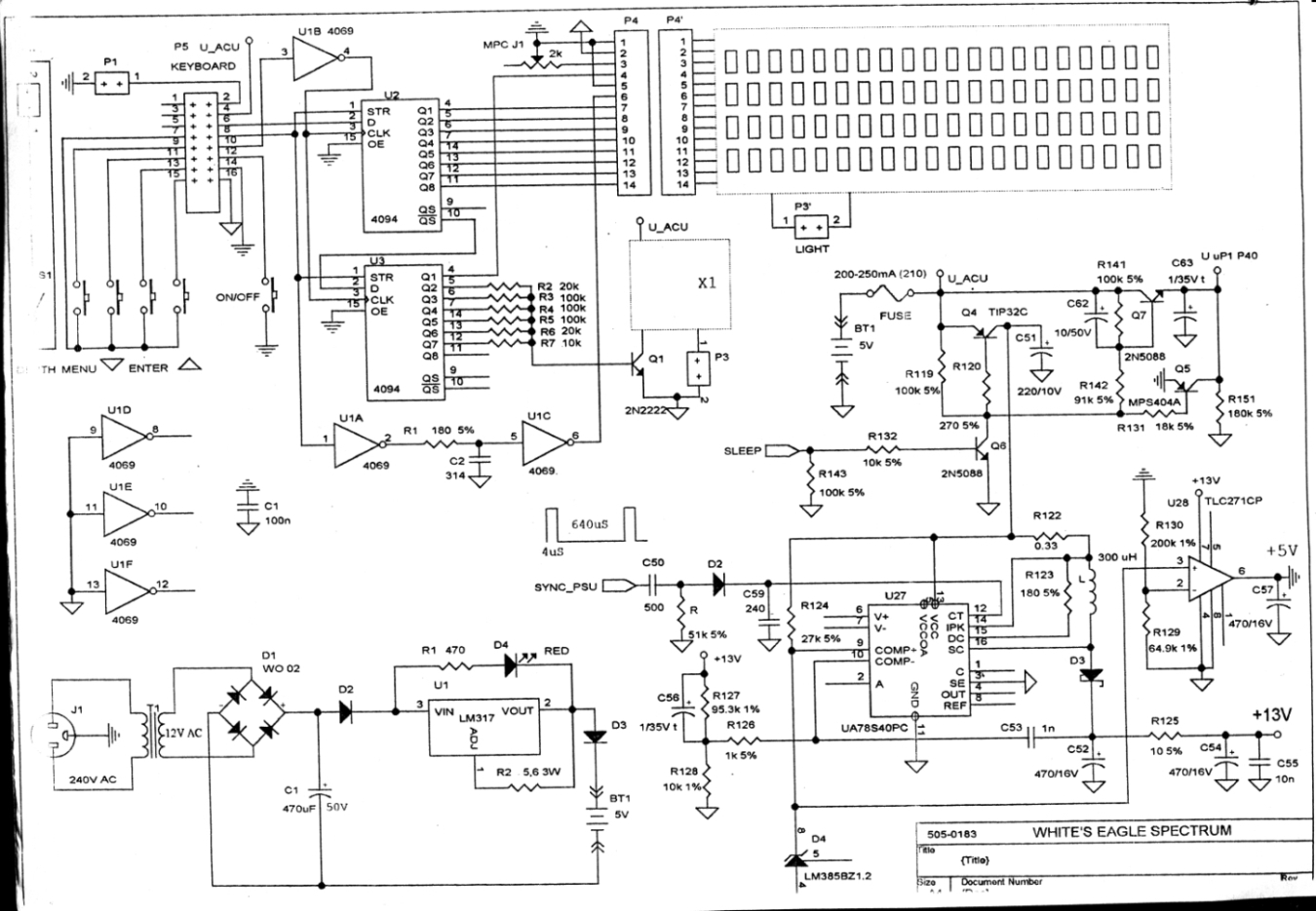

              I realize this post is several years old, but was the Eagle schematic ever found? If so, would someone point me to it's location. I searched through all of the schematic posts and could not find it.
              Jim

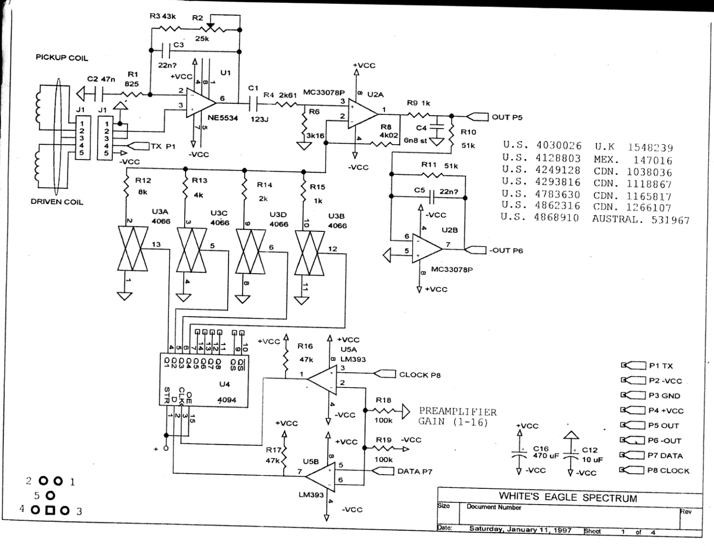

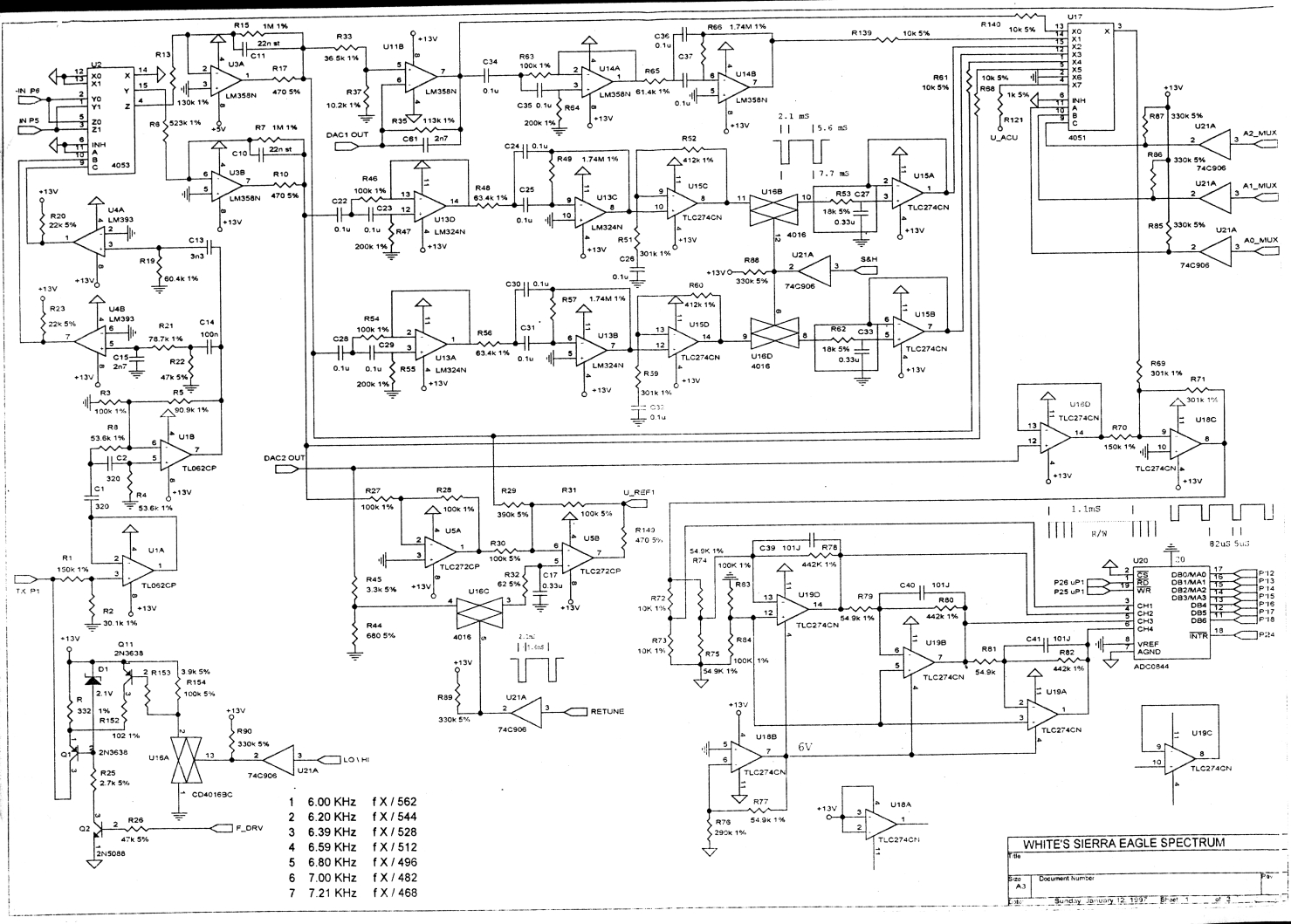

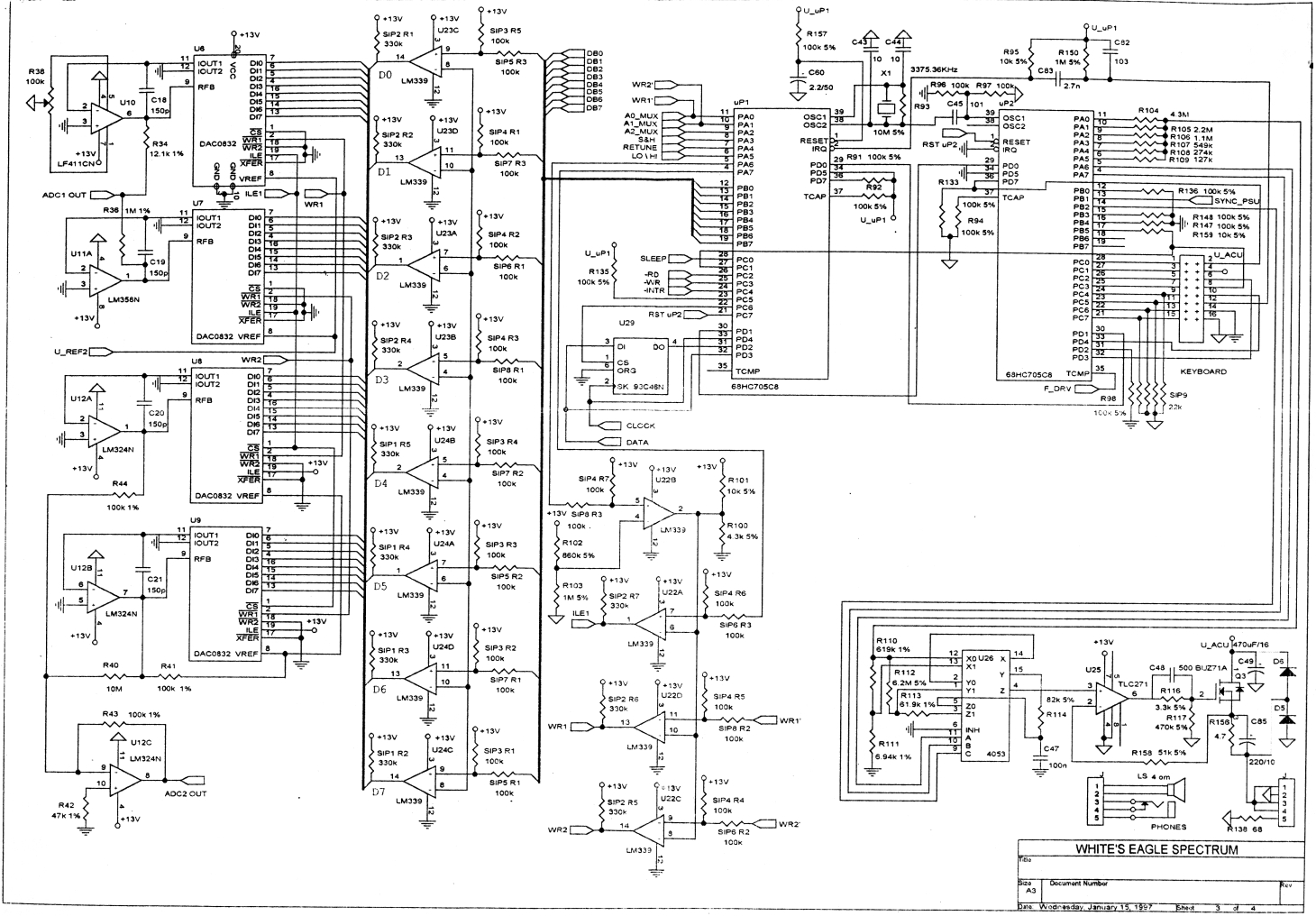

                Here is one schematic, not sure if it's the same.
                    I guess I'm a bit puzzled. Was the Eagle,Eagle II, Eagle II SL basically the same hardware design with only firmware upgrades? Was the Eagle Spectrum also similar to the earlier Eagle models? I would appreciate someone familiar with the White's line of detectors explaining the main differences.
                    Thanks - Jim

                        The Eagle II improvements were either mostly or completely firmware-based. Those improvements were available to Eagle I owners via a micro replacement. The Eagle II SL replaced the wrist-breaker handle with an S-rod with arm rest. SL meant Slim Line, although in later models SL referred to the truly slim box with the 8xAA tray. I believe all the Eagles had 4xC packs.
                        The Eagle I/II had a custom segmented LCD that had some indicators for probable target. The [Eagle] Spectrum incorporated a character LCD and implemented the first SignaGraph and, with a new 5-button keypad, also had a true menu system. Otherwise, hardware was likely the same as the Eagle. Still used the 4xC battery pack.
                        The [Spectrum] XLT replaced the character LCD with a graphics LCD which gave a higher resolution SignaGraph. Also switched to a slimmer box with 8xAA batteries.
                        A Sierra Eagle was likely just a paint job to give Jimmy something "unique" to sell. There were no MODS or PODS in the White's vocabulary, never heard of them.
