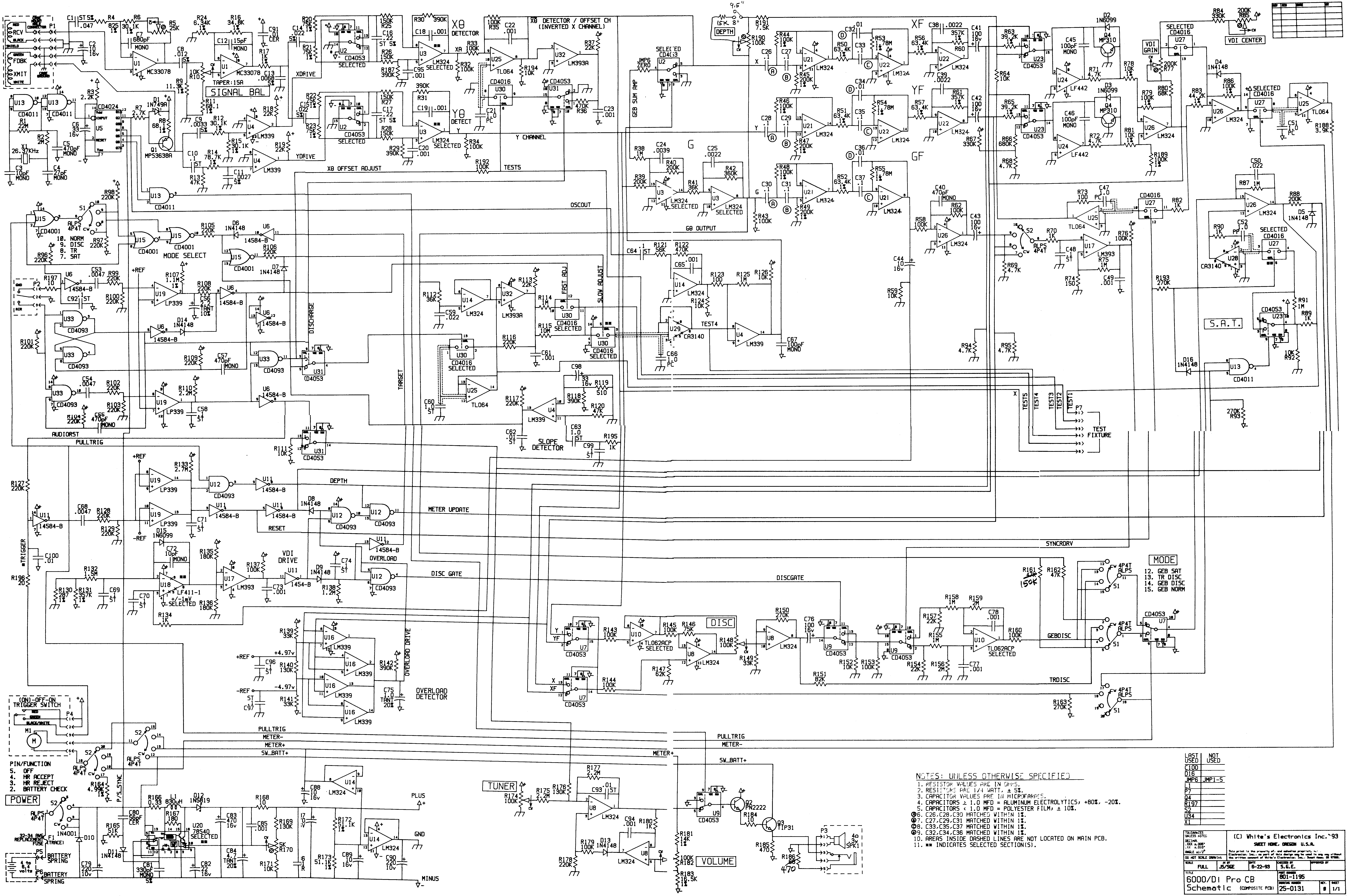

    Needing schematics for Whites Coinmaster 6000/Di series 2. It takes the C-cell battery pack.
    Like this ?
    6000 DI PRO US4783630.pdf

      The Di Pro is the closest to the series 2 from what I've heard and the separate component readouts, audio in particular, should help. Thank you

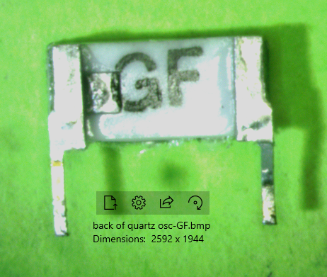

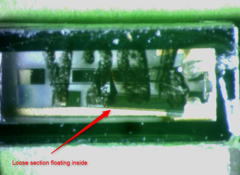

            I am attempting to repair the Whites Coinmaster 6000/D Series 2 with a damaged glass-enclosed oscillator (26.37 kHz).
            Does anyone know where I can find this crystal?

                It would be nice to use the original since the circuitry has been tuned for it.
                I have purchased (should be delivered later today) a 32.768 kHz crystal. If it works, the operating frequency will increase to 8.192 kHz (fingers crossed).

                    I suspect these are long gone. Digikey has 26.667kHz which puts you at 6.67kHz, a 1% difference. Everything should work there.
                      Just as IVCONIC predicted, the 32.768kHz crystal appears to be working great.
