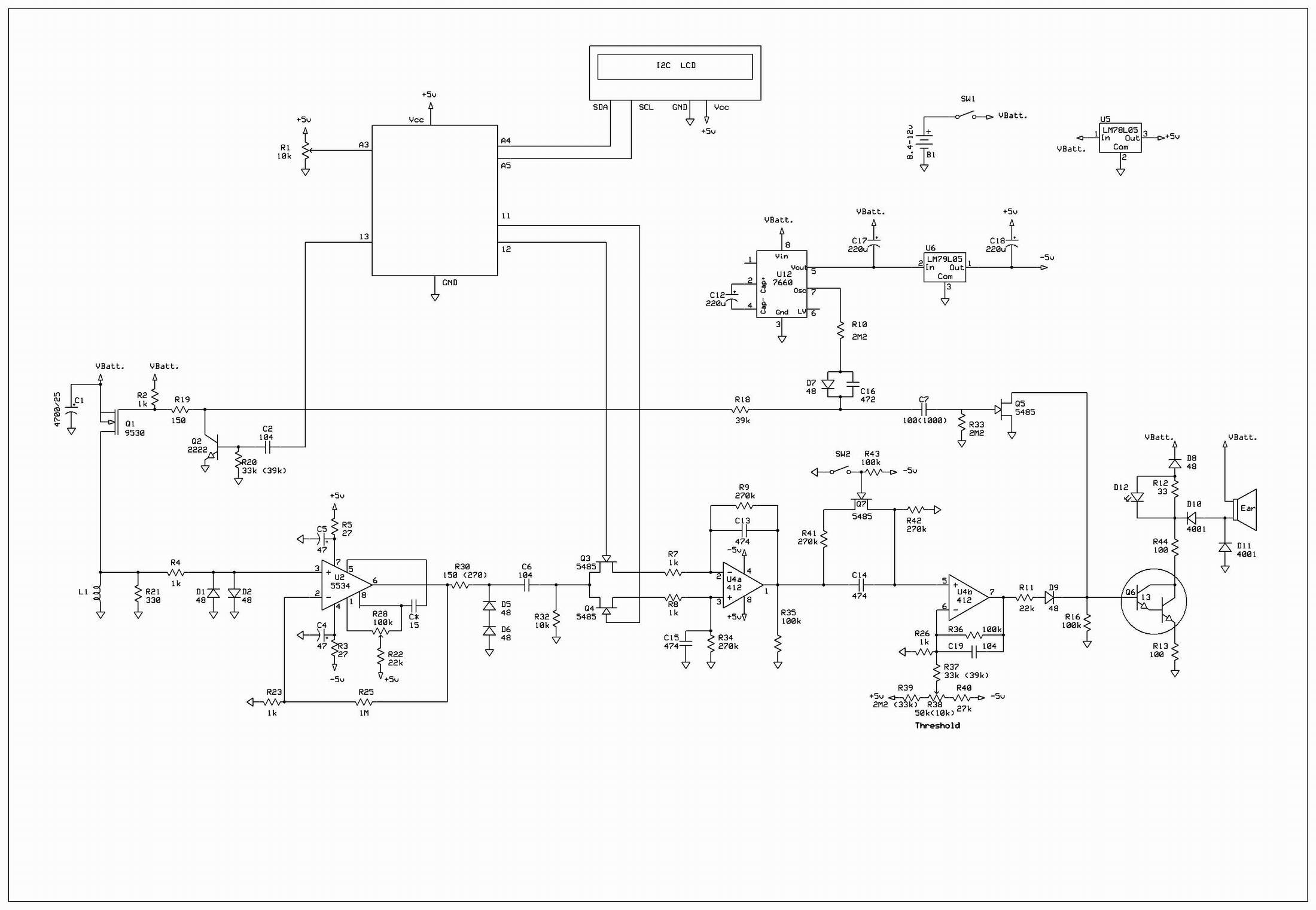

    Hi Iconic, is this your circuit ? do the fets switch ok from the micro ? thanks 6666

    I am "ivconic" and not "iconic". Ivconic as shorter from Ivica Conic.
    Maybe i will become "iconic" one day, when i die. But i am sure i will not give a damn on that than.
    Cold and white, pretty pale, covered with soil; nothing "iconic" in that! Except maybe in worms eyes...
    Yes it is my circuit. I think i posted it somewhere on forum. Along with Atmega code for it.
    Now, code is not genuine mine. I took Joop's code and adapted it for that purpose.
    It really works alright.
    I had "big" ambitious plans with that than, but than i gave up. Since i had more important things to do.

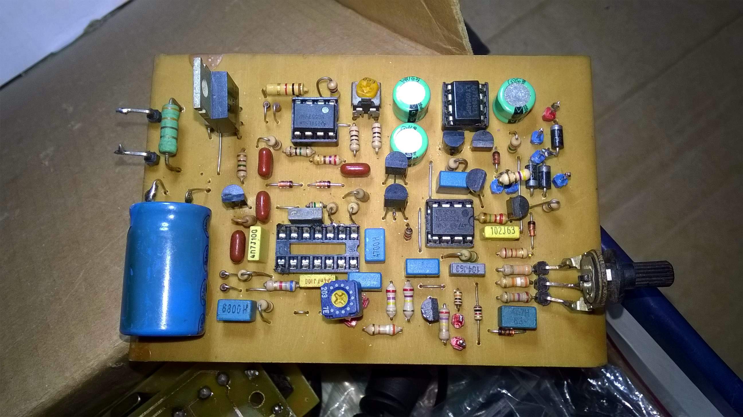

      I had previously finished Barracuda, lying in a box for quite a while.
      What i did? I simply took out the 40106 chip and put wires in the ic socket, connecting spots with Arduino UNO.
      I even had a video, but i think i deleted it, i don't have it no more.
      LCD is with I2C adapter. Irrelevant. You can comment all the lines for LCD and serial monitor, to make things simpler.
      Main timings schedule was suggested by Davor. Although is very easy to change it.
      Pot at analog input affects only the main delay.
      Code can be extended with another pot for second delay. But that's not making any sense on one channel PI detector.
      If i recall correctly; at the time i planned to add another channel and introduce second pot. Which is doable.
      As for the LCD, overall there are enough more cycles free to use them for writing and drawing something on LCD.
      Anybody more enthusiastic than me now; can do the very interesting small "digital" PI project from this.

                    Hi Ivconic, sorry I got your name wrong, I am still suffering the effects of the flu, but thanks for having a sense of humour with my mistake.
                    But I think you are already a ICON.
                    I am interested in your Arduino modification to the Bara, as I always get confused with the correct way to bias JFETS and getting them to switch on and off correctly.
                    Some schematics use + and - 5 volts on the 40106 chip, others like the geotech bara rev A, use -5 volts and ground.
                    Your schematic shows the Arduino powered with +5 volts and ground,
                    Do you remember which version of the Bara pcb you were experimenting with ?.
                    Thanks for the code, I uploaded it to Arduino IDE and programmed my UNO and I can hear the pulses on the pins.
                    I will try an find my old Bara pcb and try it, thanks.
                      This one:

                          Last question (I hope) do you remember if you powered the Arduino from the 40106 socket on the PCB ? thanks.
                            No, as far as i remember.
                            It was powered either from laptop's usb either from separate source.
                            I might replicate the situation again, if i find some free time today or these days.
                            Than i will record it again.
                              Thanks I would be interested in seeing the recording.
