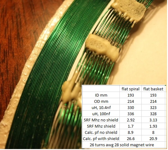

Has anyone compared coils with and without fluorocarbon spacer? I get very little capacitance winding a spiral coil without the spacer. Should I expect the spacer to improve the coil?Originally posted by Elliot View PostI've been meaning to try using fluorocarbon filament as a wire spacer. As I'm first sampling at 6uS already with my own coils, I don't think the improvement, if any, would be much on teeny gold flakes.Attached Files
The dielectric constant of a vacuum is 1. Air raises to 1.00059 at sea level but can also change by the range of humidity in the air, going up with higher humidity. If the dielectric constant of your fluorocarbon spacer is 2 or higher, then removing it should represent less coil wire seen capacitance between the windings. Any materiel that is very close to the magnetic field in the coil wire will affect the coil self resonance. The rule of thumb is to use wire insulation with the lowest dielectric constant and or physically space winds with more air between the turns. Insulation thickness also affects the final coil inductance and self resonance.Originally posted by green View PostHas anyone compared coils with and without fluorocarbon spacer? I get very little capacitance winding a spiral coil without the spacer. Should I expect the spacer to improve the coil?
My best coils use thicker 600V or higher Teflon insulation with a dielectric constant near 2. This way I can make a bundle wound coil, use PE spiral wrap, and space the shield away from the coil wire to minimize coil to shield capacitance. I used Scotch 24 as a wire mesh shield, which minimizes the coil to shield capacitance due to less area than a foil like shield. I have found through experimentation that cutting the width of the Scotch 24 just wide enough to not overlap when going around the coil bundle prevents the shield from being seen as a target at lower delays.
Bottom line, anything you can do to reduce the capacitance seen by the coil after the TX pulse turns off and the discharge slope energizes the targets and the damping resistor value is damping the oscillations enough so the RX stage can sample as early as possible. Less capacitance allows higher damping resistance values and potentially earlier sampling.

My point was. I get less than 10pf capacitance using magnet wire if I spiral wrap a 300uH+ coil with no spacing. Don't see how adding spacing would help. Maybe someone has tried both ways and could post results.Originally posted by bbsailor View PostThe dielectric constant of a vacuum is 1. Air raises to 1.00059 at sea level but can also change by the range of humidity in the air, going up with higher humidity. If the dielectric constant of your fluorocarbon spacer is 2 or higher, then removing it should represent less coil wire seen capacitance between the windings. Any materiel that is very close to the magnetic field in the coil wire will affect the coil self resonance. The rule of thumb is to use wire insulation with the lowest dielectric constant and or physically space winds with more air between the turns. Insulation thickness also affects the final coil inductance and self resonance.
Joseph J. Rogowski
