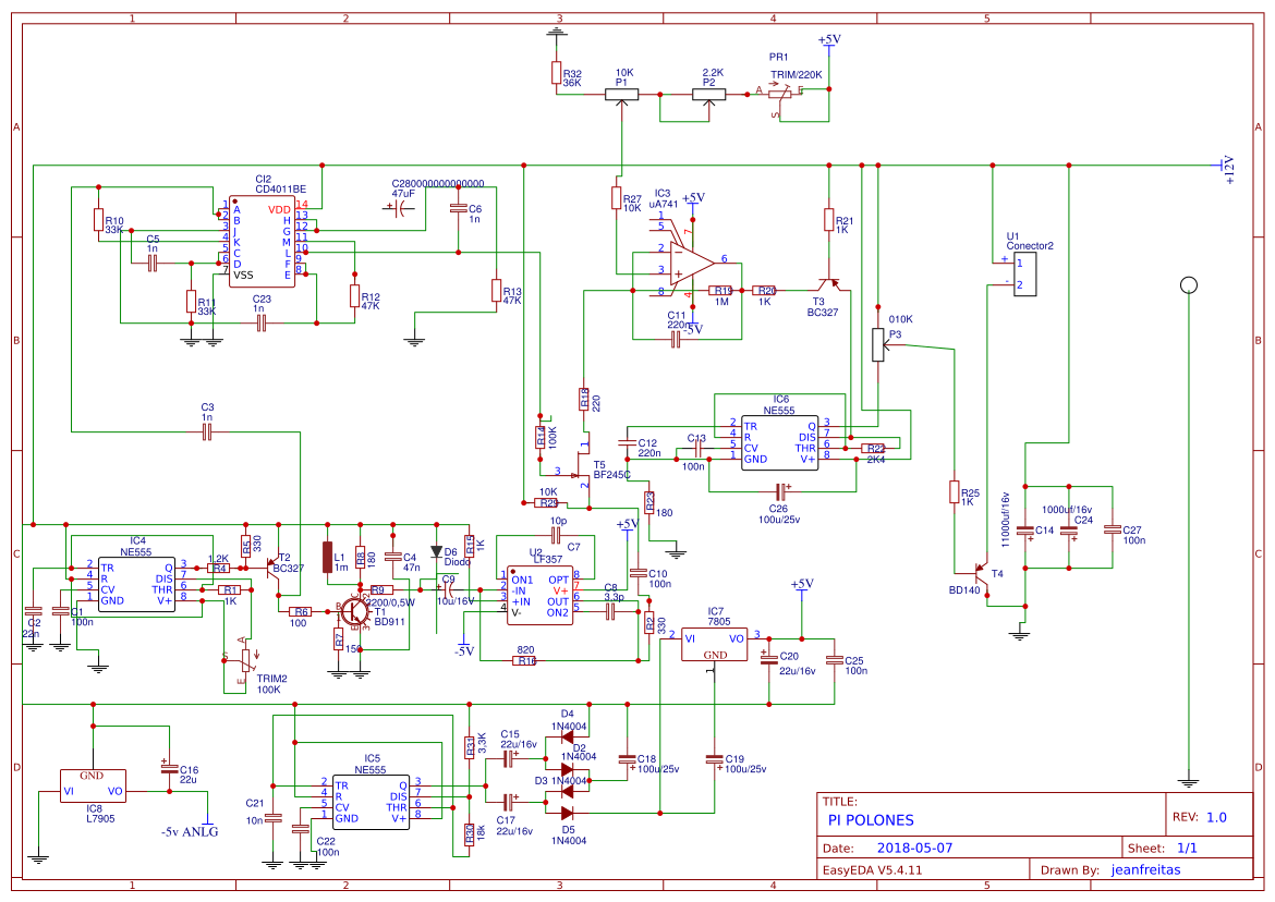

    hello everyone, masters, does anyone have pcb polones layout in the form of SMD ??? (SMD layout)
    never seen so far, but it is not complicated
      because I have built polones and changed their frequency and can detect gold better, but it is wasteful on using batteries,

          I just changed the capacitor settings on ic 555 to increase the frequency, and replaced ic 4011 to cd4093, then took the output and connected to bf245. whereas my fet uses igbt 60b65
            Somebody seems to have a project for it, not smd

              hay 6666 I have increased the frequency and added vco in it, but I want to try using smd

                  I might make the schematic in SMD, it's not really hard but it's time consuming.

                        Can you post here what you did for the VCO so we can all see? Thanks
                          -- but it is wasteful on using batteries
                          -- I just changed the capacitor settings on ic 555 to increase the frequency
                          and do you not want to notice a correlation?
