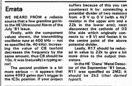

    This project was in the September 1981 issue. I have found the November issue, and this errata noting a wrong resistor value was published:
    I have the October issue somewhere, If I can find it, I'll look for any errata in it.
    Attached jpg

        Hi Brother,
        I read the errata (I bought the kit from a company called Magenta Electronics) so it had the corrected parts list. It STILL has problems. I've modded just about EVERYTHING on it and the performance is still around 10cm on a 1 Euro coin, It seems the whole design was just flawed.
        Thanks for adding the November print. I have EVERY hobby magazine for around 15 years in my loft. I have been scanning them in one by one when I have the time (around 1500 magazines) with the intention of putting them on a website but somehow I just dont seem to find the time to finish the job.
        As this was the September issue, I was bought the kit for my birthday. I built it and always thought it could be better but I had fun with it and I would like to make it work properly if someone can figure out what the design issue is and if it can be easily corrected.
