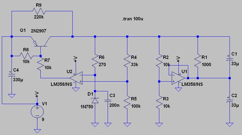

              I put an option of a power supply circuit. It delivers output of +6V , +3V , and ground.

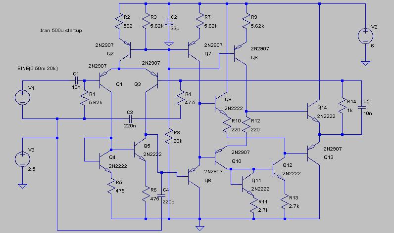

                Something I thought about was the phase response of the original rx preamp( with bunch of solid state devices). I ran a simulation of the circuit and found the output ( before 10k trimmer), there was zero phase shift of the signal at 20khz)
                I thought that by replacement of this stage with an opamp topology would be careful to observe any phase response inherent in pass filtering. I assume that most likely the original coil parameters would be used in an updated version. Also consider whether a series resonant rx coil vs a parallel resonant coil would be implemented.
                I put here the corrected original gold bug preamp ltspice file.

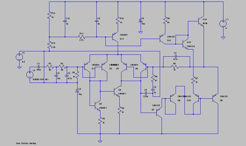

                • #53
                  I apologise for uploading wrong files, the correct files have now been uploaded.
                  • #54
                    Here I put CZ6 rx preamp ltspice file. There is definitely a marked frequency dependent phase response. Say at 4 khz vs 20khz.

                        • #57
                          That CZ-6 pre-amp WILL have a noticeable phase/gain behaviour, it's mostly defined by the R's and C's in the feedback network.
                          The 1K0 & 4n7 pair give a low-pass roll-off at fc = 34 kHz , and the high-pass roll-off, determined by the 47R & 1u0 pair, give an fc = 3.4 kHz.
                          There may be some additional contributions from the input filter ( the 47R + 47R etc low-pass filter circuit ), and the 200pF stability cap will affect things at high freqs, I don't know what, though.
