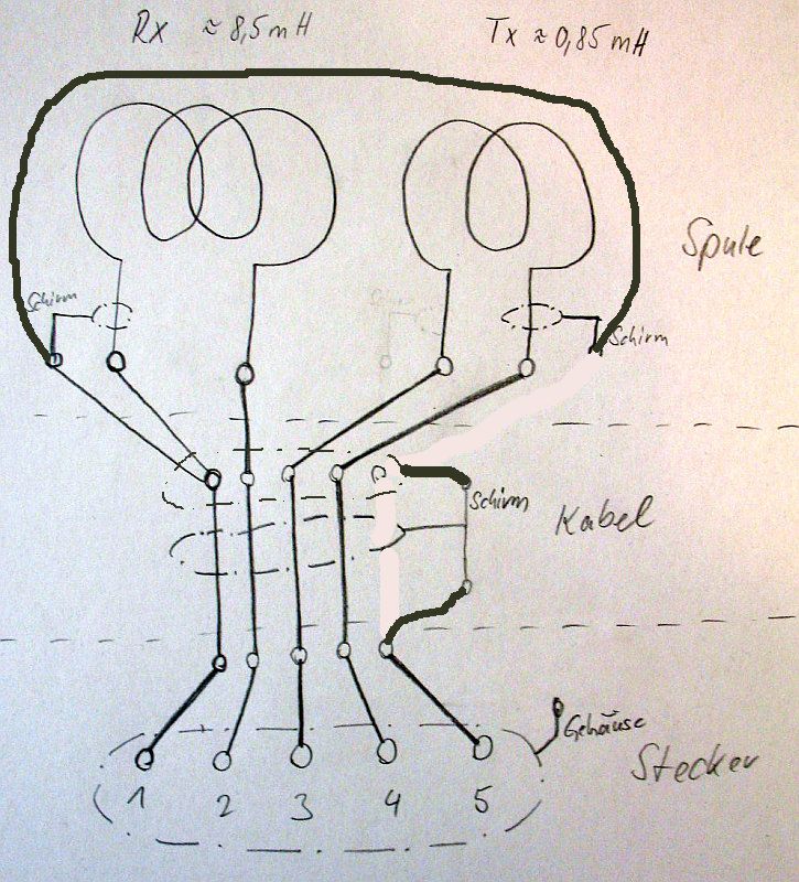

      Coil i have is original coil for Gold Bug 2, not for Gold Bug.
      Today i realized that, by randomly finding totally stripped original pcb from Gold Bug 2.
      Gold Bug works on 19kHz while Gold Bug 2 on 71kHz.
      So actually i am having coil for 71kHz. All the time trying to make my diy work with it.

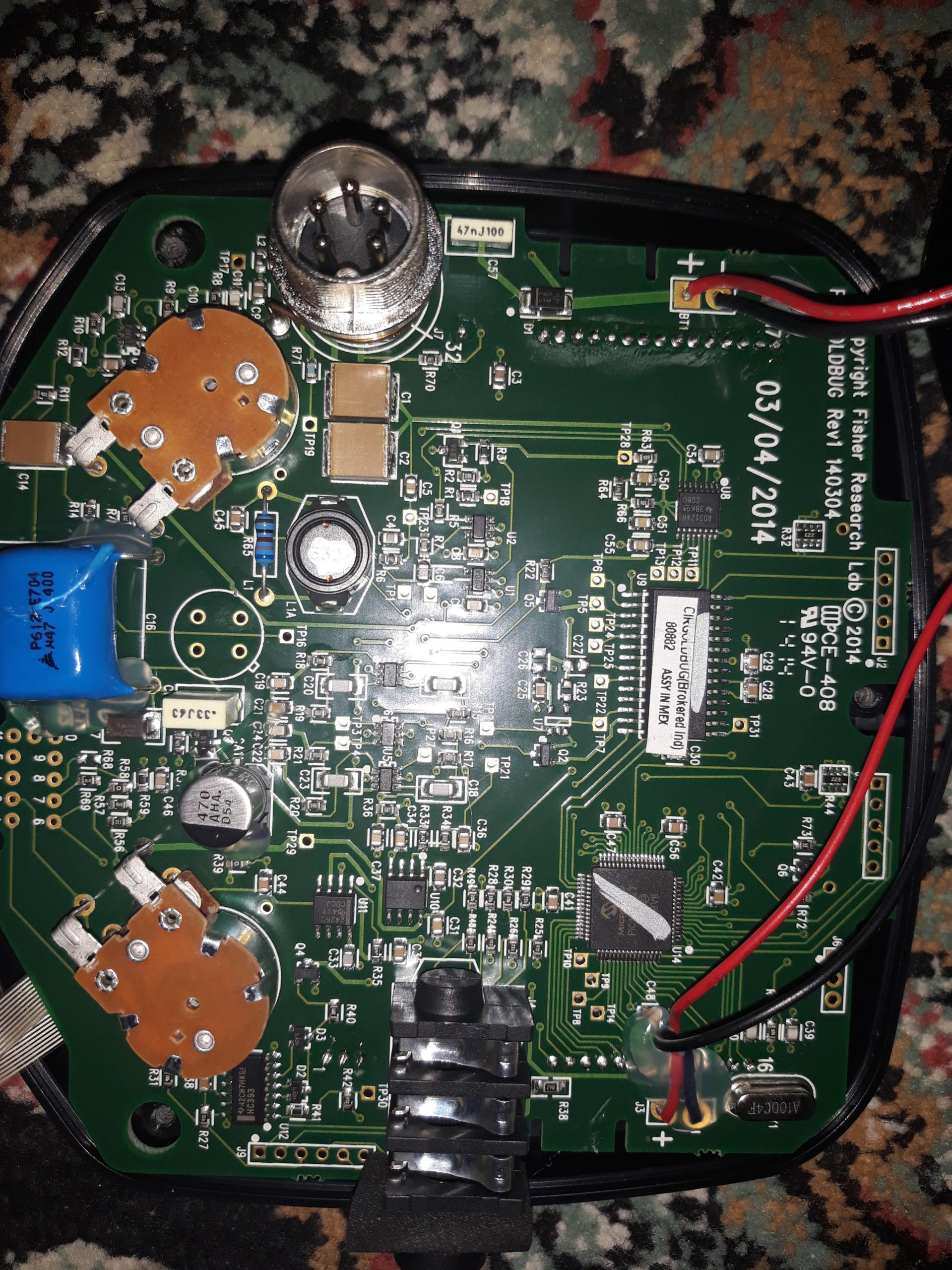

          • #80
            Doesn't the Fisher Gold Bug 2 contain a microprocessor?
            That will be a major obstacle to any back-engineering effort.
                Yes the "digital one" with COG display.
                But before it there were Gold Bug and Gold Bug2 in the same enclosure but with different circuitry inside.
                Lahr's hand drawn schematic that is present on forum is Gold Bug (1).
                            modern Fisher GB2, of First Texas, has.
