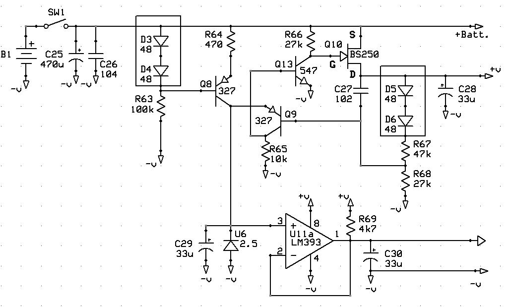

                  I made original power supply. Instead that (in)famous mosfet, that can not be obtained; i put BS250!
                  Blast! It is working just fine, the power supply!
                  Giving precise 6v and 2.5v.
                  So, from now on i can use original power supply too, if i like.
                  Probably there is a reason that author(s) insisted on such type of supply.
                  MPSA13 with joined base and emitter can be replaced with two 1N4148 diodes in series.
