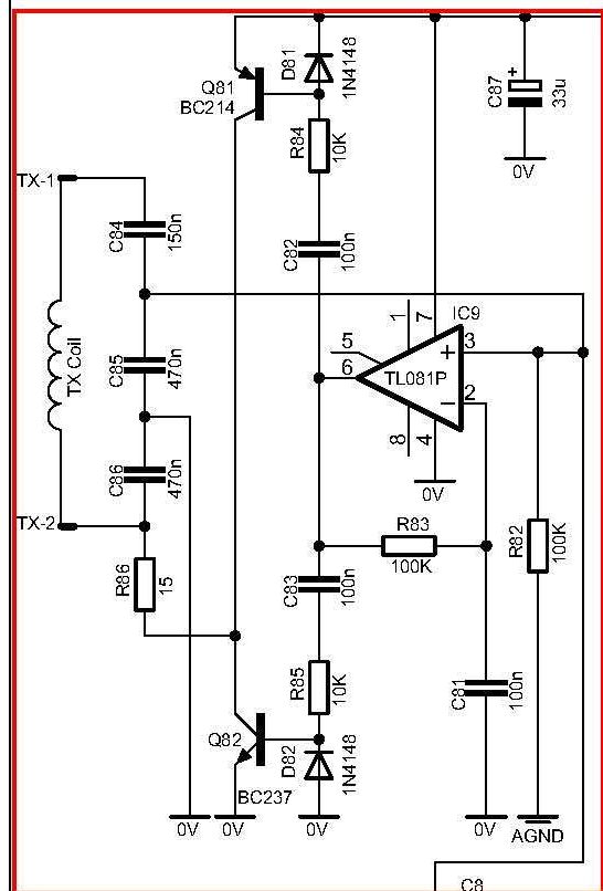

    Hello everyone,
    Has anyone seen other IB MD schematics made with this type of generator?
    Yes indeed, I recall a "Buccaneer" metal detector by Andy Flind. It uses this exact tx circuit. The opamp is a CA3130. Don't think TL081 is good here. CA3130 is bimos chip(CMOS). Have a look at Buccaneer schematic.
      https://www.geotech1.com/pages/metde.../buccaneer.pdf
        thanks to both for the hint.

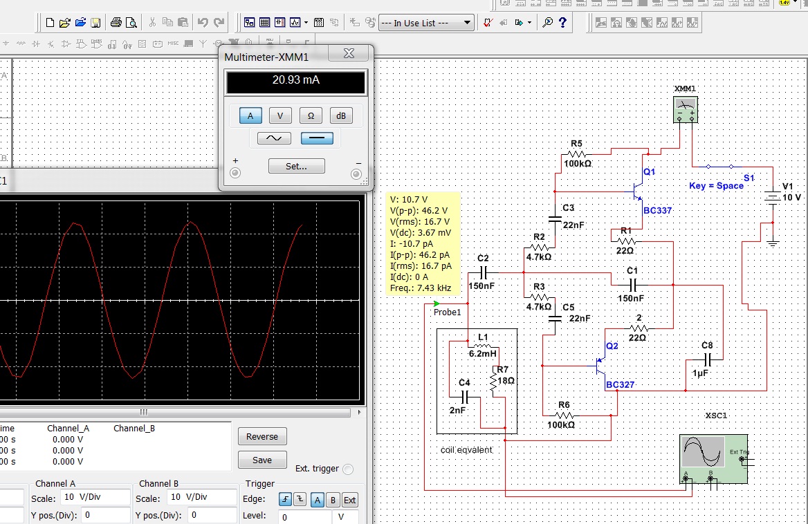

          I make this generator, better work with high Q faktor LC group. This in schematic is universal. Click image for larger version
            Thanks for your responsiveness man, I will give its time to explore it in details...
              by the way, what is the software you use for simulations?
                The software is Multisim. This is a real working scheme. I made a detector with this oscillator
                  Thank you bgs.
