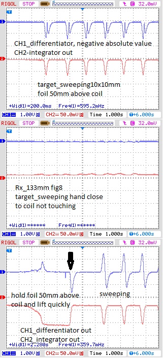

    Apologize for the side track. This hand detect has got me stumped. Was playing with it yesterday. Seemed like every time I was starting to figure it out, NOT. Have been using led indicator and differentiator out on the scope. Needs a change since they are AC coupled. Looked at integrator out(DC coupled)yesterday. Hand held steady over coil seems to cause an offset that doesn't drift amplitude.
    Some observations: Some times placing hand over coil B signal was opposite polarity hand over coil A(normal target). Sometimes signal polarity was the same. Sometimes no signal over B or A. Sometimes over A not B. Sometimes holding the other hand on scope ground made a difference, sometimes not.
    Required signal change at integrator out to light the led depends on noise level, typically 1 to 2mV.
    Were you able to detect charged PVC pipe?
    Including a scope picture. Some signal change with hand over coil, think because not holding stead enough.
    Hope someone has some suggestons.

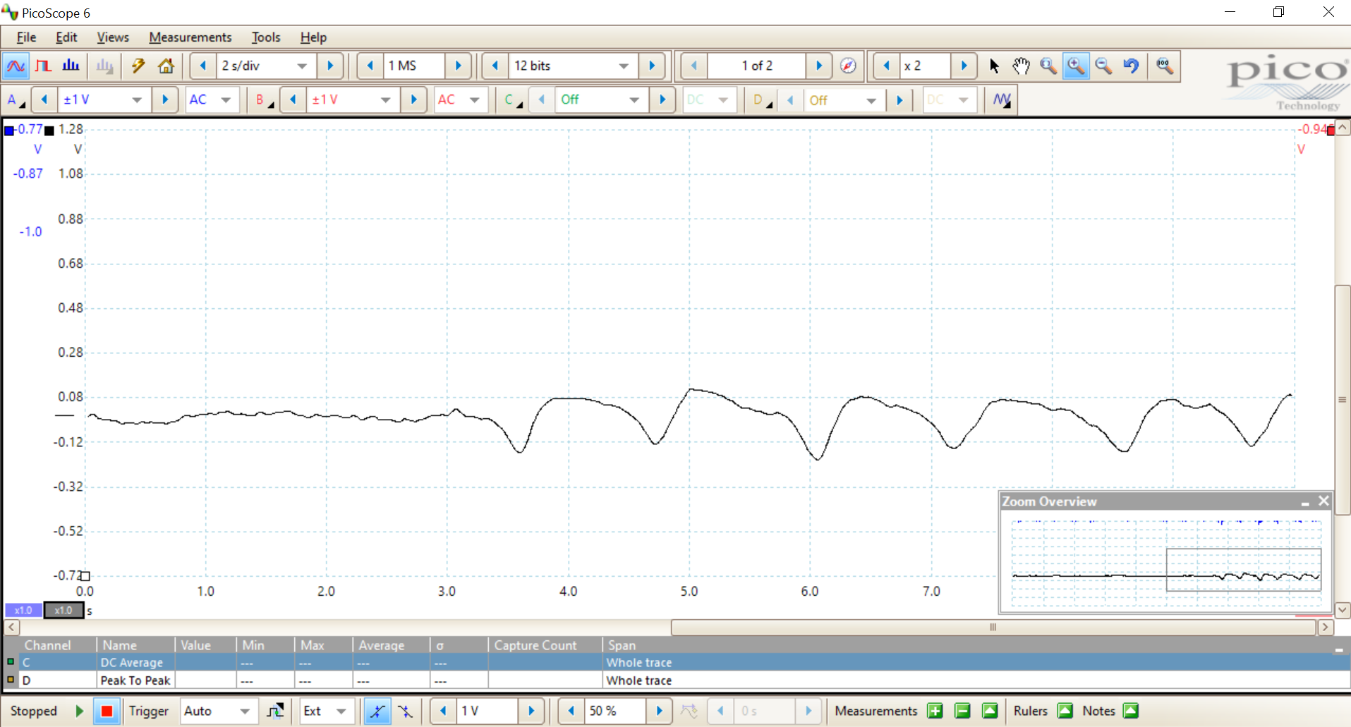

    Tried to detect static charged pipe. Could see no reaction on the scope, when sweeping over the coil. Noticed that when I picked up a piece of foam with the charged pipe, when sweeping over the coil, the rim of the coil captured the piece of foam and took it from the pipe.
    Tried sweep with the left hand, 50mm above coil, right hand not grounded, see reaction on scope attached.

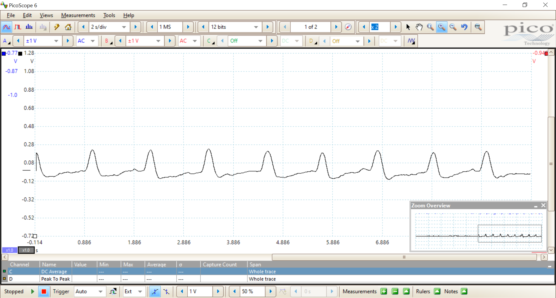

      Made sweep with 10x10mm kitchen foil at 50mm above coil, as a reference.
      Foil on 70cm wooden stick.

            Hi Tinkerer,
            A test similar to yours. Sweeping a 10x10mm square cut from regular strength aluminum foil taped to a wooden stick 50mm above coil. Sweeping my hand as close to coil without touching. Held foil on a 50mm spacer above center of coil and lifted quickly, easy test to repeat.
            See you are getting maybe 300mV sweeping the foil. Good signal for a fast target. What size coil, total gain?
            Testing was done across the center of one of the figure8 coils not across both.

                  Repeated my hand test and foil tests. Same results with right hand Earthed with earthing bracelet on the wrist, connected to large earthing mat on my desk, which is earthed to mains driven power supply that has an earthing pin connected.
                  Another interesting observation is that the response of the foil is going positive and the response to the hand goes negative, as you can see by comparing the 2 scope pictures I posted. This was observed today in the exact same way with the right hand earthed.

                    I use a figure8 coil so target reverses end to end. Most of the time coil A is positive with the hand(same as target), sometimes no effect and I think I remember it going negative a coupe times. Would be nice to have a more repeatable test for for shield effectiveness.
