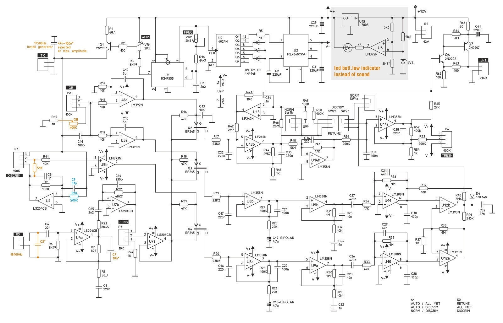

            I think that in order for anyone to assist you in this project that you will need to share the schematic so that we can see the circuit.
            Cheers
              William Lahr's schematic. there was not another.
                Disculpen amigos, tuve un problema por eso no pude publicar el esquema en el que estoy trabajando.
                Aqu? lo publico: [ADJUNTE] 55791 [/ ADJUNTE]

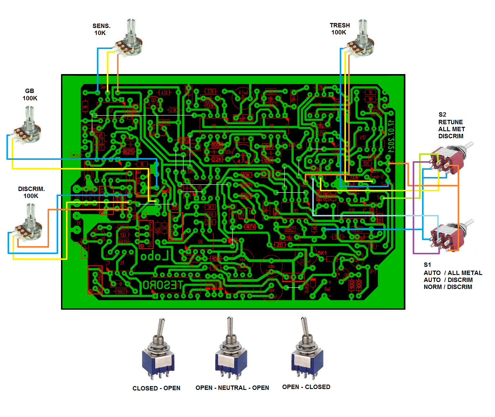

                  I also publish my single sided PCB for those who want to build it. I copied it from Shevakotic; I just made it some changes. I also leave the file in Black and White.

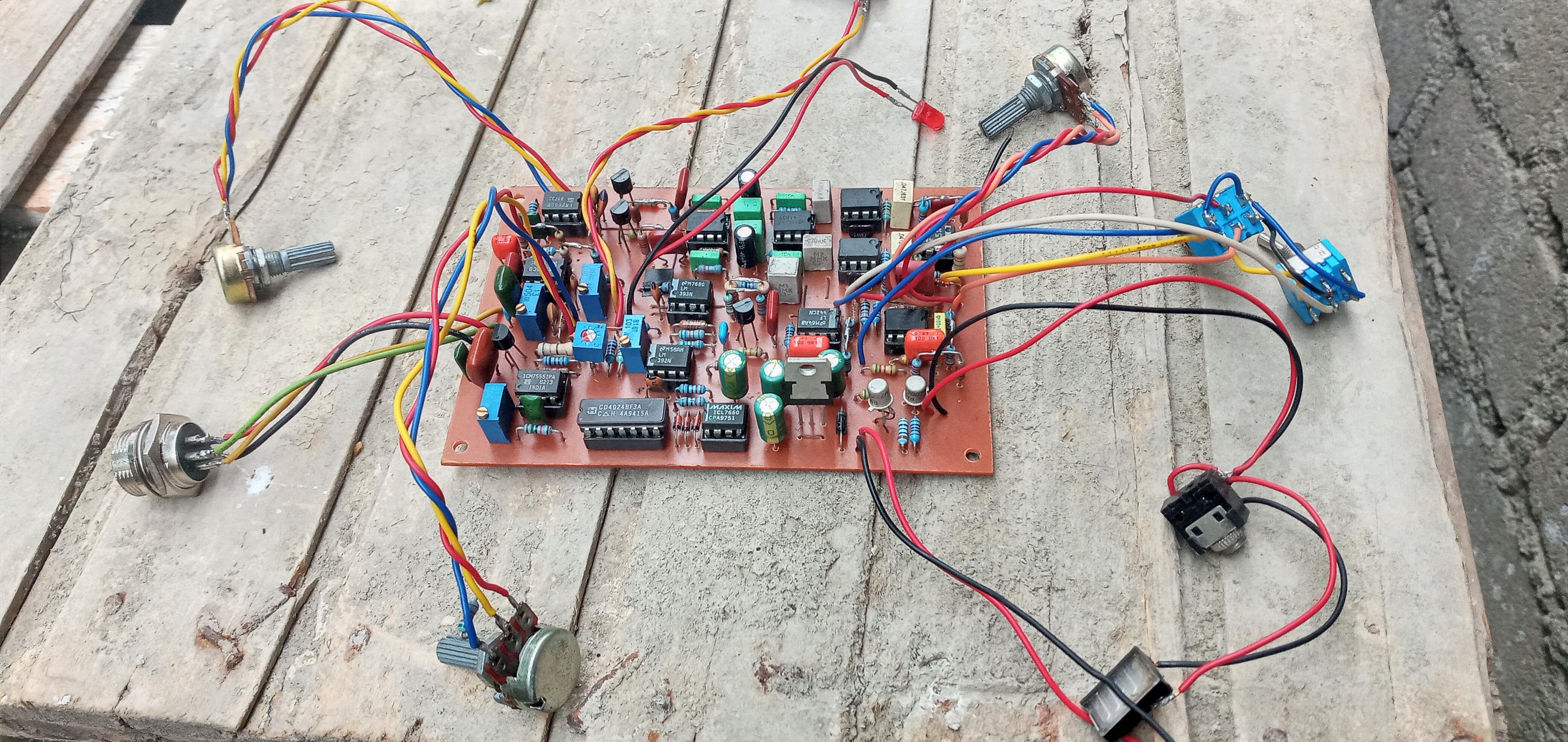

                        Here I post the potentiometers and switches.Click image for larger version
Name:	Potentiometers and switches.png
                          A query; I don't have the BF245s but I have 2N3819, NTE312, 2N4393, 2N4392.
                          Which of them would be the best?

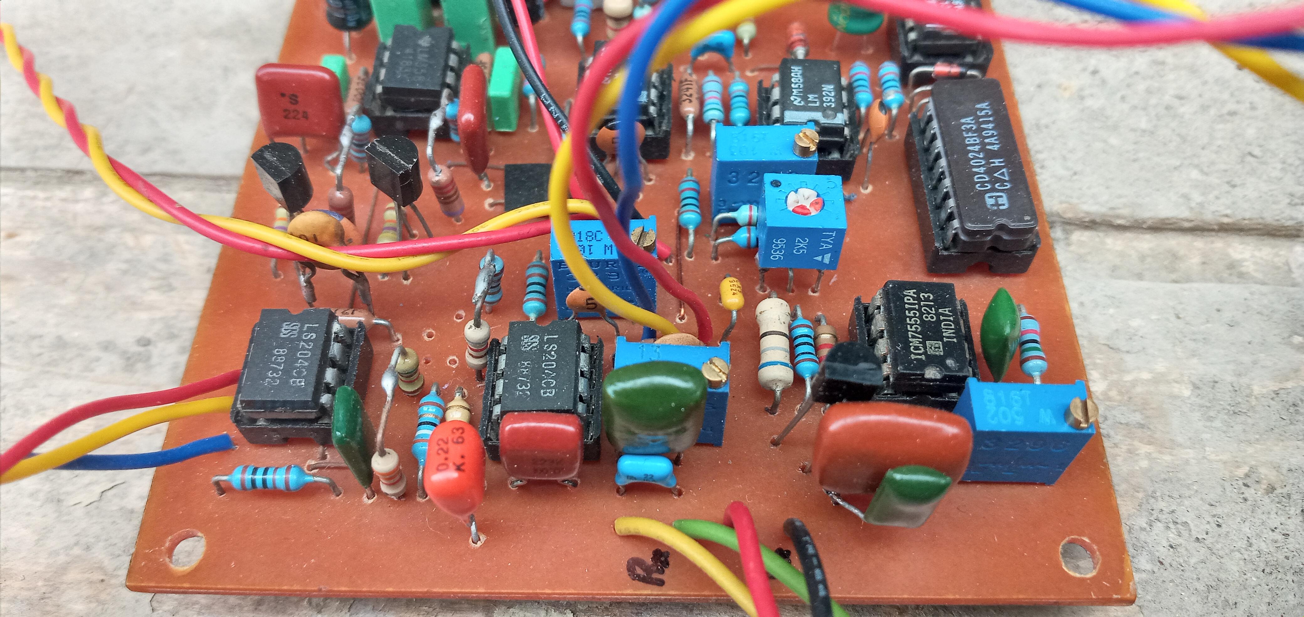

                            Soon I will post photos of my PCB; although I'm not good at welding

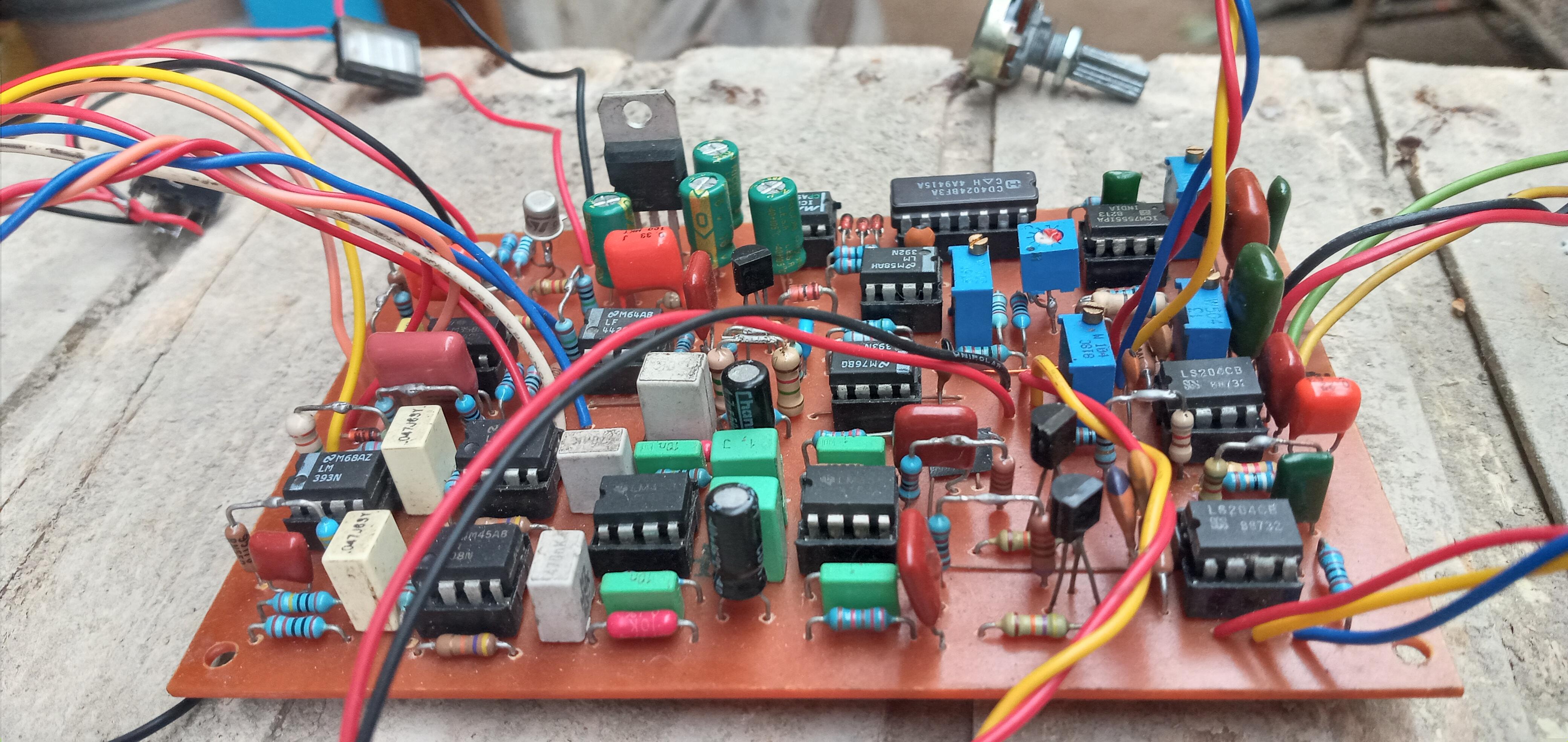

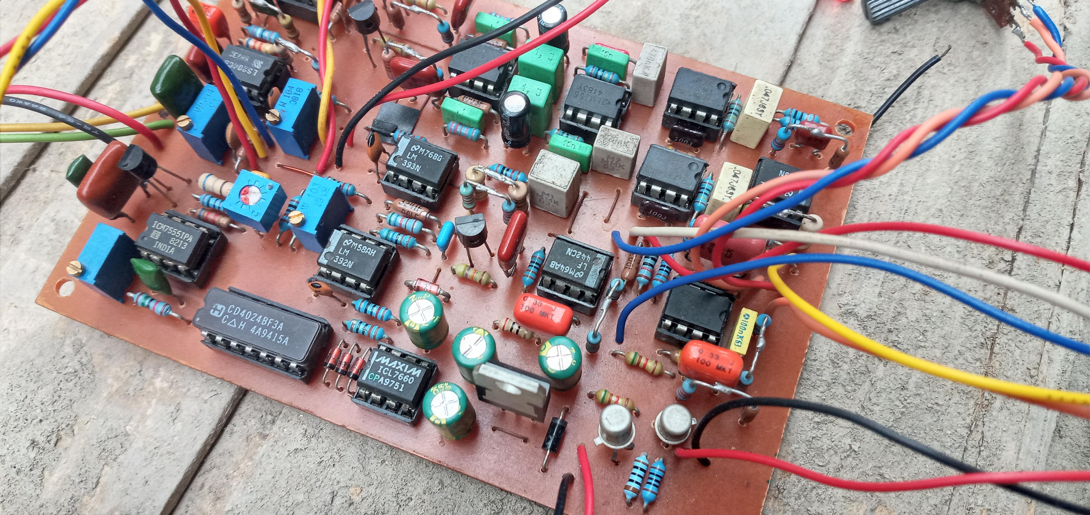

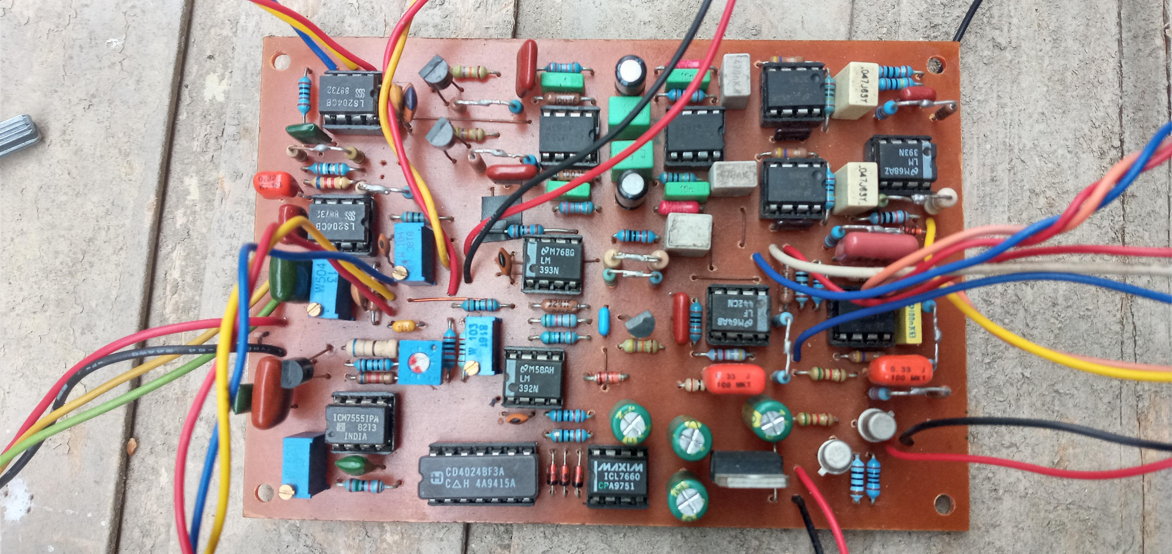

                              Hi friends!!
                              Here I post some photos of my PCB with the components.Click image for larger version
ID:	361775Click image for larger version
ID:	361776Click image for larger version
ID:	361777Click image for larger version
ID:	361778Click image for larger version
