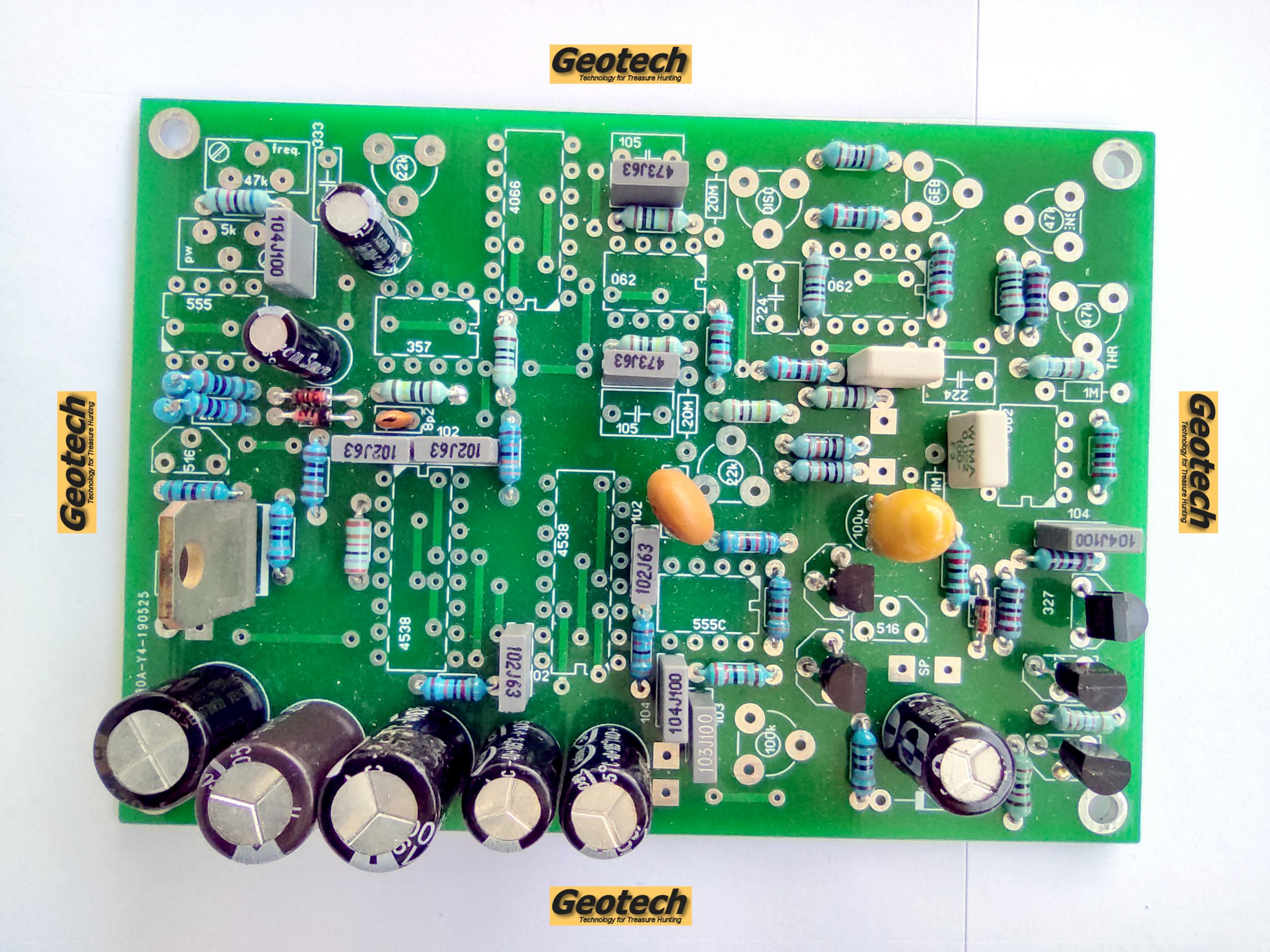

    Which circuit does the pcb shown in the picture belong to? Thank you in advance for your help.
    what is a designation of MOSFET in TO-220?

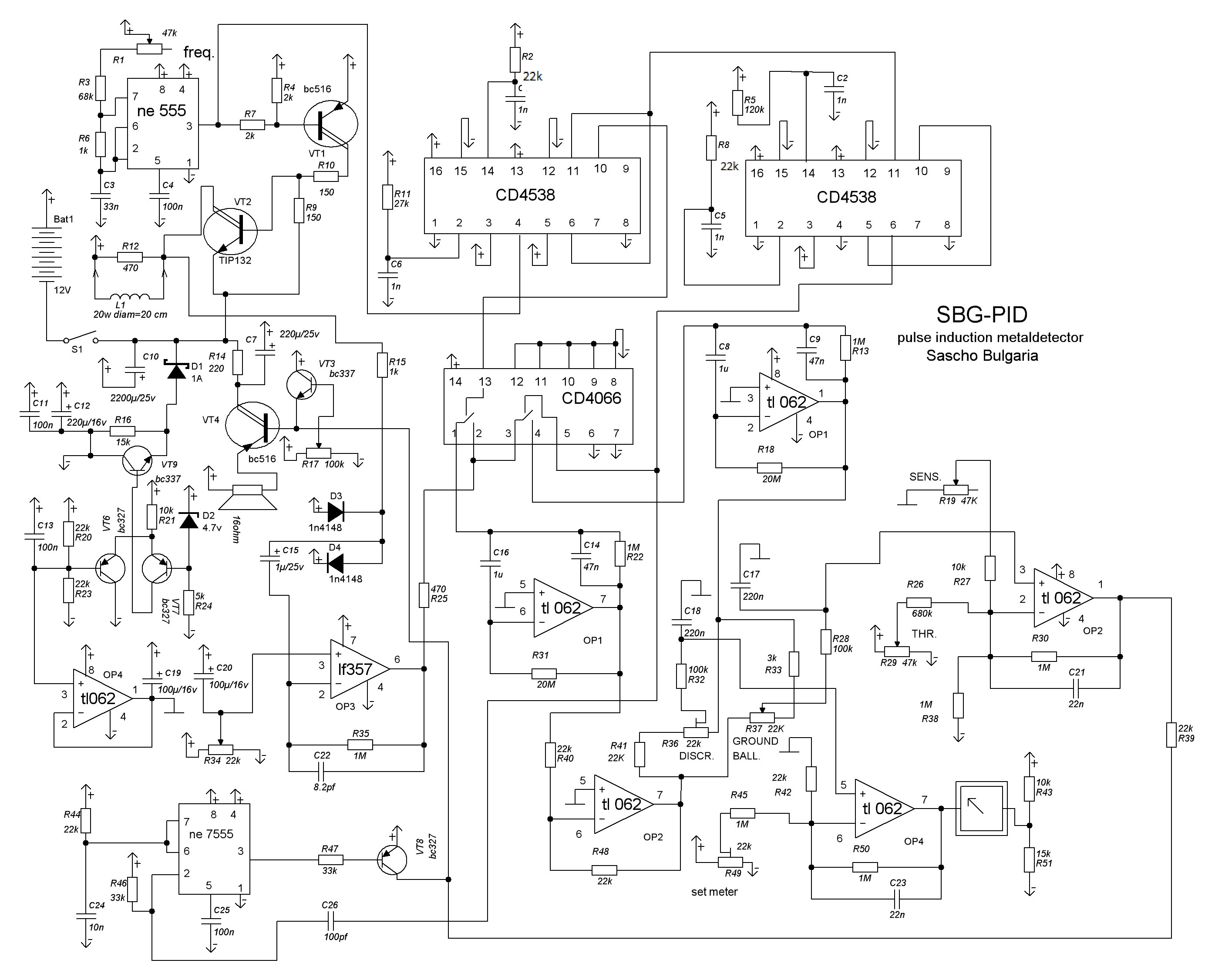

      Hi selim
      That is sbg_pid
      Sasho"s metal detector
          i started this in the past but never ended it, seems noone cares of this project

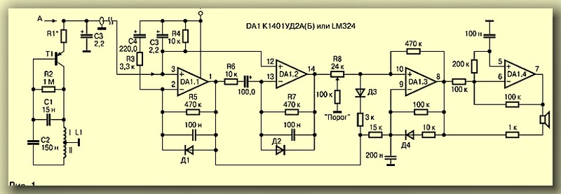

ID:	361996I also found a circuit that my friends need to solve.The original article called it a metal detector hand.But I only saw the schematics.
              This PCB schematicClick image for larger version
