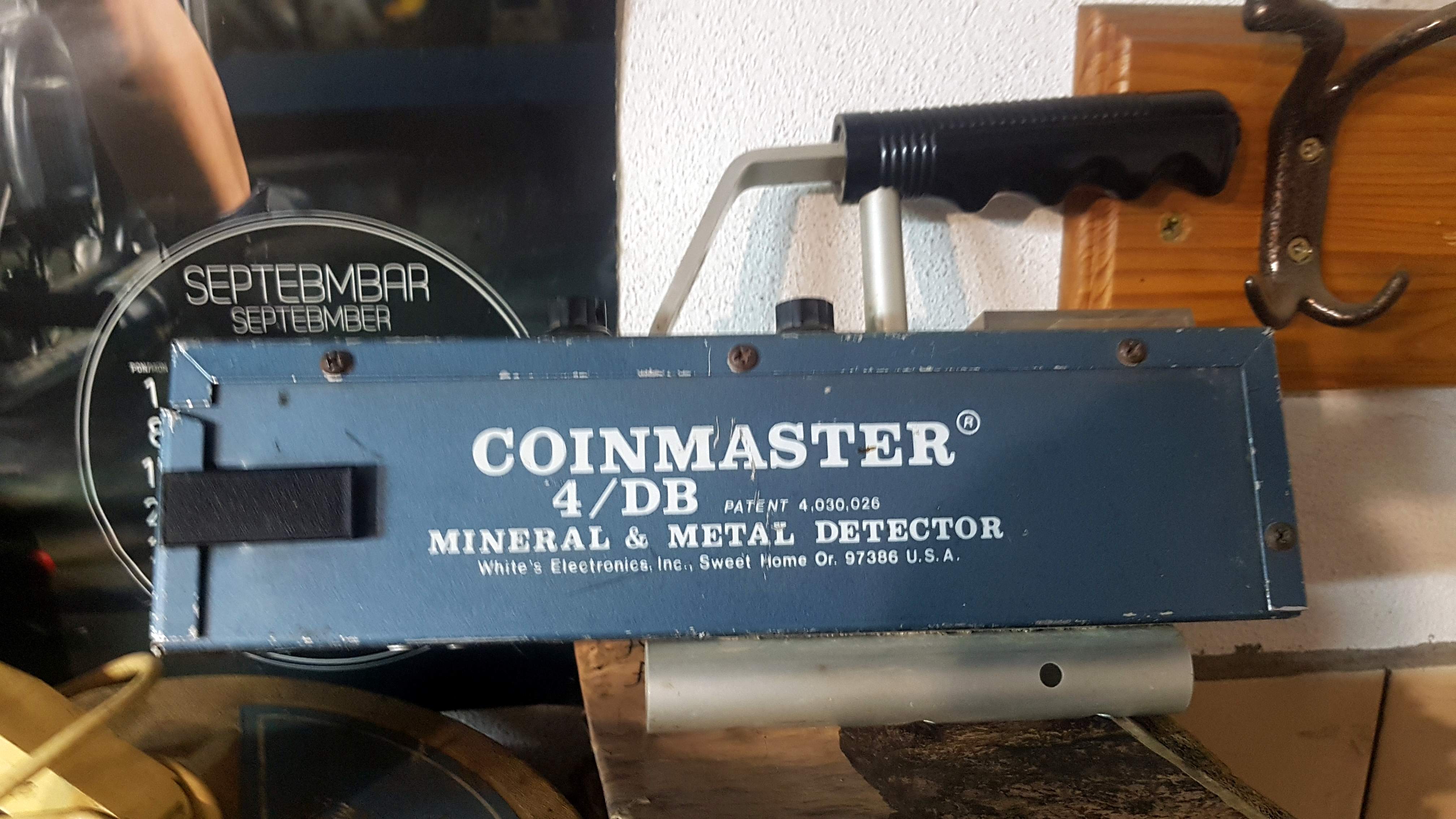

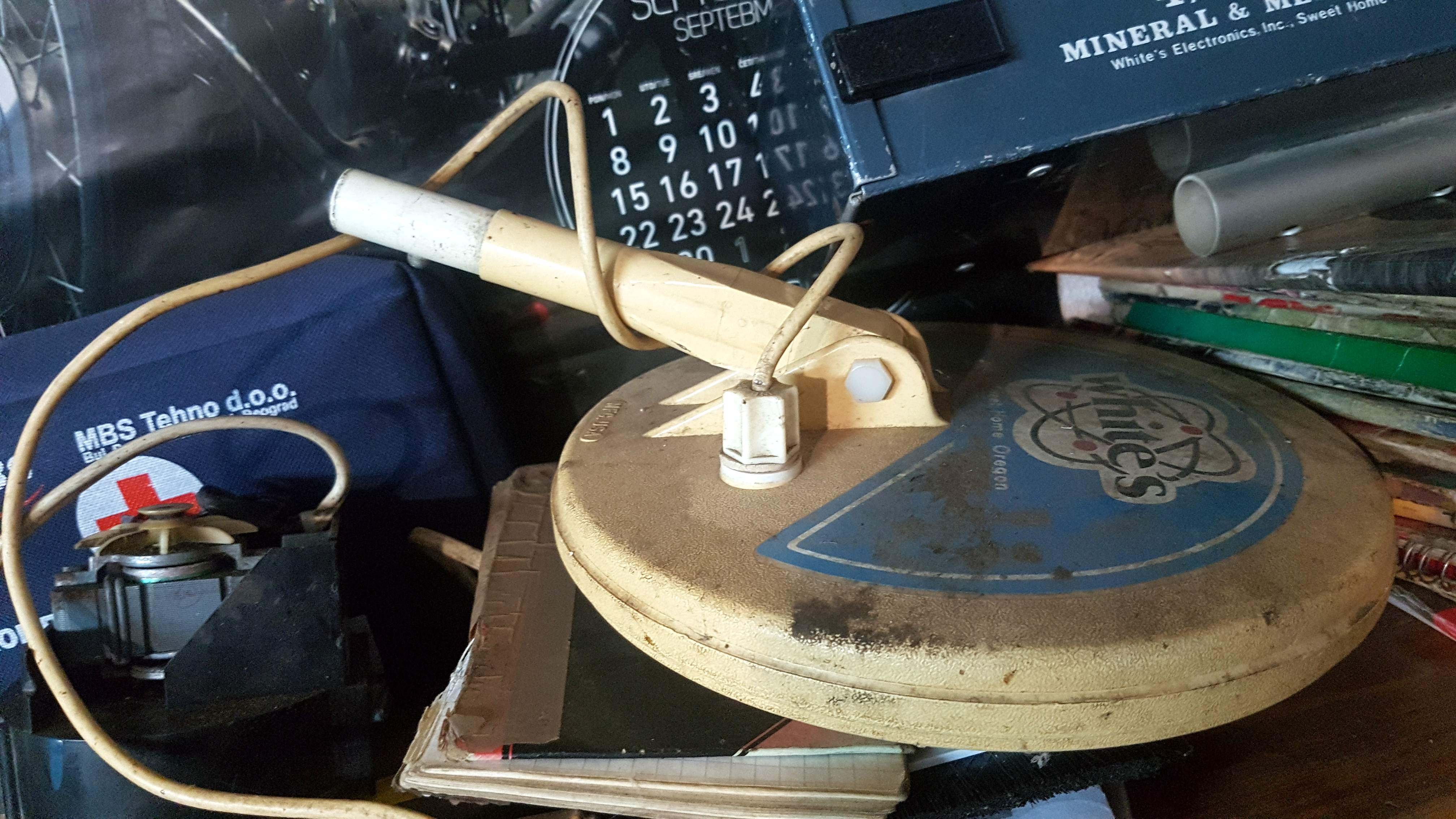

    An acquaintance from the area has a Coinmaster 4/DB (for God's sake, how many different Coinmasters are there???)
    and a B5 (or 5B) coil with a detector.
    Exactly what doesn't suit me... and I don't need it!

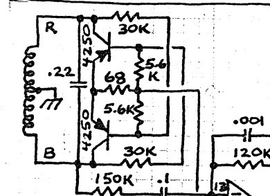

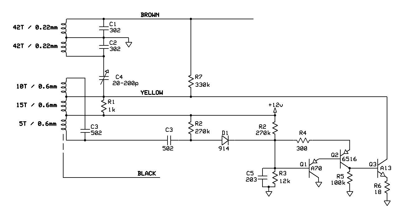

    But I noticed that the coil has the mark "B5" stamped on the left "ear".
    The same coil is used by the 6DB and 6000 models (!!!???)
    And here is the exact data for that B5 or 5B coil
    (which means nothing to me because I need a B4 or 4B for my Coinmaster, because
    the 4B and 5B coils are very different ... at least it seems so ...)

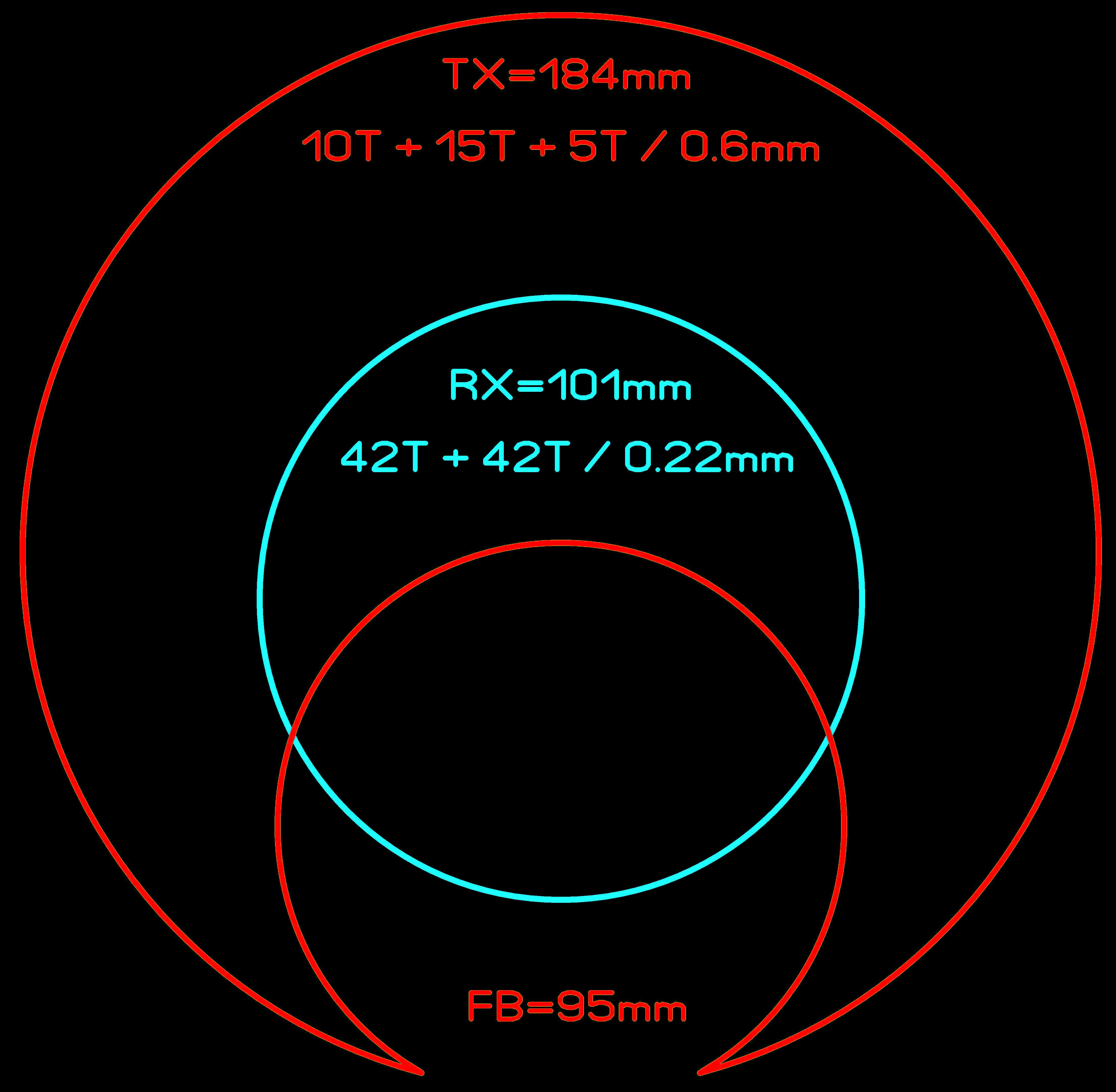

              • Hi ,ivconic can you measure from the original CM5000 coil on the RX how many millihenries it is and what ohms it has? Thanks.
                • Useful info here as I've recently purchased two Beachcomber 5D detectors + spare main board which came with three 4B coils. Seems one detector works while the other boards don't. All coils seem fine though fitted with a mix of broken/perished 5 pin din () and 5 pin GX12(?) plugs.
                  • Beachcomber 4B connection.
                    Resistance :
                    Wh - Rd = 1.06
                    Wh - Bk = 2.04
                    Rd - Bk = 3.08
                    GN - scrn = 5.5, L = 470uH

                        • I will make your CM5000 board, but I want to try with DD 28 cm on the patent it shows that the RX has a 27NF capacitor, can you just connect 1 and 2 pin in place of the TX and measure what frequency it has, that way I will be able to calculate the same way, how exactly will the inductance of RX be for DD 28 cm
