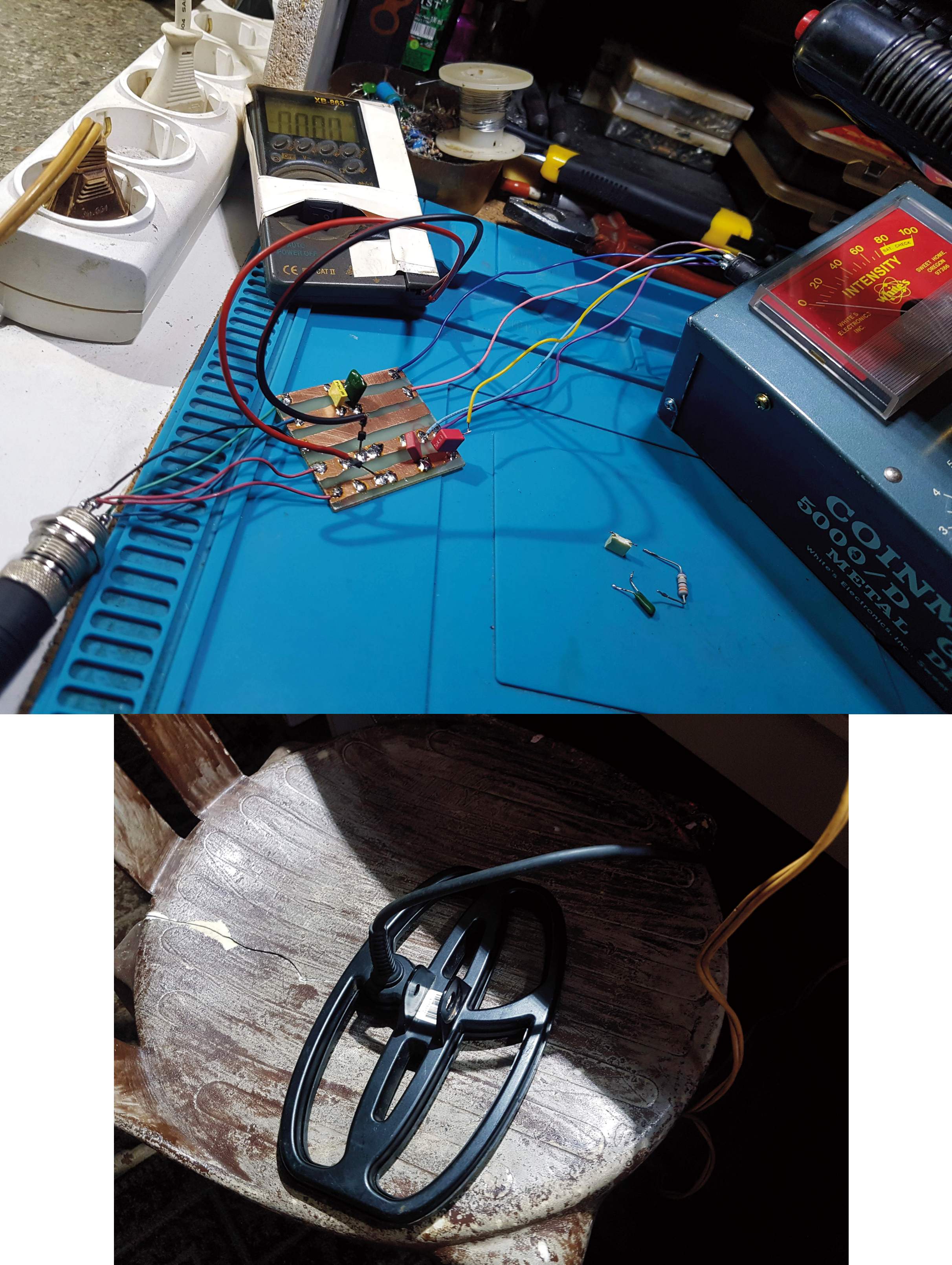

      So, I tried something out of the ordinary... to connect a Quest X5 coil to the CM5000!!!
      I calculated the capacitors for 5.13kHz.
      And I just tried, I tried both parallel LC and serial LC... adding resistances... connecting this way and that... and it won't work!
      The TX oscillator will not even oscillate.
      Similar to older Tesoro models; and here there is no sound until the TX oscillates. Although I also connected a frequency meter just in case.
      Nope! I didn't do anything! This looks like it's going to be a tough nut to crack!
      Because I don't want to open the coil again and risk ruining it. It was already open when it came to me.
      So I closed it, glued it with waterproof glue and on top of that with epoxy.
      Now "it's like new"!
      The "testing assembly":

      • Your post #101, PDF, clearly shows parallel TX LC tank.
        Since Quest X5 coil is having very low inductance for TX; 0.7mH... the logical conclusion is that the CM5K TX coil probably has a large inductance...
        Adding capacitance simply cannot compensate for such a large difference in inductances and the oscillator simply will not start.
        There are several ways to solve this (to make the CM5K work with the Quest coil)... (not planned for this original detector, but for an eventual diy in the future).
        One way is a pcb with a TX oscillator suitable for the Quest coil. And to "bridge" into the existing detector (a faster version for trials, but I don't like it).
        And another way is to draw a new pcb, CM5K, but with TX output for the Quest coil (it may be necessary to rework the RX front end as well).
        I have already mentioned on several occasions the reason why I insist on the Quest coil.
        There are several models, they go with various detectors, they work very well, they are "portable" for various projects.
        And here I have the CM5K which is extremely interesting for what I wanted to do (non motion). I really like how it works.
        But the main obstacle is its the "plague" of coil, which there is no way I will ever try to make.
        So it is very likely that there will be a certain "hybridization"... Now I'm just evaluating which way is easier to go...

            • OK; I tried various inductances on the TX. Tesoro coil, 5.8mH and 6.17mH... first connected one, tried, nothing, then connected the other,
              tried, nothing... then connected TX and RX and got 14.4mH, tried, nothing.
              Than I also tried 4.7mH. Nothing.
              In all the mentioned tests, I flatly added and subtracted capacities in parallel with the inductances. Nothing.
              This is already becoming intriguing and a little worrying!
              I'm out of ideas!

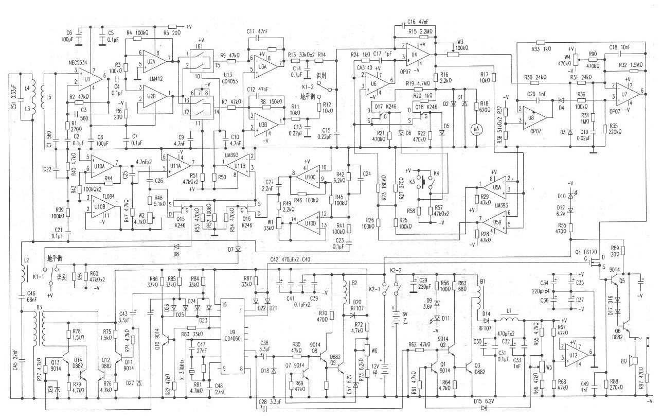

              • The schematic suggests the Tx coil is resonant, so it should work when a capacitor is put in parallel to resonate somewhere about the working frequency. I'd say it calls for a high inductance coil, as degeneration in Q11 emitter is 330 Ohm. Somewhere north of 5mH for sure.

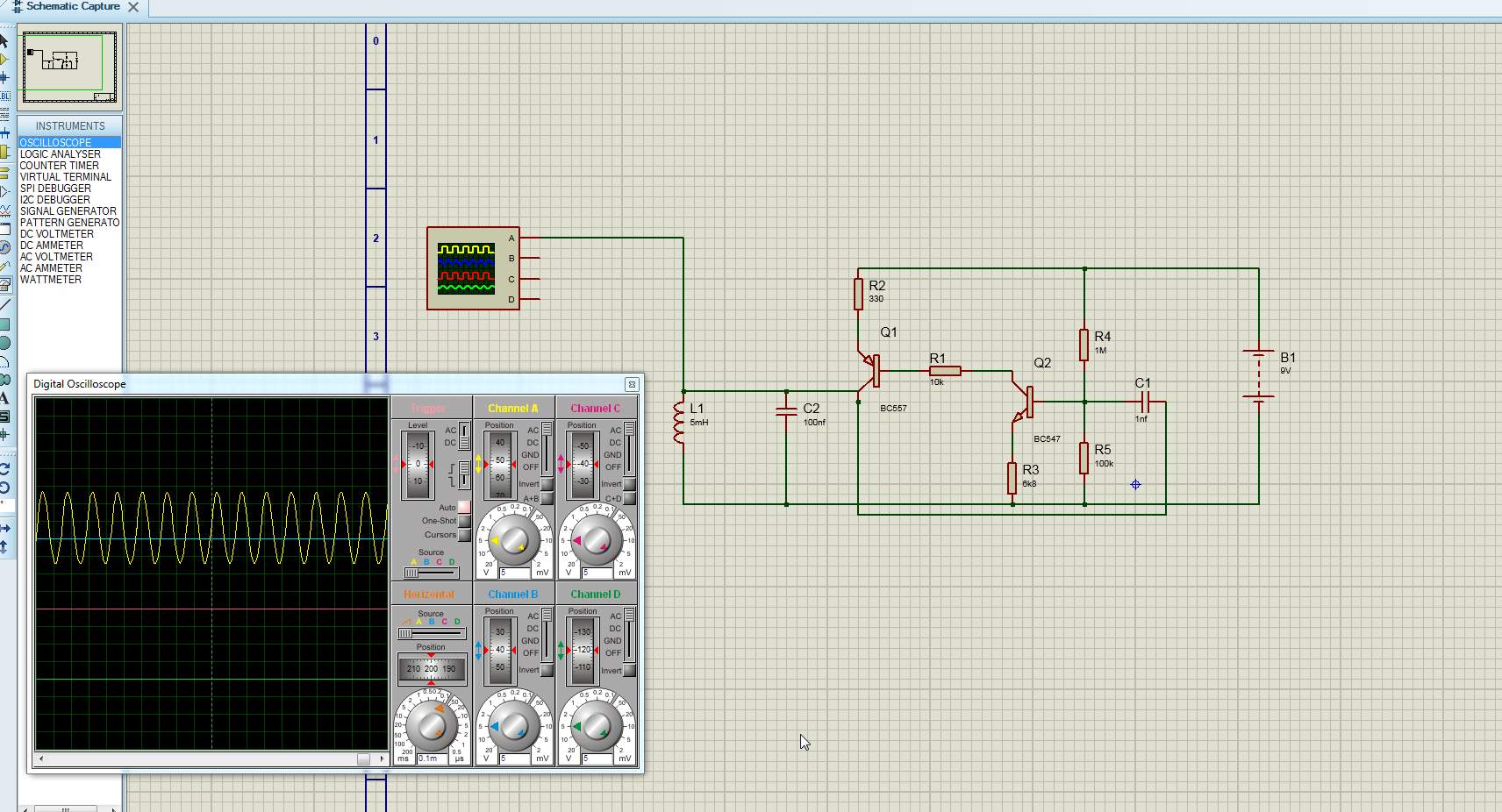

                  Now... I don't trust simulators.
                  Here is why:
                  • According to Proteus; TX is perfect and runs smoothly from a start!??

                      Simulated the circuit in LTSpice, and it oscillates with a wide range of inductance values. I tested with various values from 100uH to 100mH with no problems.
                      You must have something wrong somewhere.
                        Eh, I'm ashamed to say this publicly now; but i found out what the problem is!
                        I mixed up the TX wires coming from the connector to the detector!
                        I connected the TX "live" to the mass and the mass to the "live"... and that's why the TX remained "buried in ground"!
                        This happens to me often with connectors. I draw a pinout and then misinterpret it, like a reflection in a mirror.
                        Today I went detail by detail and discovered that error!
                        I've been "dying in pain" since yesterday, I had a sudden attack of a herniated disc yesterday, and I've been in pain since yesterday until this moment.
                        It probably also affected my attention.
                        So to back it up, Proteus is a great simulator and shows the real state.
                        I put the Tesoro coil back in and this time it works.
                        "Winning combination" is 34nF+146.8nF+5.18mH = 5.118kHz.
                        34nF is actually 33nF, 146.8 is 150nF and 5.18mH is a TX coil from Tesoro search head, all parallel.
                        To get exactly 5.118kHz, which is the closest to specified.
                        I probably could have adjusted more around the capacity and got 5.13kHz, never mind.
                        The detector works. On the RX side I didn't add anything from the capacitor, the detection is there,
                        but it doesn't have the "depth" like the original coil.
                        Tesoro coil is "wideband" but not that much. It covers 10-12kHz very well.
                        It is factory balanced for that range.
                        Then I tried the same method with the Quest coil.
                        The oscillator worked but there is no sound. Tried various combinations and finally gave up. That coil works at 13kHz, so it is factory balanced.
                        So... I feel like I'm still at the beginning. However, I'm still not sure what even the approximate inductance of the TX and RX coils are.
                        But let's say I could wind one DD coil and balance it at 5kHz. It would probably work acceptably.
                        But "acceptable" is not good enough!

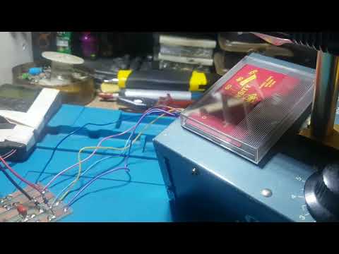

                        Uploading a video...

                        Ok, enough crying, sorry about this, I'm waiting for the video to upload to Youtube so I'll post it here...

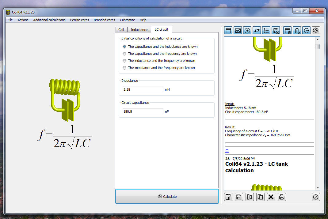

                          • Difference between theory and practice (not that bad actually):
                            P.S.
                            Sometimes is up to measuring equipment.
                            Sometimes the S/N affects all.
                            Bulky wires and hand etched pcb...
                            So far so good, practice confirms the theory.
