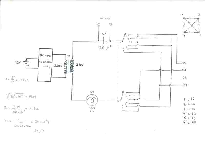

    Here is an Accumeter equivalent to GPL or MLL from Kellyco.

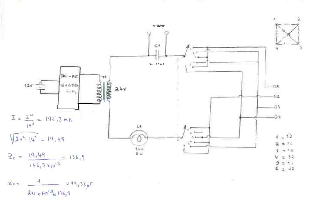

                Better picture
                Please find attached a better picture.
                Inform if possible of the results of your researches.
                  now...its much clearer and corrected values now...tnx claude..

                        hi, Klau
                        Pls tell me the operation and principle of this diagram, by the way what is the 1= 12, 2= 34, 3= 14 ect? Thank you for reply.
                              Hello klaud.
                              What is the range of the voltmeter being used here?
                              Is it 50volts? Or just 10volts? Thanks a lot.lplease do reply
