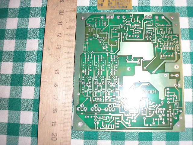

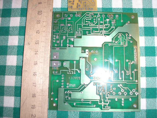

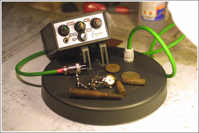

    what I would like to offer you, really, is to order PCB for GROZA-III (THUNDERBOLT-III). it is detector of Jurij Petric, you must know him, I frequently had did give the schematics from him here. GROZA is the full completed and ended device.
    Jurij is 48 years old, living in Kiev city, Ukrainia.
      KT315/GROZA-Thunderbolt-III

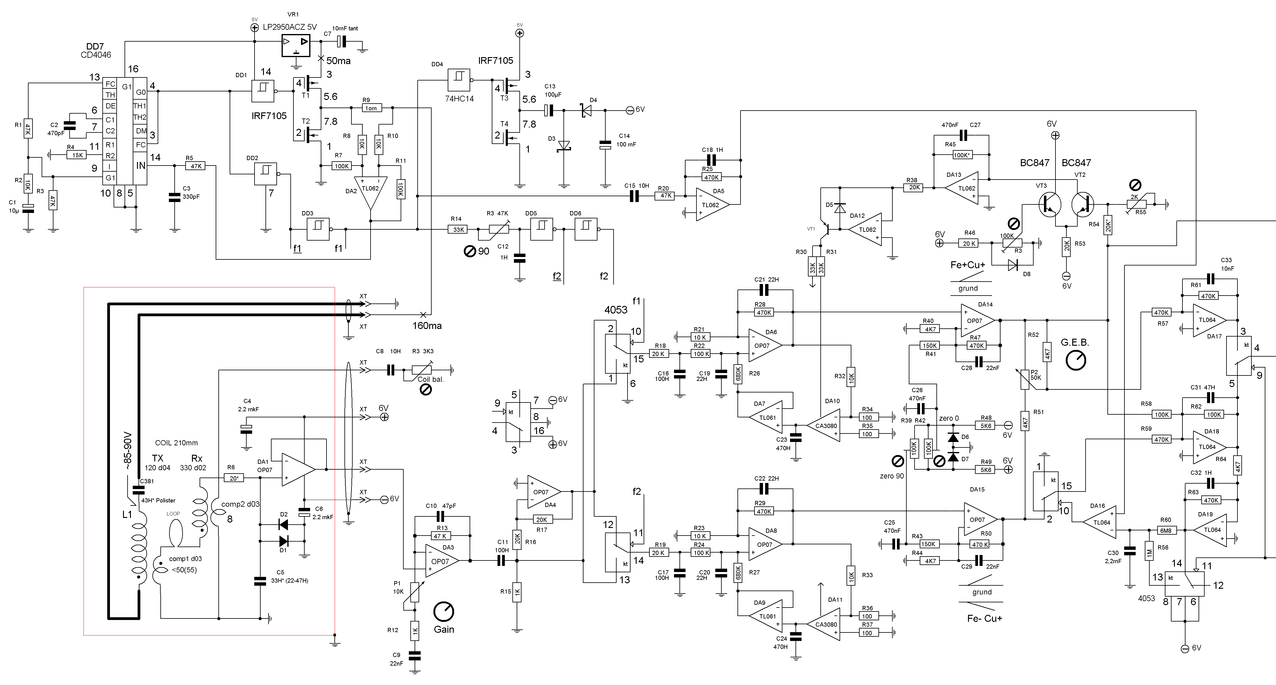

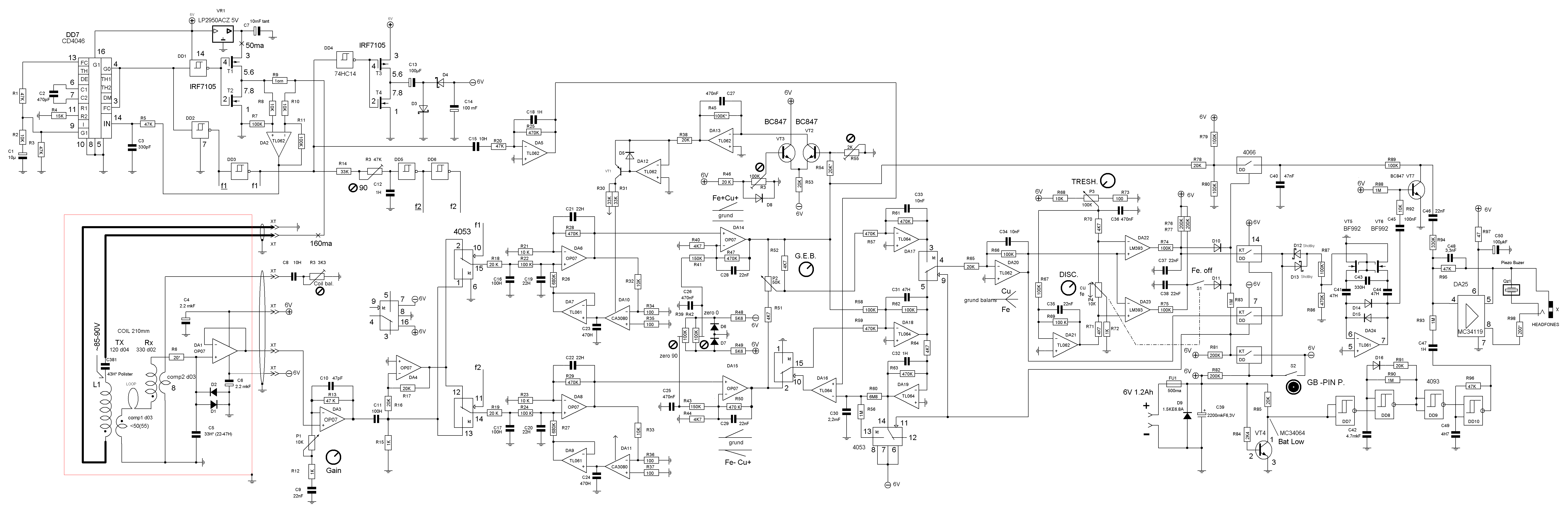

            you could HAVE seen his schematics, I did put ALL of them here. but I can repeat an old variation again for you.
              now splitted, by parts, as it got invisible.
                Thunder
                Tis is not Thunder. Its experimental schematic... (autor)
                  Jura, can you give us the schematic bad quality image, without resistors' valuis people could be judge about?

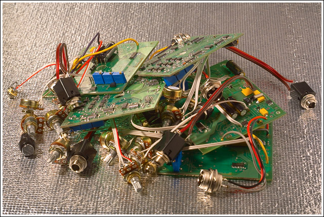

                            a bunch of THUNDERBOLT-III PCB's
                              PCB
