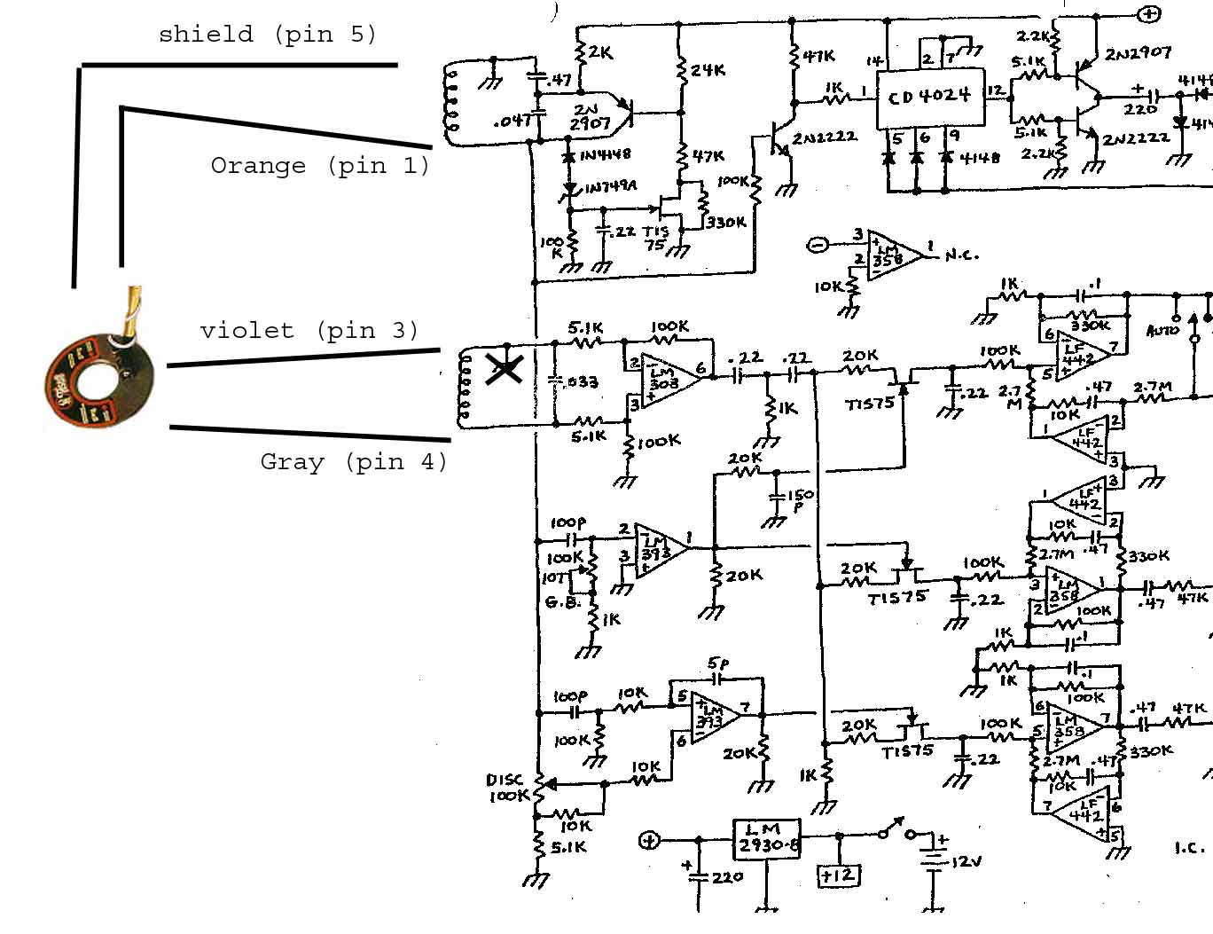

    I stumbled across a partial Tesoro schematic (see attachment). I'm intrigued. Has anyone got the complete version?

    This schematic is from a Tesoro Eldorado.
    Thanks for posting this, as it includes the coil wiring. I asked a question about this in the Coil Building forum, but no-one seemed to know the answer. According to this partial schematic, my conclusions were not quite correct, as I presumed the TX coil was connected to pins 1 and 3, and the RX coil was connected to 4 and 5. It's probably academic anyway, as the wires connected to pins 3 and 5 are shorted together in the search head.

      Hi Qiaozhi,
      Thanks for posting the schematic. The Eldorado looks like it utilises components less efficiently compared to other Tesoro schematics I've seen (e.g. Bandido). I'd guess it's an earlier design.
      The image I posted came from this forum, but I can't say when or by whom it was posted. I'm glad it was of help to you.
