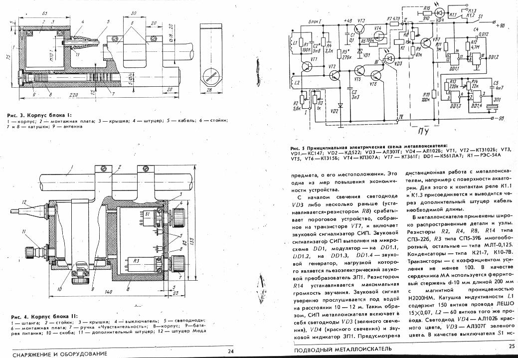

                Can someone please guide me, what is IC in this circuit, and is there a russian/english document for semiconductors and chips. Also what is part connected between pins 2 and 3
                  You can use this site: http://radio-hobby.org/modules/analog/
                  К561ЛА7 = CD4011
                  КД522 = 1N4148
                  КС147 = BZY83C4V7
                  АЛ307 = GREEN LED
                  КТ3102Б = BC546
                  КТ315 = 2N3397, 2SC388
                  КП307 = 2N5394
                  КТ361Г = 2N3905
                        ussr ref
                          Many thanks, now i try to make. Why is used relay here? To switch off VD4 LED?
                            from text. there is additional possibility to work on a distance..... for example from water surface... so
                            to those points attached a connector for a cable.
                              Thanks for explanation.
