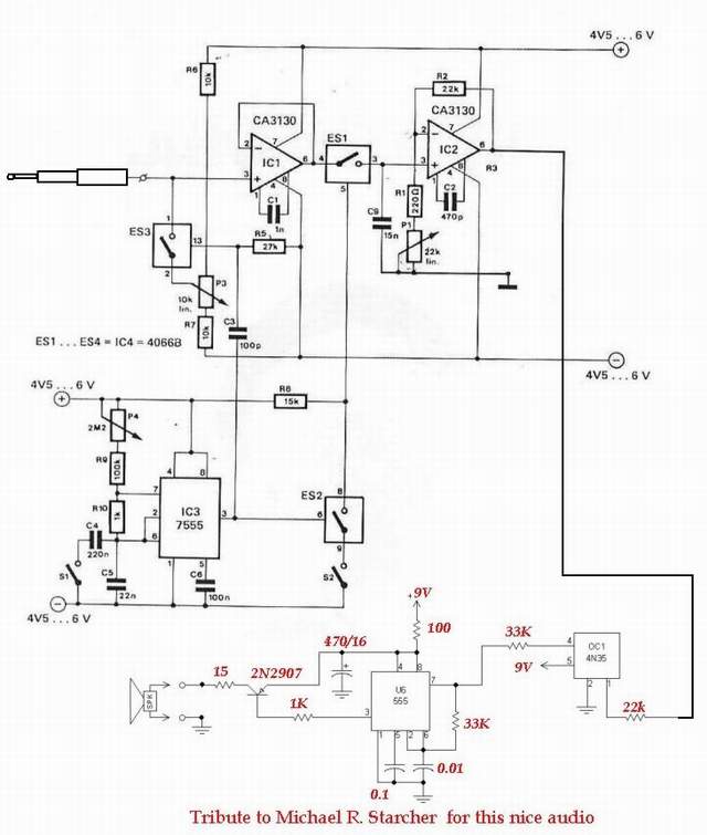

        One more thing:
        I am sorry, i absolute inadvertantly forgot to mention and also omited another, very
        important alteration to my hand-made device !
        "So this supposed to be only evasion from original schematic posted here."
        This is not true, but i changed this stage from the begining, later just forgot to
        mention here. Sorry again. Michael R. Starcher done a great job with this audio stage
        in his "Homebrew PI" project!
        I decided to use it with Zahori due to its great performances ! An it all worked nice
        togather, from start!
        Overall power consumption is so small, so one 9V battery could last a few days, i guess.
        Although Esteban's "/comparator/timer/tone generator " is also good! And simillar to this.
        It will take a much of testing on the field to establish right overview on those adjustments
        included in design.Right now i am adjusting potentiometers on wild guess,so presets might
        not be proper,therefore can not claim here anything for sure. We will see.

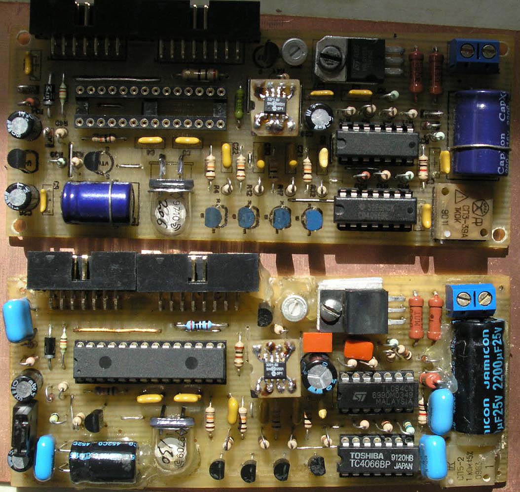

          dear Robert,
          please simply do not visit RU zone, as you get this trouble. the desicion is clear... I also do not visit China and Japan sites - there are nothing of on MD schematechniks .
          ... and I will continue to give some light despite on the attacks without facts exist. for our friendsm, which I know very much in the world I give links on our PI projects.
          ClonePI-M on the photo. code was updated to version 1.7.3 for PIC18F252.
          http://fandy.front.ru/ClonePI.htm
          for anybody who is not in course of our projects.
          Skif-PI. on ATTINY chip.
          http://sevzirfo.narod.ru/skif_pi.htm
          Skif PI-Autotune. on AT90S2313-10PI.
          http://sevzirfo.narod.ru/skif_auto.htm
          all the best
