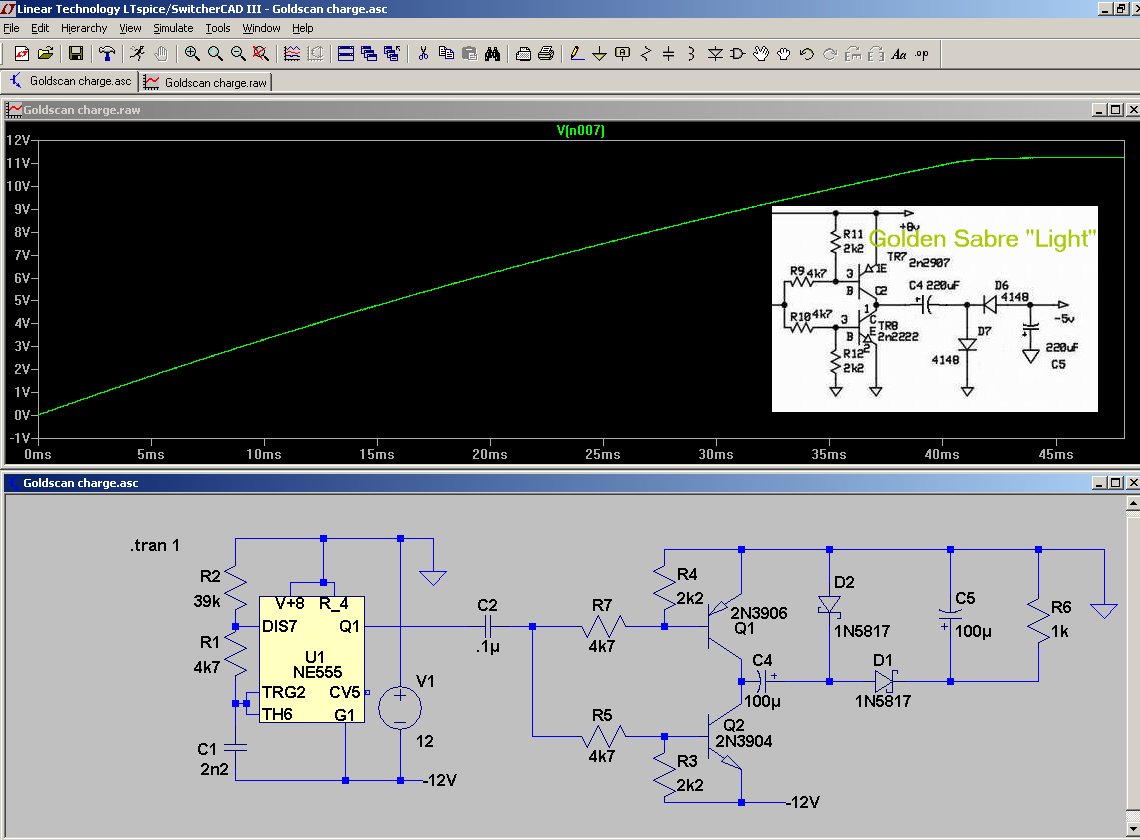

          Erolunall- I think there is a mistake in the +5V charge pump. You do not have a DC path for the base bias currents of transistors Q1 and Q2. Q2 requires an electron flow path from a negative source, and Q1 requires hole flow from a positive source. (Jeez, I can't believe I'm talking about electrons and holes).
          I simulated what you are showing using LTspice, and got only about +3V output. Look at Tesoro's Golden Sabre or Eldorado to see what I mean about a DC path. (Those are negative charge pumps with reversed diodes and capacitors, but the concept is the same.) Your C1 and C2 are blocking the necessary bias paths.
          Also, I think maybe one diode should be turned around at the input to NE5534?

                    That looks like a nice layout. You can probably place 4k7 resistors in the C1 and C2 slots and put a 1u capacitor in the R3 slot. You don't need a big capacitor there, but for some reason that I do not understand, a capacitor seems necessary. No need to change the hole pattern!

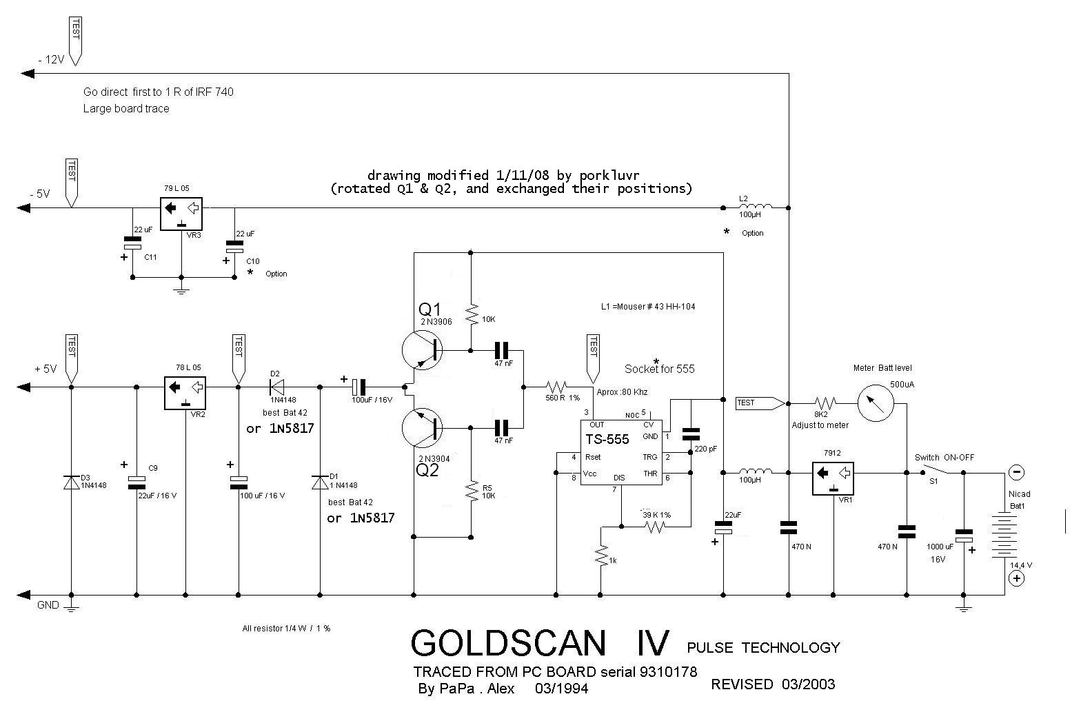

                        a better fix
                        Hello erolunall. I still think the schematic is wrong where the +5V supply charge pump is shown - but there is a much better way to fix it than what I showed before (#19 above).
                        Simply exchange the positions of Q1 and Q2 on the PCB, and turn them backwards so that their emitters are connected together at the negative side of C3. No other changes are necessary. This works better than my first circuit because it draws less current.
                        Q1 and Q2 simply got mixed up when the schematic was reverse engineered, because that would explain the discrepancy.
                        By the way, tell Vladimier "great job"!
                          mo better
                          The +5V charge pump will not work properly if constructed as shown in previous
                          drawings. Here, I have swapped T1 and T2, and rotated them which should be
                          more like the original circuit. T1 and T2 are renamed Q1 and Q2,
                          to coincide with Vladimier's PCB layout supplied by erol.
                          Just remember that if you use Vladimier's PCB from #18, his silkscreen shapes for Q1 and Q2 are drawn reversed.
                          The two emitters need to be connected to C3(-), not the collectors.
                          The way the circuit was drawn before gave no DC path for Q1 and Q2 bias currents.
                          I had this all ready to post about two hours ago but realized that my "repair"
                          was bad wrong, so I ain't throwing no stones. But I think this is a necessary correction!

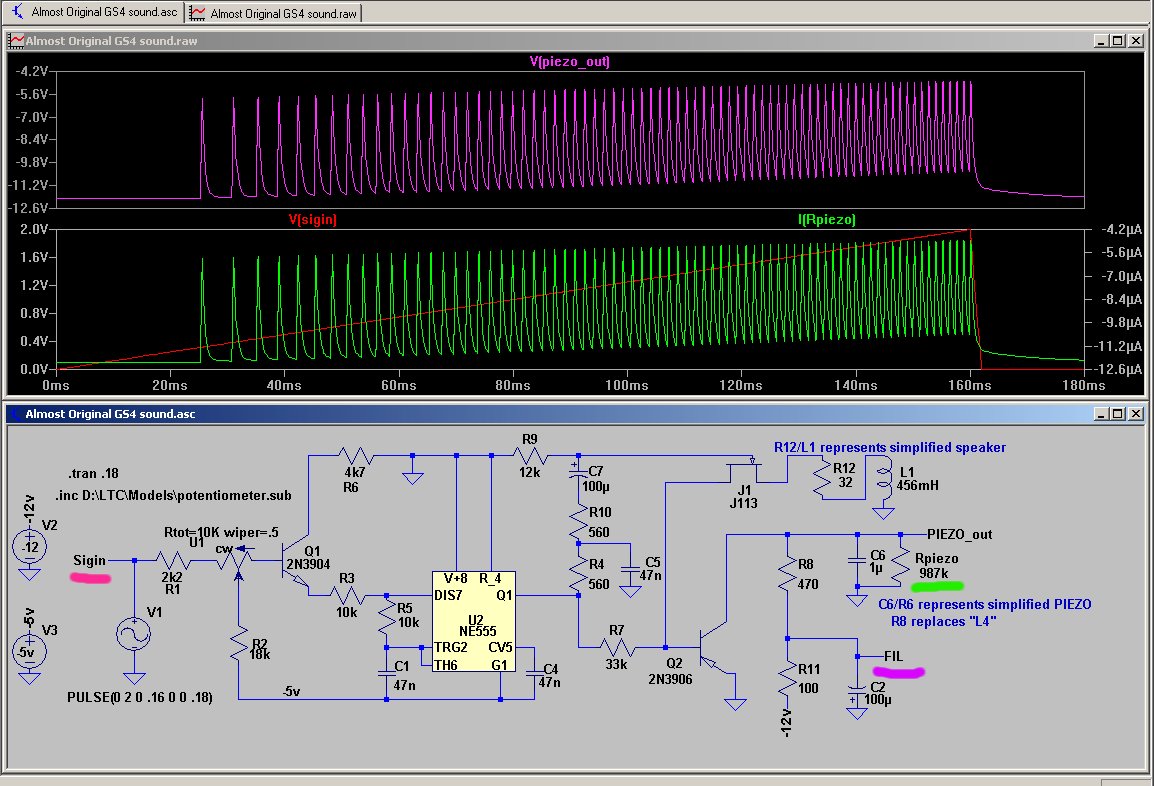

                            Inductor L4
                            What is this 470k inductor L4 in schematic? Doesn't sound inductor value..
                              Hello Lake -
                              You're probably referring to the speaker output choke. I think that could be a mistake.
                              I've run simulations with different value of inductors at L4 and substituting various value capacitors in place of "piezo". The circuit acts very badly every time. It rings and oscillates and I think it would be unusable. The picture I posted shows using a resistor, instead.
                              To keep things simple, a 470 ohm resistor could work there. You will have a slight sag in speaker supply voltage but that should not matter because the VCO rising pitch will be heard. You could have real trouble using an inductor/piezo combination.
                              I hope that helps.
