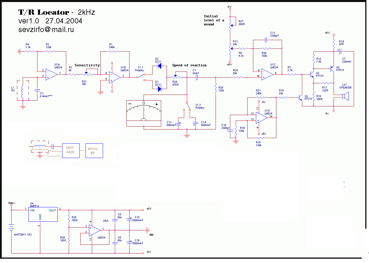

      Ok, I think I know where the confusion is!
      Yes, I used pcb draw from the magazine, resized it to real size and put it in Sprint Layout as background.
      Then I draw the pcb by tracing the background. You can put any picture as background in Sprint Layout and make real layout file like that.
      Then when all finished, I remove background, delete it from the Sprint Layout and only my drawings left as proper layout file.
      And then I can export such layout in several other formats, for example as .BMP, or .JPG... BUT ALSO I can EXPORT the layout in gerber format.
      In such case Sprint Layout is generating several gerber files, top copper layer, bottom copper layer, top silkscreen, bottom silkscreen, top solder mask, bottom solder mask ... etc
      So it is not direct conversion from ".png" to gerber.
      It is tedious job of drawing the same pcb again in some layout software.
      And them exporting it in gerber format.
      I think this is confusion and hopefully I cleared it up now?
      • #63
        Ok, the mistake was that I opened the file and was trying to upload extracted files, the proper way is downloaded file in zip format upload to JLCPCB.

          • #65
            Post #51.
            Modified circuit = going to do it
            .Click image for larger version
