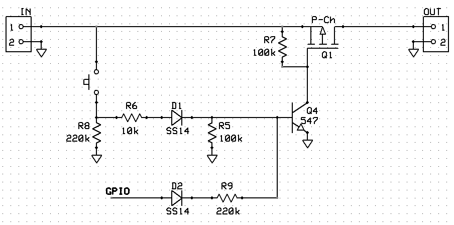

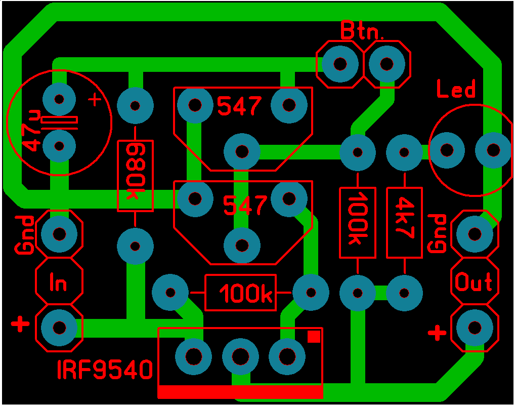

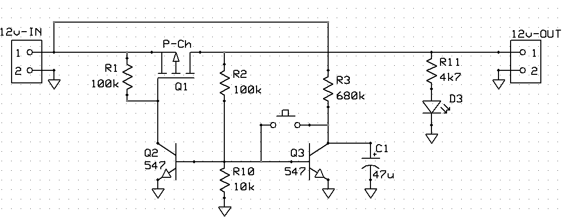

    I need an electronic circuit to turn my detectors on and off with a single button and that uses a MOSFET as a switch.
    Is this something you want to add to an existing detector, or something you want to add to designs you are working on? A better way to ask is, do you already have a micro that you are writing code for?
      Click image for larger version  Name:	image.png Views:	0 Size:	10.8 KB ID:	418381
      Click image for larger version  Name:	image.png Views:	0 Size:	30.7 KB ID:	418382​​​
          Both circuits are subject for further improving.
            Dear friend Ivconic I want to put this circuit in the detectors clone avr, chance pi, quasar avr, all working well. And possible​
              Yes it is.
                thank you
